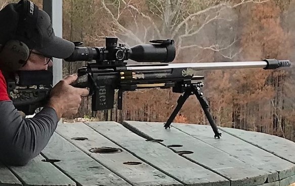

Yeah you should be trying to have your head straight up and down and not tilted. 1.1" should be plenty high. Below is a pic of 1.125" height mount. I'm looking straight through my glasses where my prescription is perfect and straight through the scope. Try to reposition your head and adjust your comb height to get you more squared up to the scope. It's tough to help too much through the computer unfortunately.
I just tried it in my garage and it seems my lop might be too long and my scope set up too far forward, I'm pushing my neck out too far I think. Going to make some adjustments and see how it goes.
Thanks for the info, this could make a huge difference. I would often struggle looking through the scope (eyebox) causing me to keep buying more expensive glass...lol. Just ordered a T6xi and Rzr gen 3... oh well
Reactions: Rob01
Glad it helped some and yeah getting everything set up right so that when you lay your head on the stock you are looking straight through and not fighting it. Move some stuff around and hopefully it helps. Just moving the scope back might be all you need to do.
Also, try...once in position on the gun...to turn your nose a bit into the comb (that is, rotate your head a bit to the right if you are right handed, for example). You should be able to feel your eye tooth against the comb. This will bring your on-eye in toward the center line of the rifle/scope.
