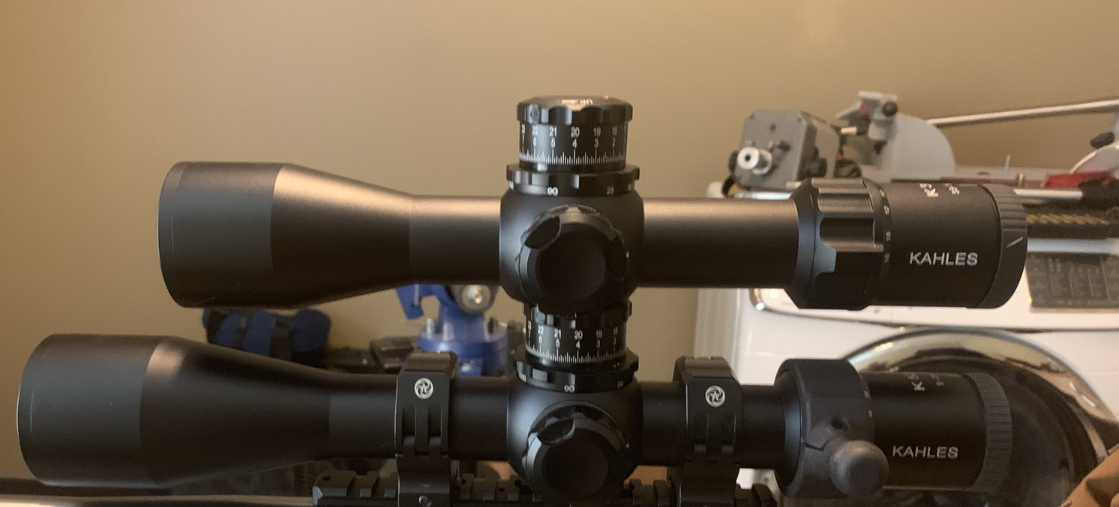

IMO, the kahles is the best all around ultra short out there currently. It’s quite a bit shorter than most anything out there.
The zcomp 4-20 is likely going to be a huge player in ultra shorts if it’s as good as the initial reviews in the 5-27.
If you’re interested in a kahles, I’m selling a brand new one to fund a zcomp 527.
Here’s a pic to give you an idea how short the kahles is.
Reactions: trollbadboy
I haven’t used the TT 3-15. Mainly as I prefer other reticles than they offer.
I have used the Schmidt’s and the Kahles.
Here’s a pic to give you an idea how short the kahles is. View attachment 7007130

Schmidt glass is a bit better. Though when talking this tier of optics, they all have good glass.
Schmidt turrets lock, kahles doesn’t. Never had issue with kahles turrets moving though
Kahles has ambidextrous parallax
Schmidt has the illumination tumor on side
If you like Horus reticles, Schmidt offers those. Kahles only offers a few reticles. The skmr3 is awesome though.
If you prefer Horus or locking turrets, go Schmidt.
Something like skmr3 or the length of optic matters, go kahles.
