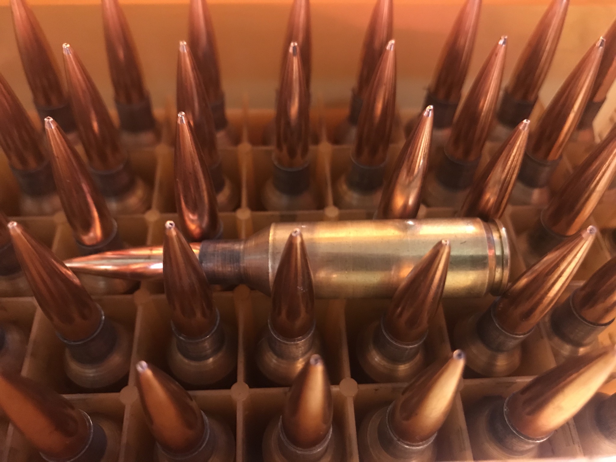

    Probably all but maybe the 195EOL 7mm bullets run well in short mags.
    168 classic hunters are on the lands at approximately 2.83 oal in my standard 7 saum chamber.
