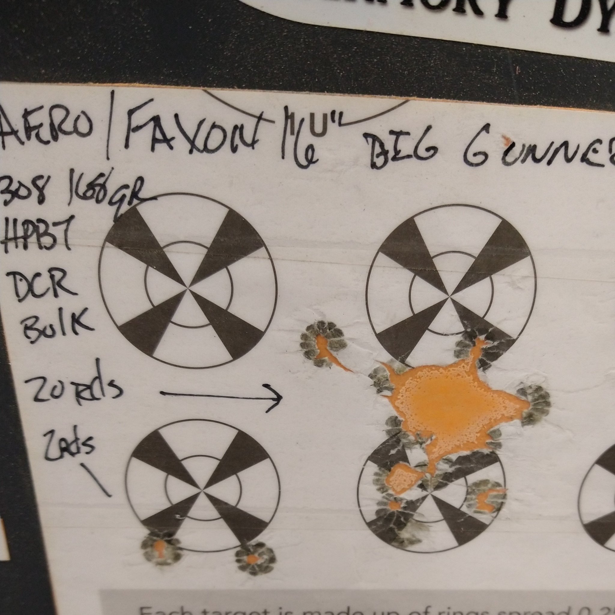

I have a Faxon 308 big gunner barrel that shoots a full 20rd mag into a 2" group using a Wraith digital night vision and local brewed reloads. I recently replaced the 2 stage trigger with a 2.5lb CMC trigger. I have been meaning to pull off the Wraith and put a Leica up top to see what this barrel is really capable of with the same ammo and then work up a load for it. I didn't built this rifle for precision, I just wanted a lighter night rifle for pigs and yotes at the farm.
