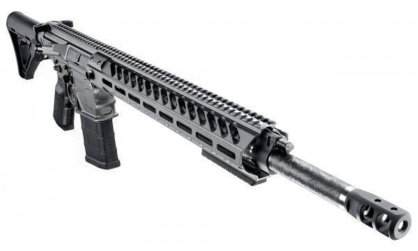

I’m looking to buy a lightweight factory AR-10 in 6.5 CM and was considering either the 2A XLR-20 ir a Christensen Arms CA-10. Anyone have a recommendation for either? Are there other choices I’m missing? Budget is $3k. Thanks!
Any reason why you aren't willing to build or have one built for you by ADCO or an LGS? You can go lighter with the 2a Armament receivers and other lightweight parts but still very accurate and low recoil with a Proof barrel and Superlative Arms AGB.

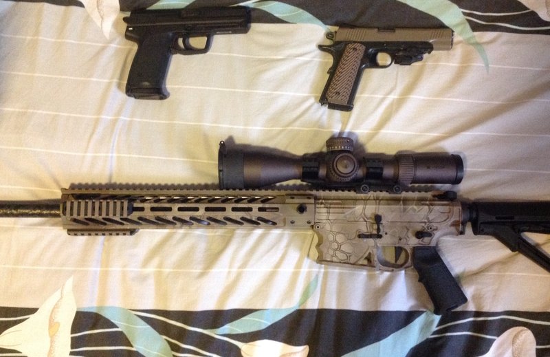

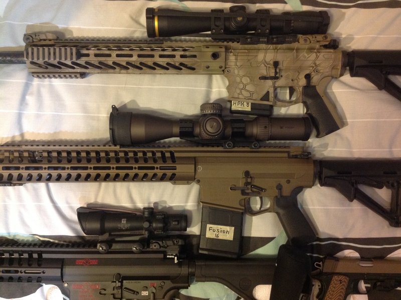

Light weight ? But the parts and accessories hard to find light weight !
I have vortex HD scope nice but too heavy 3 lbs + mount !
So I go for Leupold VX6 3-18x44 scope
