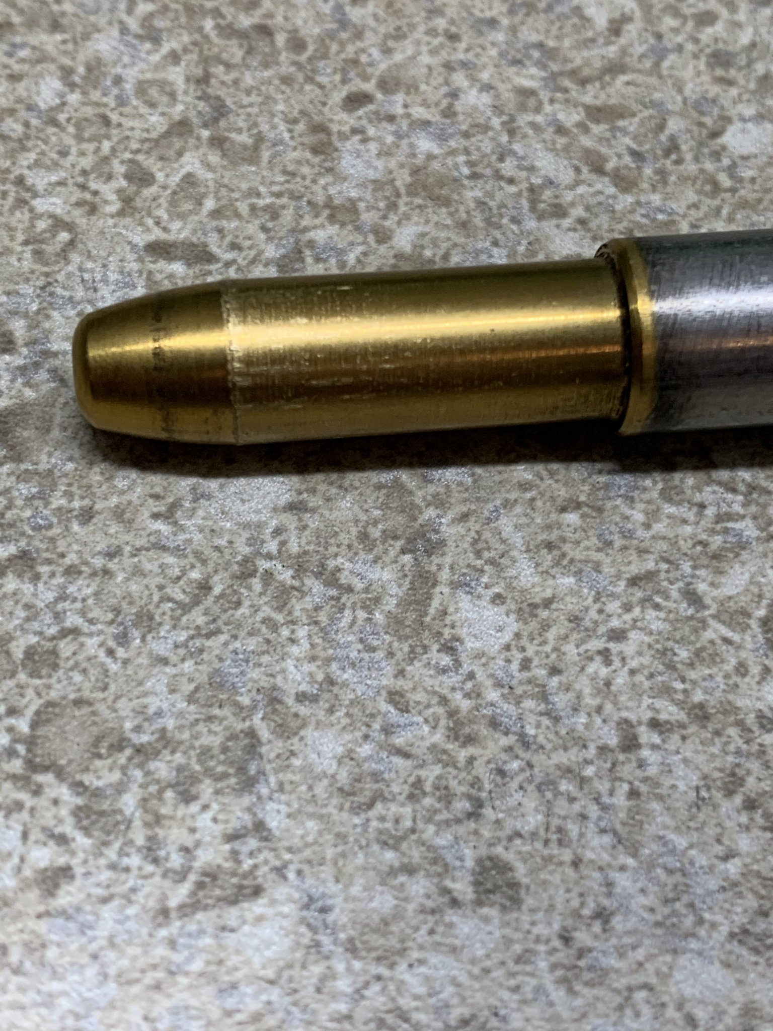

I have the 21st century TiN that I use for my 30-06 (.306) hunting loads and it is showing signs it requires more generous inside neck lube. It works great just an observation.
Really interesting and first Ive heard of this. This 21st Century TiN turning mandrel has over 50K+ on it. Probably closer to 75k no lube. Just whatever gets in the necks when spraying with linolin before running on my 223 processing toolhead on my XL650. Looks good as new and works flawless. I use it on my Lapua 223 brass on my 550 when sizing brass for my bolt guns as well. No lube.
A lot of wear right at the transition to .306. Totally my fault. Opening 100 virgin Lapua brass with no lube. Works fine just feels gritty during the expansion stroke.
View attachment 7234630A lot of wear right at the transition to .306. Totally my fault. Opening 100 virgin Lapua brass with no lube. Works fine just feels gritty during the expansion stroke.
I had that happen before. I'm 99% positive that's not wear in the TiN. That's brass on the mandrel. That should buff off. I had to do that once
