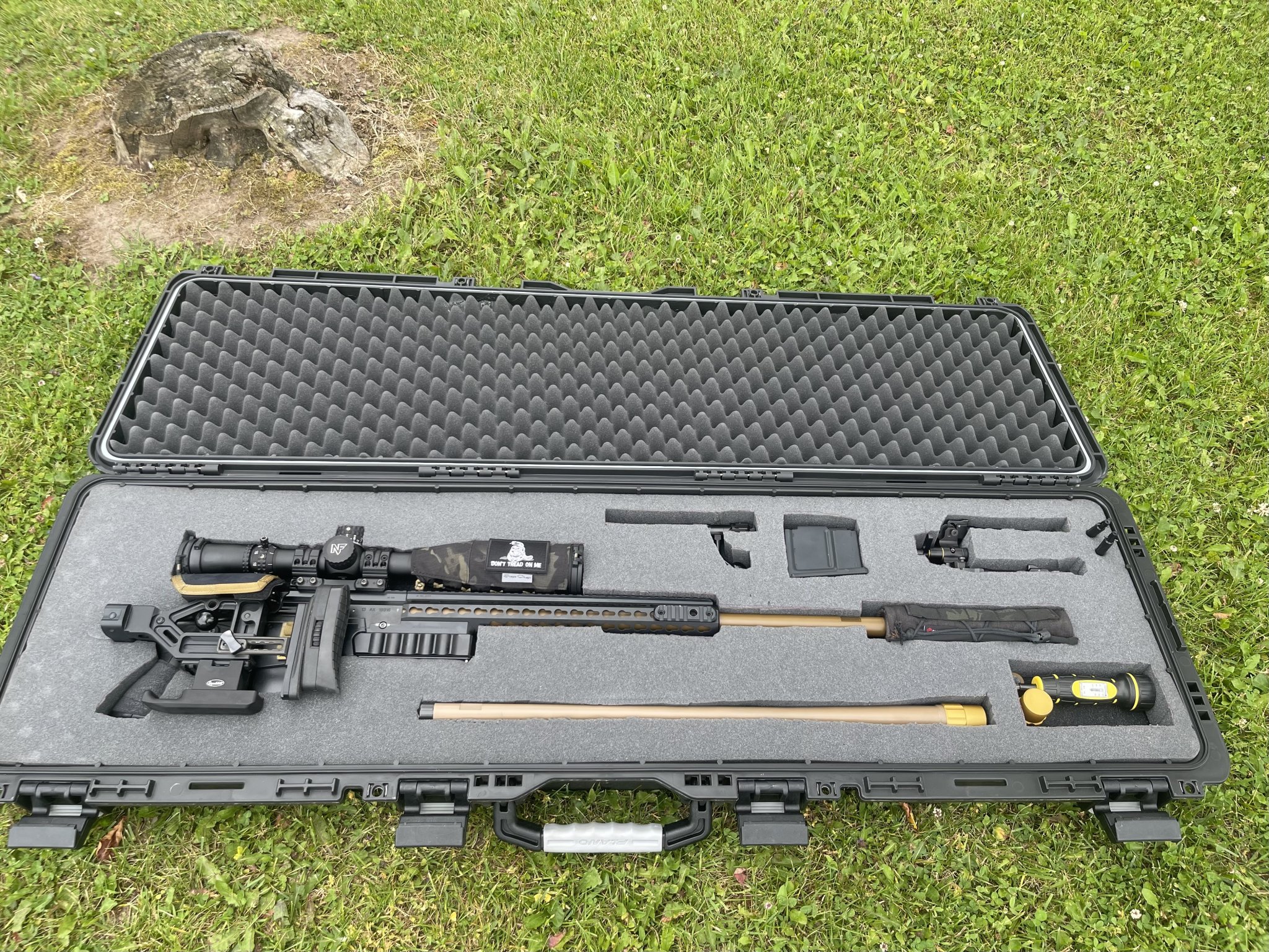

I have both Cadex Tremor 50 cal and AI AXSR with 308, 300PRC and 338LM bolt/barrels.
Both rifles exude quality and are both extremely well built - no complains there.
The Cadex chassis is heavier and thicker throughout, so it feels heftier and provides a more solid feel.
The AI's bolts run smoother and the AI Competition trigger is more solid and precise than the Cadex trigger.
The folder lockup for both rifles are the best in the industry, although the AI does lockup a bit more solid than the Cadex, if one were to nitpick.
For Multi-caliber, the Cadex Kraken requires customized tools for swapping barrels.
And when it comes to pre-fit barrels, there are a ton of options out there for AI. Can't say the same for Cadex barrels.
For additional Cadex Kraken barrels, you are limited to ordering from Cadex, or sending them to your gunsmith.
