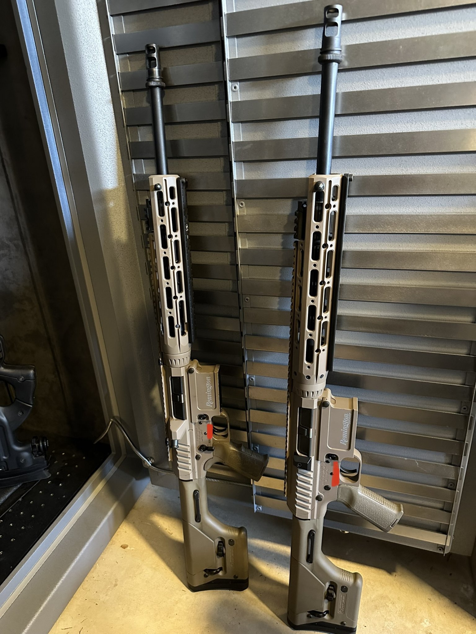

Which one of you is hoarding the Remingtons?
They are pretty cool….
Need to 3d scan these parts to finish up the other lowers. Mag and bolt releases were custom to the ERASR.

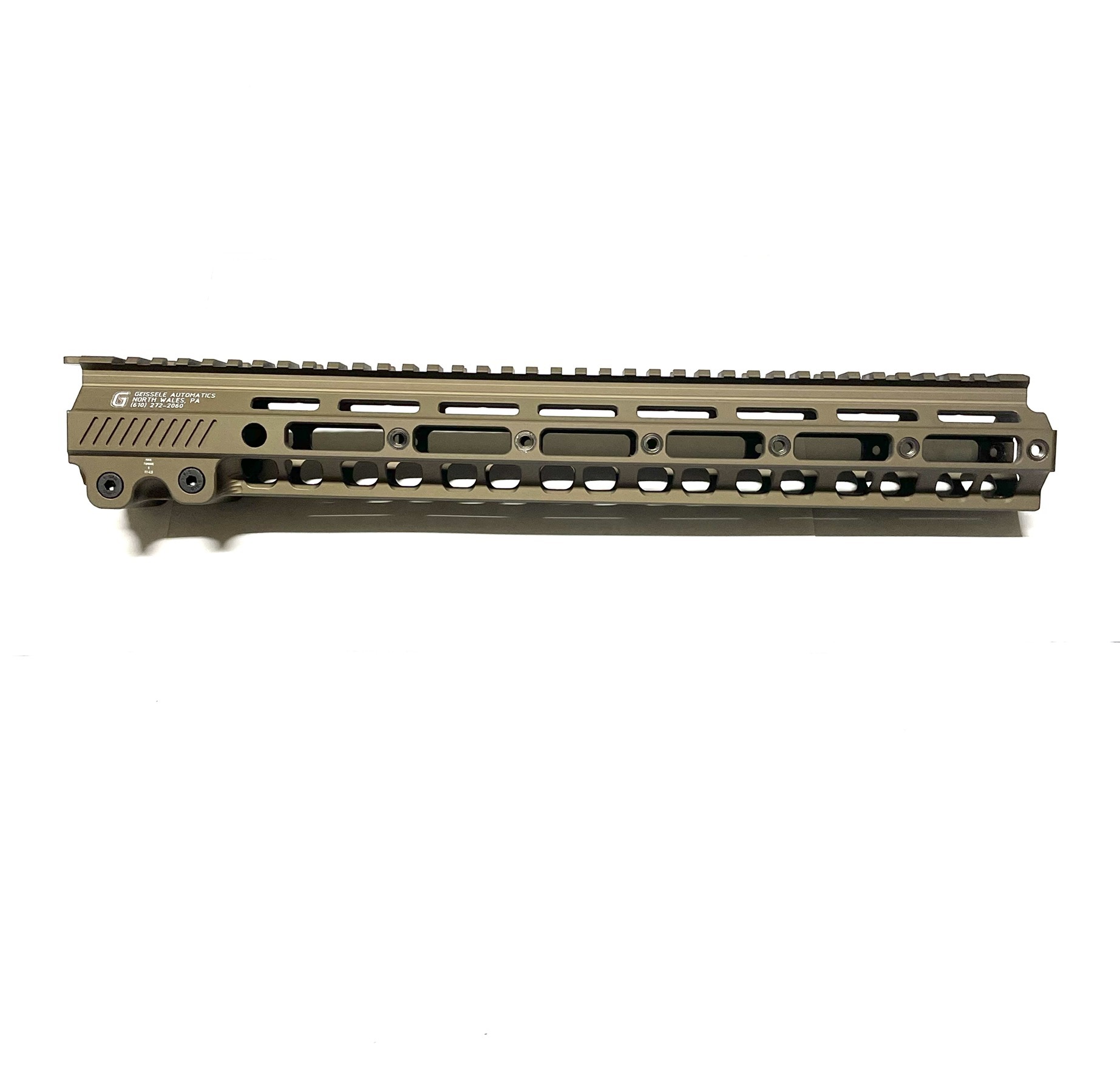

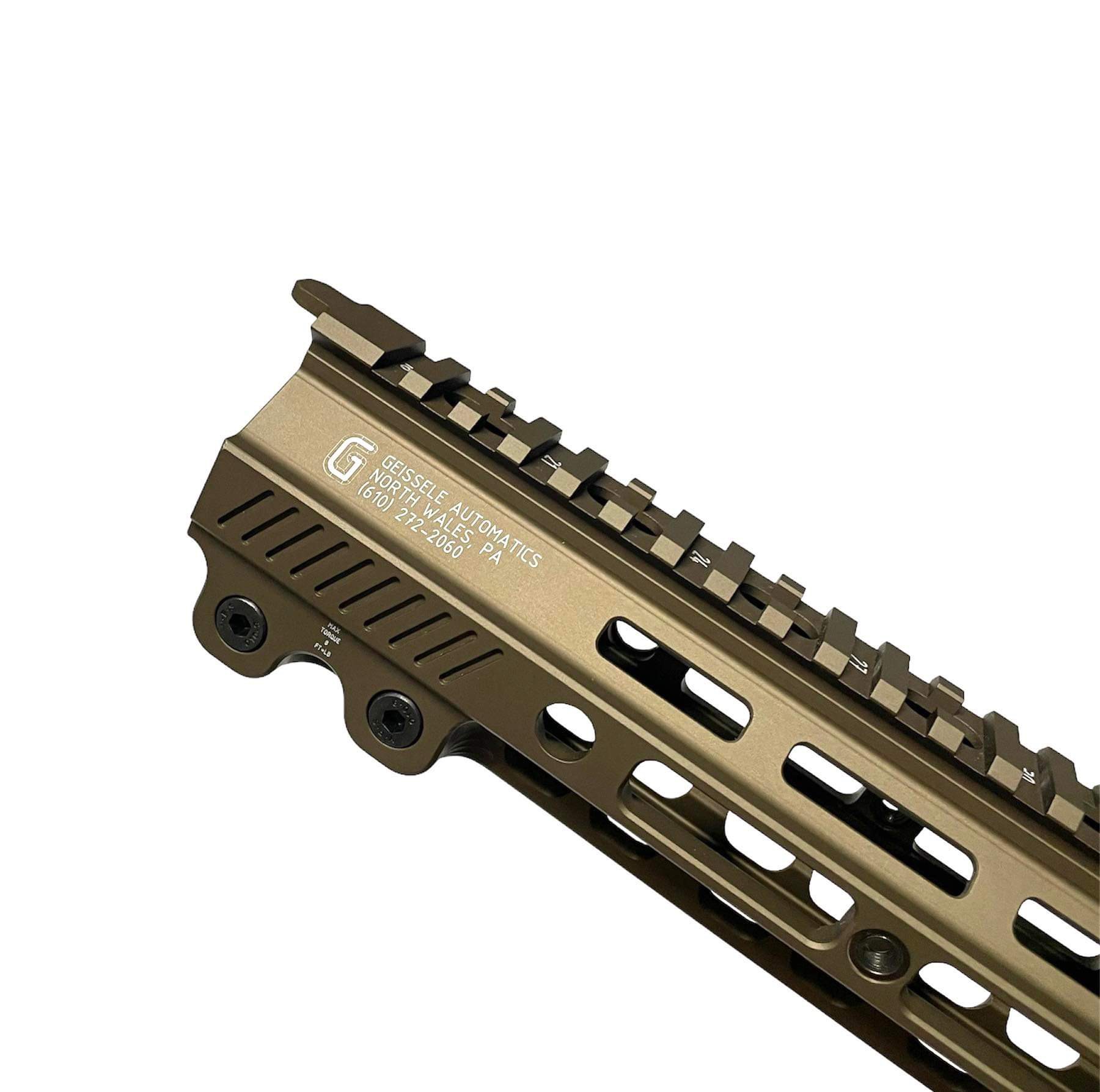

FYI I have an unreleased Geissele R-10 handguard if anyone is in need of one.
I might be interested! Could you post a pic? Curious to see what it looks like. Would be nice to get rid of the screw-on RAHG rail.

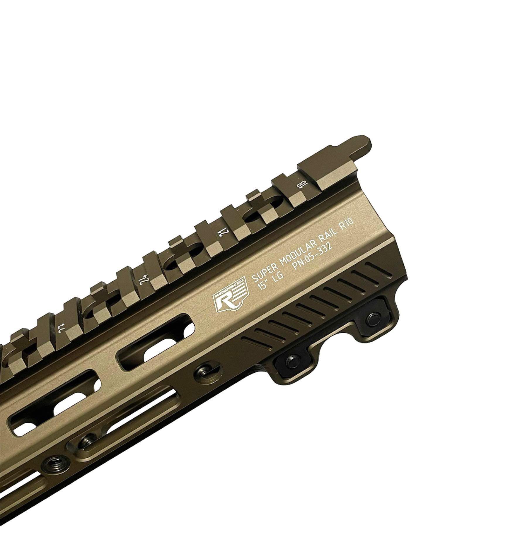

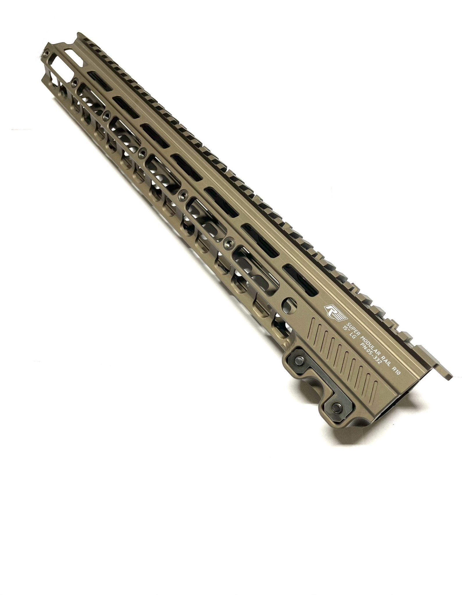

That handguard is long gone, but here are some pictures! Funny enough the kept the PEM serts lol, it was a bit lighter than the Remington handguard though.

Man that is awesome! Thank you for sharing those. Hate that I missed out on that. Very cool piece.
I’ve been trying to find a stray updated Remington rail since I got my R10. The updated model had a cutout for an adjustable gas block and utilized MLok slots.
Out of curiosity, how did you end up with that G rail?

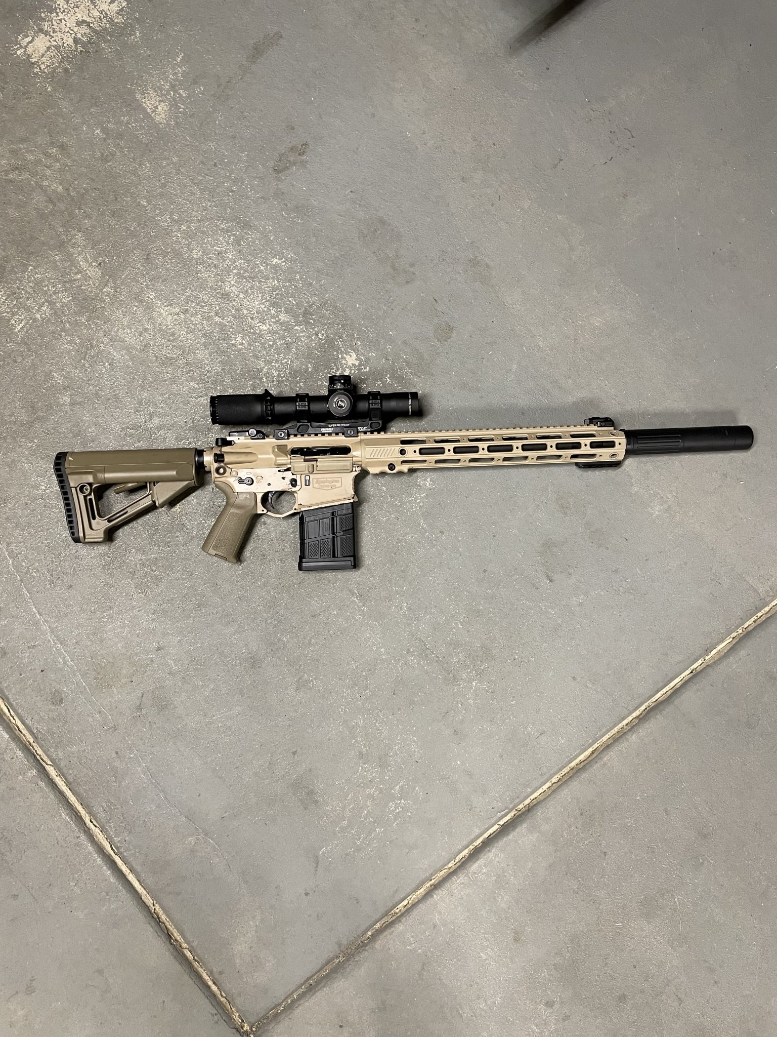

Bchico14 posted a photo of the R10 ERASR a DPMS G2+ (ambi-bolt release catch) rifle from Remington Defense. Remington had another more standard DPMS G2 (non-ambi-bolt catch) rifle called the R25 they sold to the public. Remington Defense as far as I can remember didn’t sell the R10 ERASR directly to the public until just before bankruptcy and nearly all of those are the Tunisia contract over run models. What Nolegs24 posted is a different rifle completely its the Remington RSASS (not DPMS GII) entry for the SASS competition developed jointly with JP Rifles.
