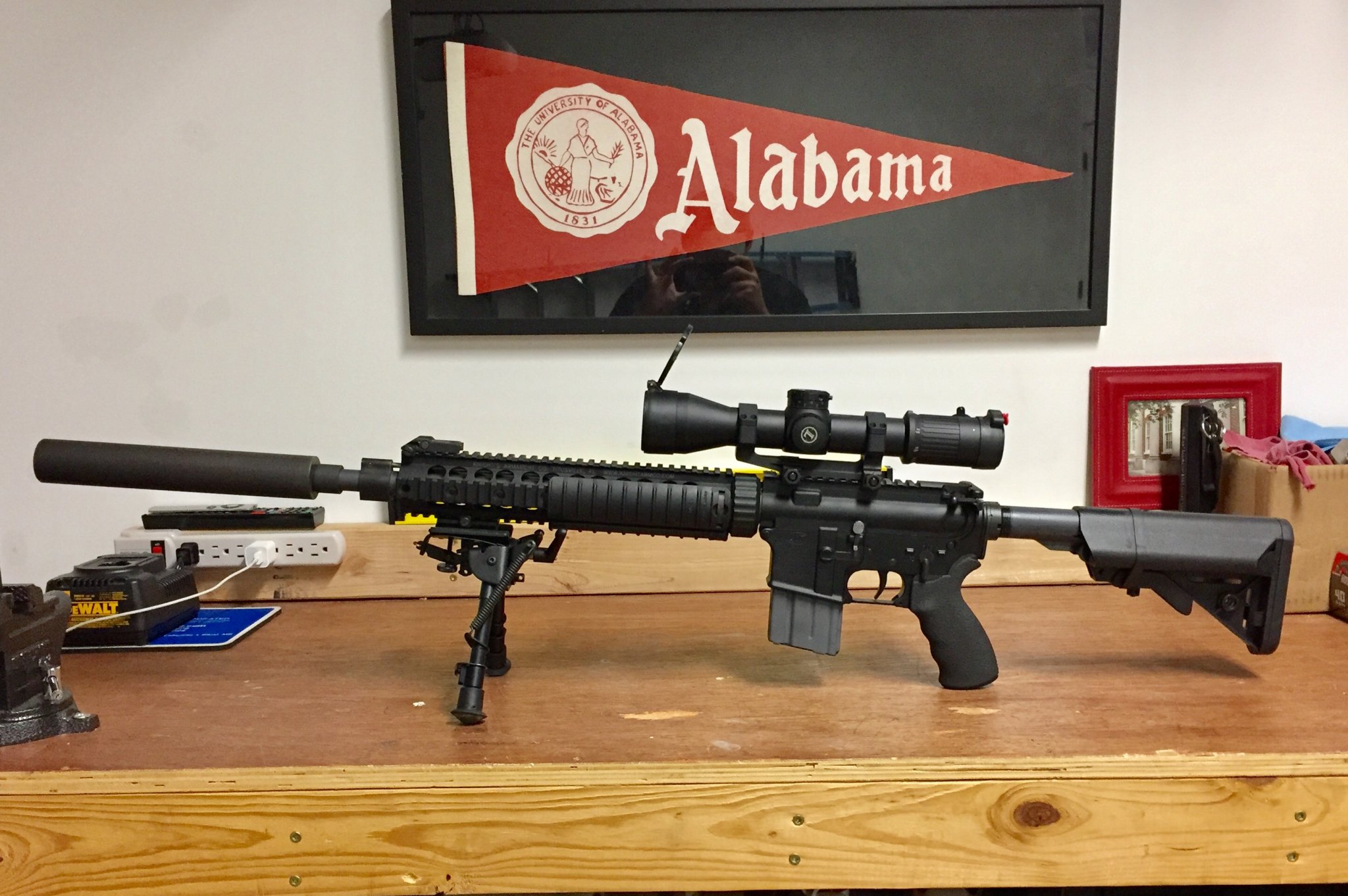

I’m not building an exact clone but really close. I cant decide on which optic. I am leaning towards a NF 2.5-10x42 or 3.5-15x50. Which reticle suits that rifle best? Also, I’m an MOA guy.

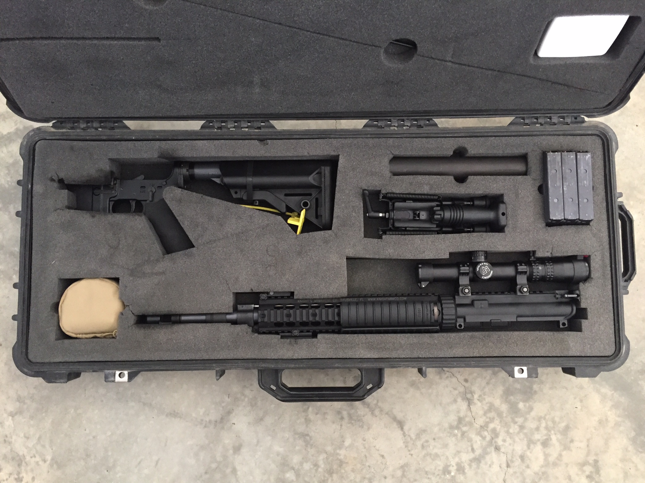

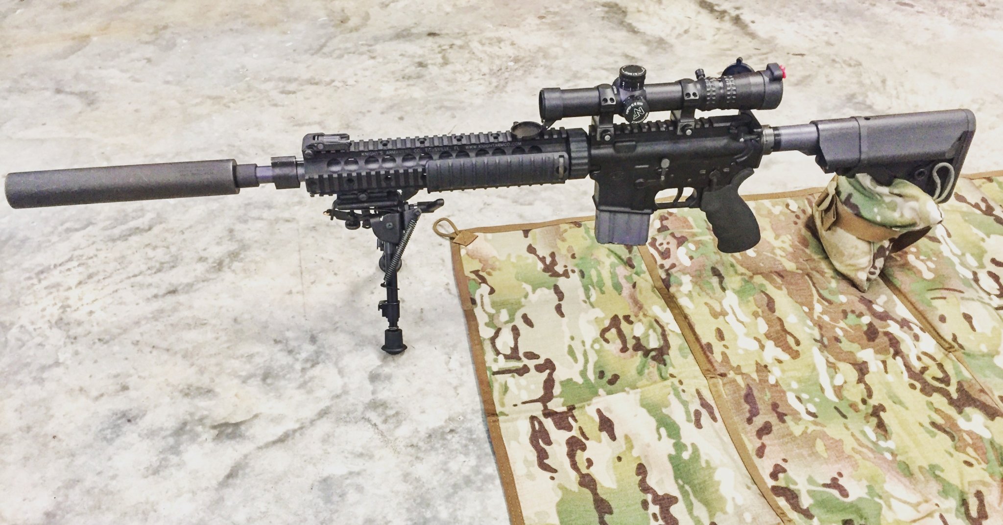

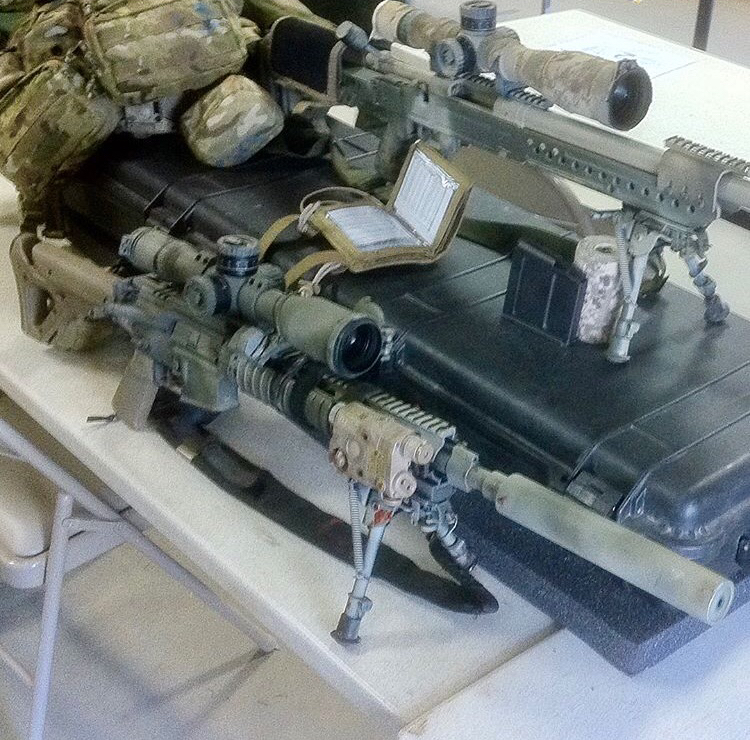

I have been down this road and the NF 3.5-15 is the way to go. Anything past 400-500 yards with the 2.5-10x24 will be difficult due to the tight eyebox and lack of parallax control on the x24. I actually ran a MK6 3-18 and loved it while I searched for the F1 3.5-15. I would suggest you go over to AR15’s MK12 thread as there is a plethora of information about what was actually used on these rifles and considered clone correct. The first 3 pics are of my old setup and mil returned Pelican case. The second to last picture is of the Nightforce F1 3.5-15 and the last is of the Premier 3-15 being used in service.

I went and tried both scopes on an SPR today and decided on the 2.5-10x42. The extra weight was kinda the deciding factor. I love the 3.5-15 too but felt it was slight overkill for a 223. I appreciate the help guys nd it was a really close race between those 2. The 2.5-10x 24 NF never was really in the race for reasons stated by y’all, short eyebox and lack of FOV and also it was a darker scope to me.
