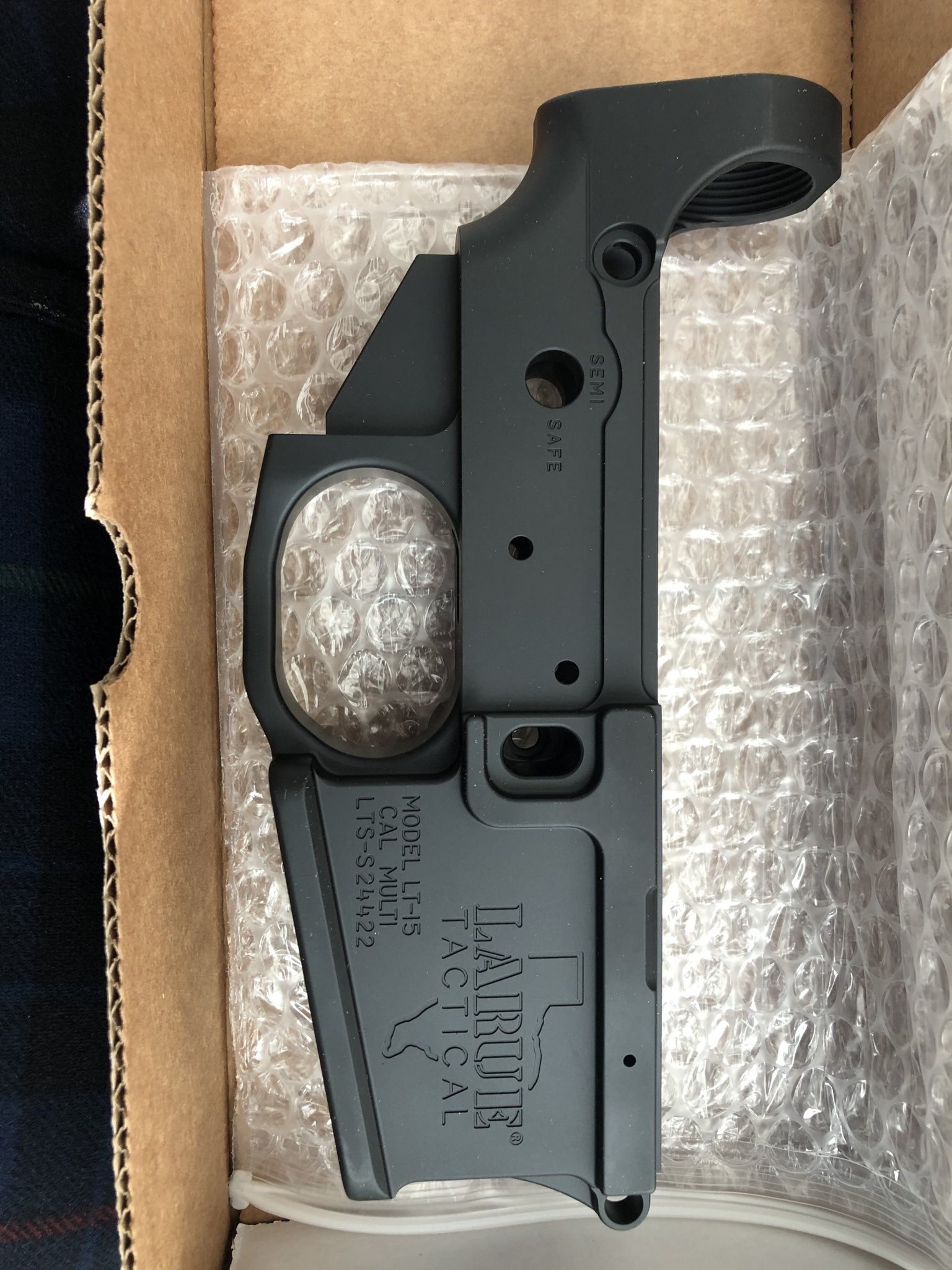

My Larue lower is waiting to be turned into 6 ARC SPR in 2021 😎🇺🇸

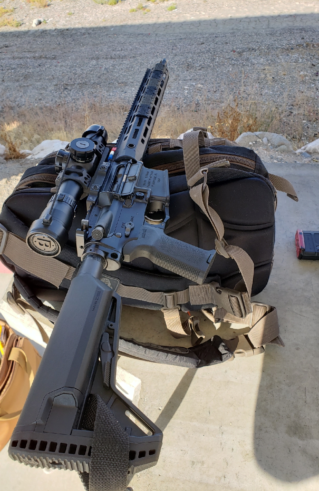

Fwiw I got the Athlon 2.5-15 ares btr and I have been pleasantly surprised by it, turrets are better than expected, illumination is good and glass is clear! but I’m not exactly a scope snob either and manage my expectations based off what I pay. Happy with it for my 18” spr tho
If it wasn't "made in China" I'd be very interested. It's my own personal preference. Send a pic on your SPR when you get a chance

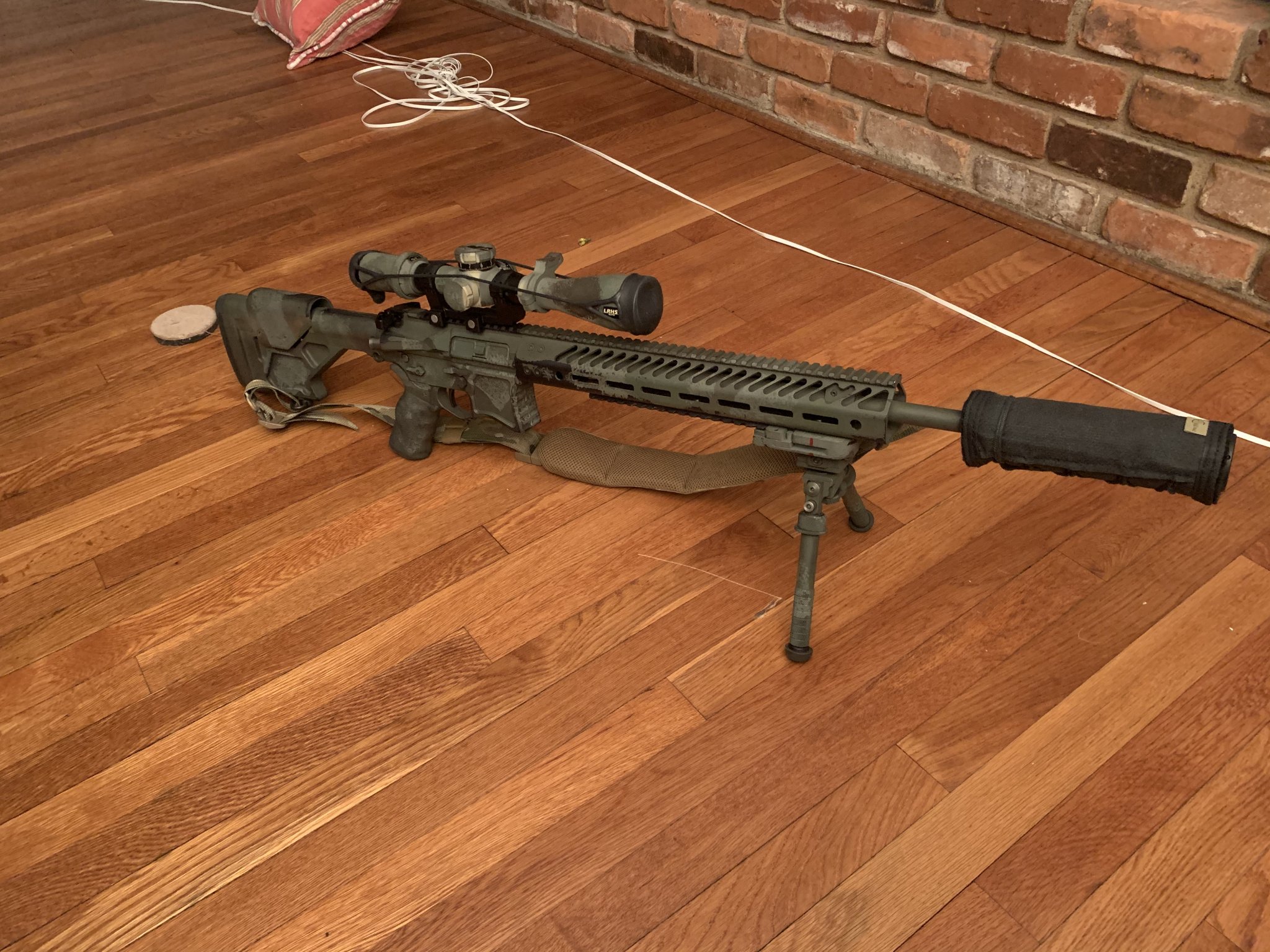

I have a SPR that I hunt with and shoot comps with. It has a Bushnell LRHSI 4-18. I really like it for the price, illuminated, and FFP. Just like as others have mentioned. I have used it to shoot deer at 15yds and targets at 800yds. It works. If there is a Gen 2 and George Gardner is involved again, watch out.
