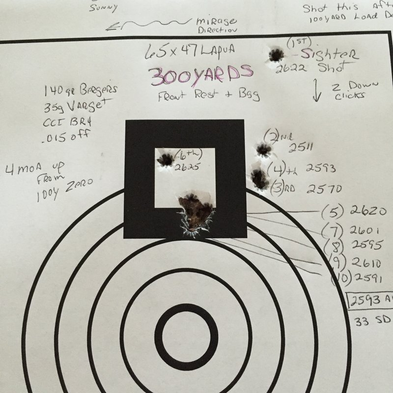

    photo46760.jpg Im using CCI-BR4s with varget in a 6.5x47 seems gtg
    I have 450 also going to try out as well
