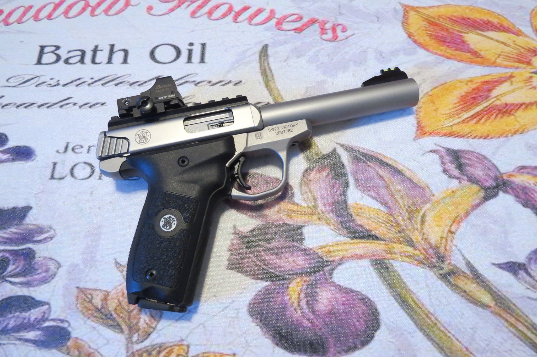

    I have several Burris FastFire IIIs. One on a G34, one on a Ruger Mk III Lite, one on a Mini-14, and one on a 9mm AR. I can’t speak highly enough about them and they meet all your requirements. Sure, I’d love to run DeltaPoints, but then I’d have only one!
