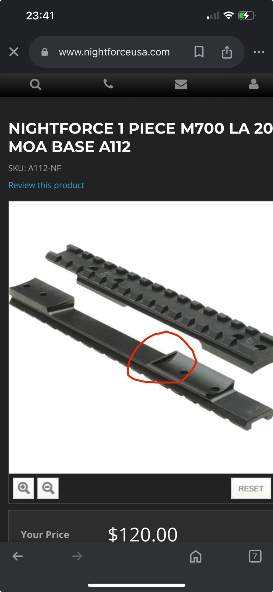

Why are the pic sections on NF rails not solid? Seems like that would weaken the interface? Don’t get me wrong I’m a NF fanboy, but when it comes to their rails seems like there are better options? Not being a wise ass. Legitimately asking.
I have no idea why they do that. But I can assure you if you have enough recoil to shear off the lugs on that base or your rings you’ll have plenty of time to research this info while having you’re shoulder surgery

I run the NF base on several rifles. Zero issues. I also have used the EGW base for $40 or whatever it is with zero issues.
Yes the NF has a built in lug
