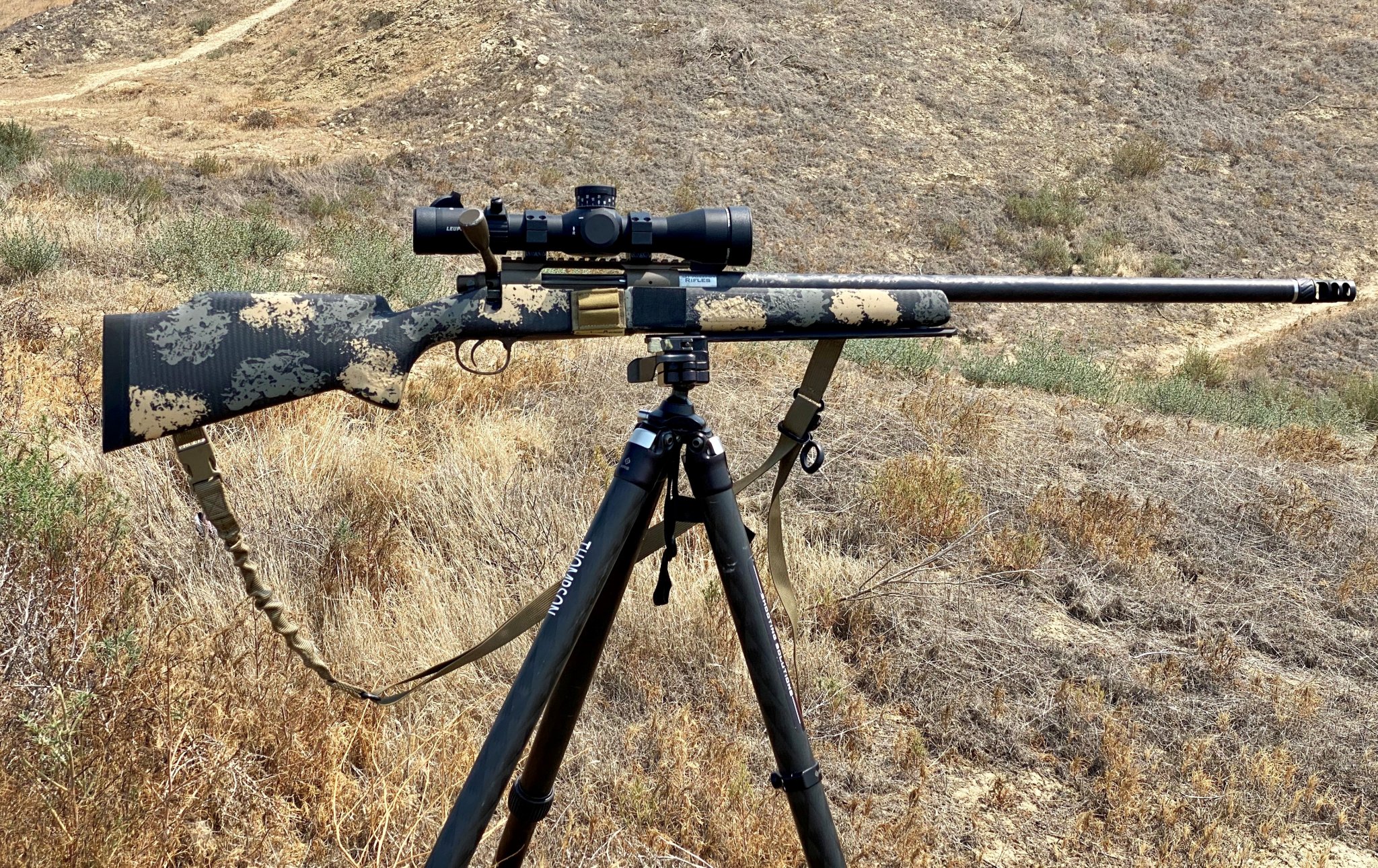

This is my ELK setup. The scope is heavier than some guys use but I wanted to lock turrets and full functionality of FFP. Still rides in around 10lbs with the rail and magazine. My pig setup is a SA with an adjustable comb but just about the same setup.
4 sections stow a tinny bit shorter but ae NOT worth the slower deployment speed, for hunting.

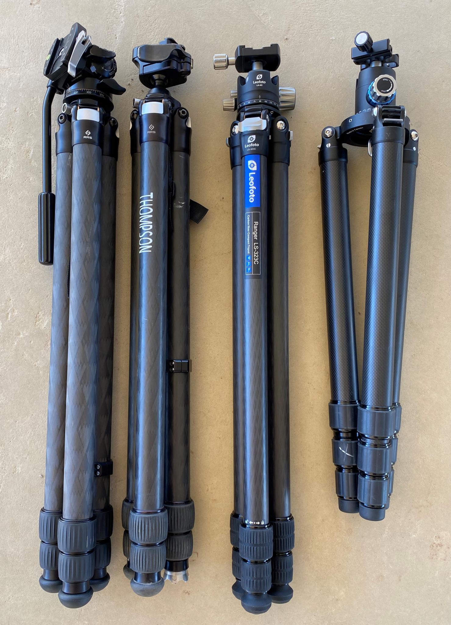

This is my old car spotting setup, we spot first near the trucks or ATV.

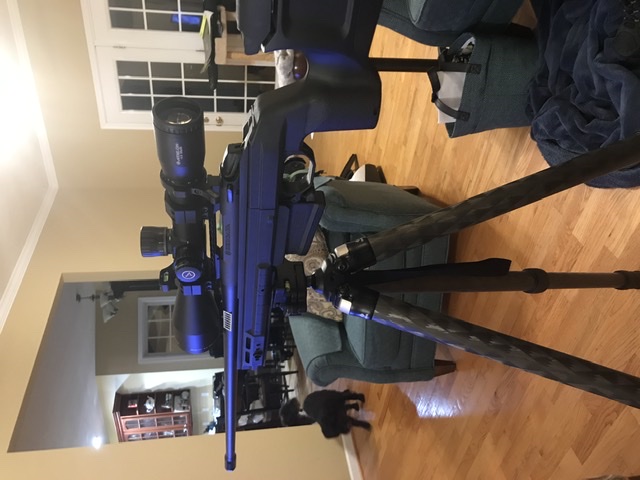

Wait a minute, have I been using my anvil 30 backwards?
I've had the lever facing away form me, i'd maneuver it with my index and middle finger. I never though to flip it and trip my thumb.
Are you referring to my picture?
if so that’s backwards for a right handed shooter. Unfortunately, you can’t flip the latches on a Anvil 30, so that one is spun 180 to accommodate me shooting the right handed gun and tripod, left handed.
If I could I certainly would like to see the locking lever on the opposing side of the tensioning lever. Even though it might be a hair slower it could save a rifle if a high stress, low light condition from accidentally being hit
