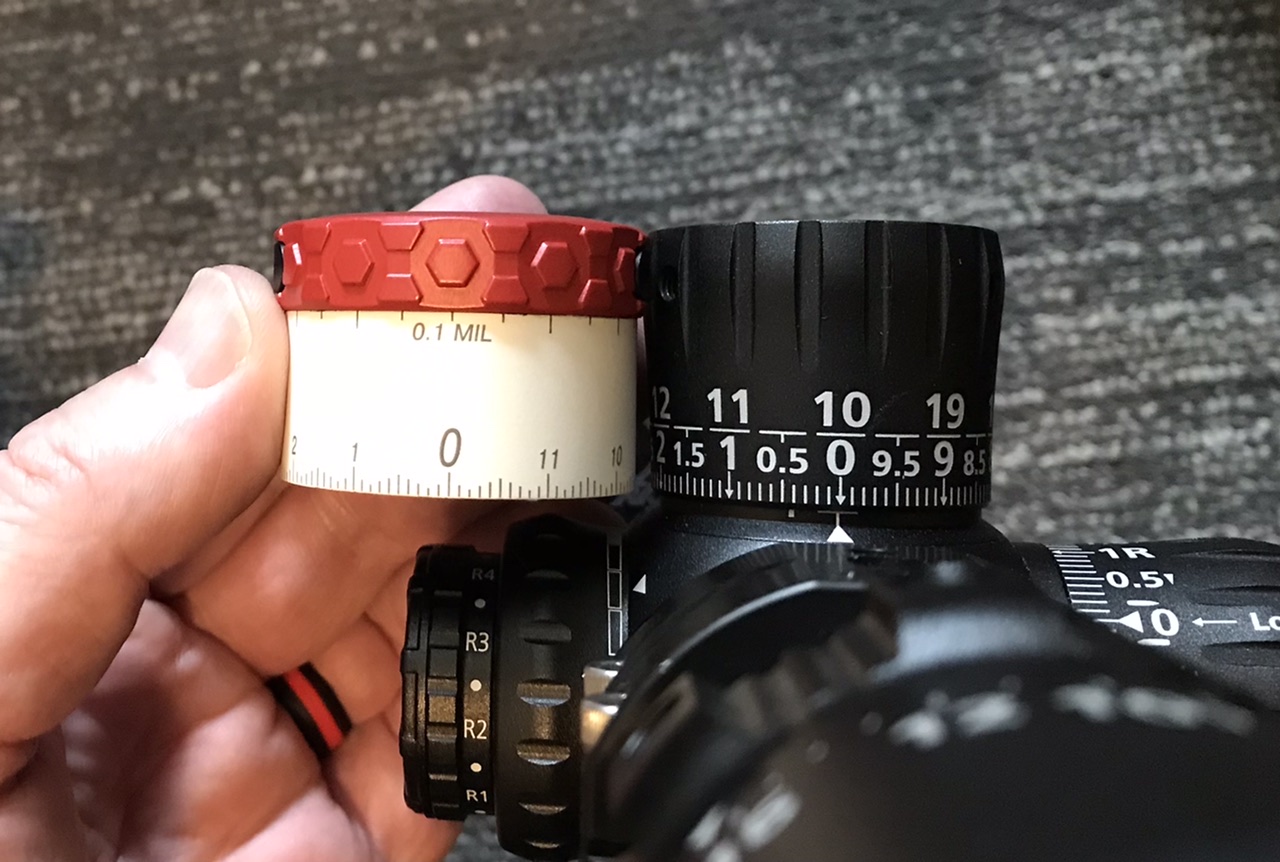

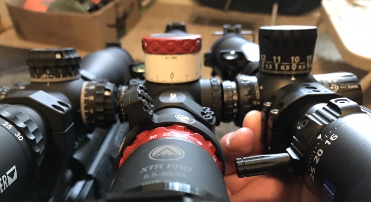

I'm actually selling a TRACT Toric very soon (got a great deal on Gen III's and had to get them) and I've loved that Toric. Don't worry about those turrets, they are the easiest turrets I've ever used and I actually hated going back to the turrets on my ZCO I had on another rifle after shooting with the Toric. The glass is VERY clear and gives a Gen III a run for the money. The reticle is AWESOME in my opinion. They may have a sale this weekend for Labor Day. I've heard very good things about all the other scopes you're looking at...I will say that a top shooter I shoot with is moving away from his Cronus due to glass that's not up to his expectations, but again, that could be subjective. Finally, glass, toughness, and reticle are the most important things for me. Everything else, including locking/not locking turrets is secondary...At least again, for me.
You can see my review of the Toric here:
The Zeiss is the easy winner in your list. Even the 4-25 would be a good scope if the 6-36 is too much. The 4-25 also has 46.5 mils of elevation. 25x is enough for matches. I can think of maybe a few times I went over 16x in matches this year. I have the 4-25 on my Vudoo on a 20 moa mount and 40 moa base and have about 41 mils of up elevation.
I have owned the Pro and the Tract also from your list and both are excellent. I wasn’t a fan of how far you have to pull the Tract knob up to unlock. If they dropped that down to about half of what it is that would be great. The reticle is really nice. Their new 4-25 is worth a look too as it has a ton of elevation also.
The Pro is really nice also and the 12 mil race dial is a cool feature. No tool zero also. Has 26 mils of elevation so on a 40 moa base you can dial to 400 yards. You can just take the cap off the windage knob if you wanted it exposed but I usually hold wind so doesn’t bother me.

Out of these options, which do you think would be the easiest to get behind quickly and focus in on your targets? On my current EP5 my biggest weakness is finding my targets and getting behind the optic. Some of this should be resolved though when I have a stock that allows me to get the proper length of pull and cheek weld.
The Zeiss. Glass is really good. Reticle is good. But the amount of elevation travel is insane. My only knock is the tall turrets. But that's just a minor gripe. I'd buy one.
The Zeiss turrets aren’t any taller than the Burris Pro dial. They really aren’t overly tall for a scope. Below are the Steiner T6, Burris Pro and Zeiss S3 next to each other. It was hard to hold them all where tubes are about the same so took another pic of the Pro turret next to the Zeiss.
That is definitely more to do with the total set up in having your rifle set with proper comb height and eye relief and having it on a lower power so you have a larger FOV. A usual mistake made by newer shooters is having their scope on max power. Dial it down to about 14-16x and you have a much larger FOV to find targets.
Have used them all in matches and didn’t have a hard time to get behind any of them and find targets. They are all pretty easy to get behind.
Reactions: Litzner
