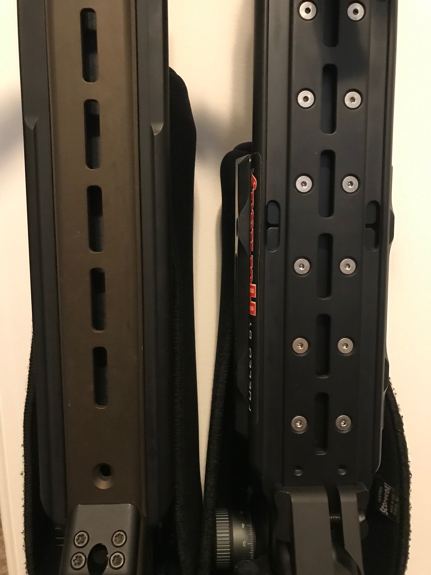

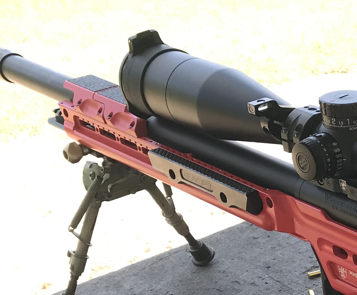

What MPA chassis do you have? The side rails are made for the flat sided forends to add some width and make it closer to a Pro but if you have a Pro you don't need it. Below is a pic of the Side Rail on an ESR(L) compared to the Pro(R). The second link you posted is actually a weight with knurling on top and similar to the standard weights. Not really a "side rail" in the same sense. Also a pic below on the red chassis.
Reactions: Vyx313

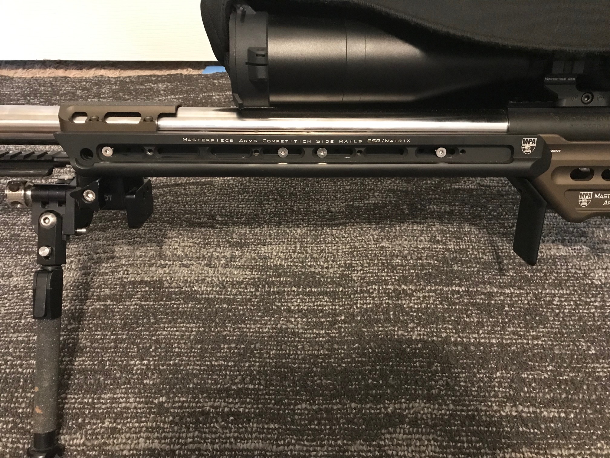

Get the MPA side rails and then add the weights outside of it as needed for balance. The side rails add width so when you set it on a bag it will settle better with the larger footprint.
Reactions: Vyx313
No down side to the width and it's not overly wide where it causes any issues. People still using plates under rifles so still a need for some width. I just like the feel of the width of the Pro on a bag even without the plate. It sits better and gives a more stable position than thinner options I have tried.
Reactions: Vyx313
