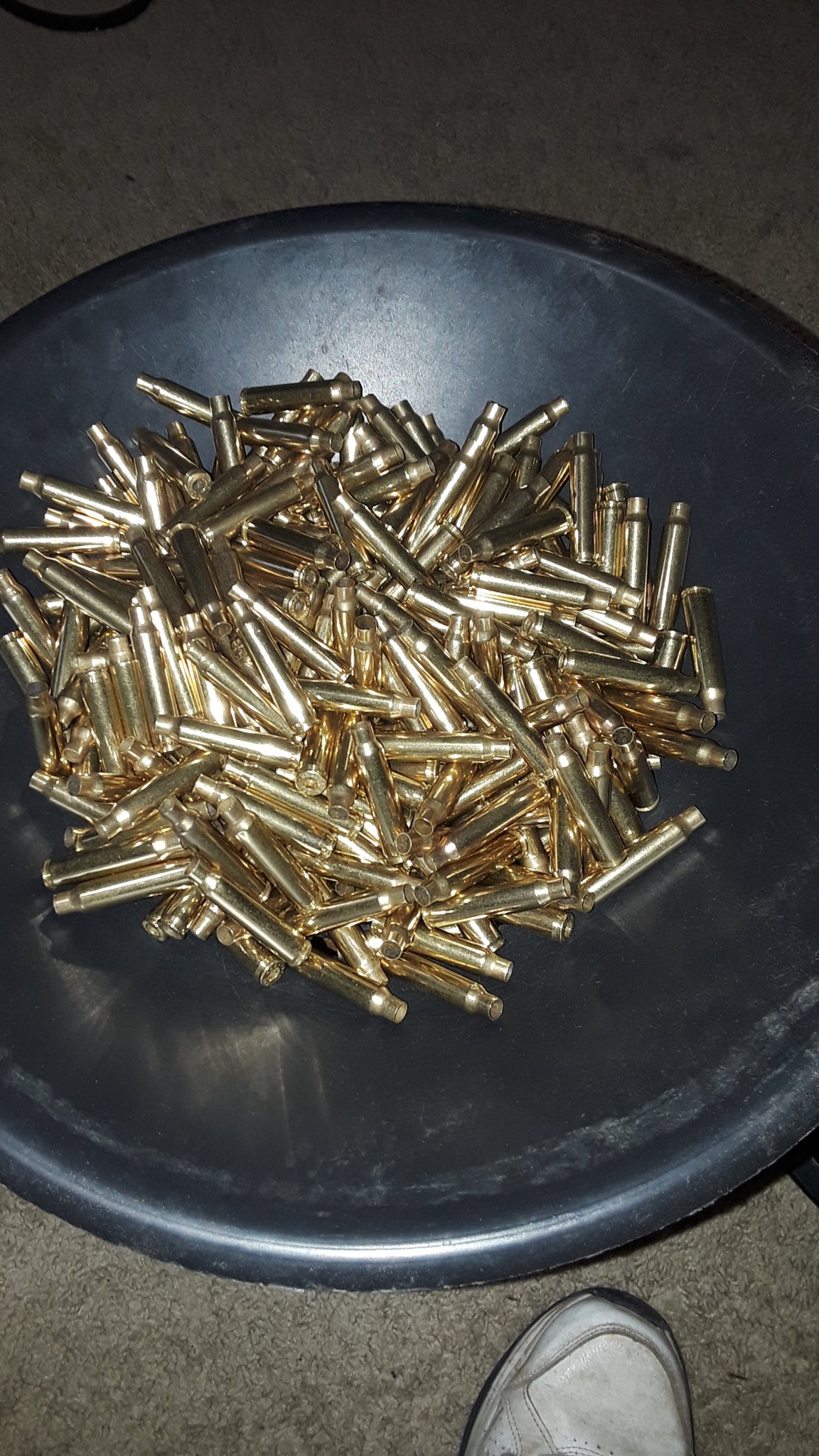

Walnut media takes sizing wax off just fine. Mineral spirits and car wax in the mix.
This was range brass, cobb kept getting stuck in flash holes lizzard bedding does not.
