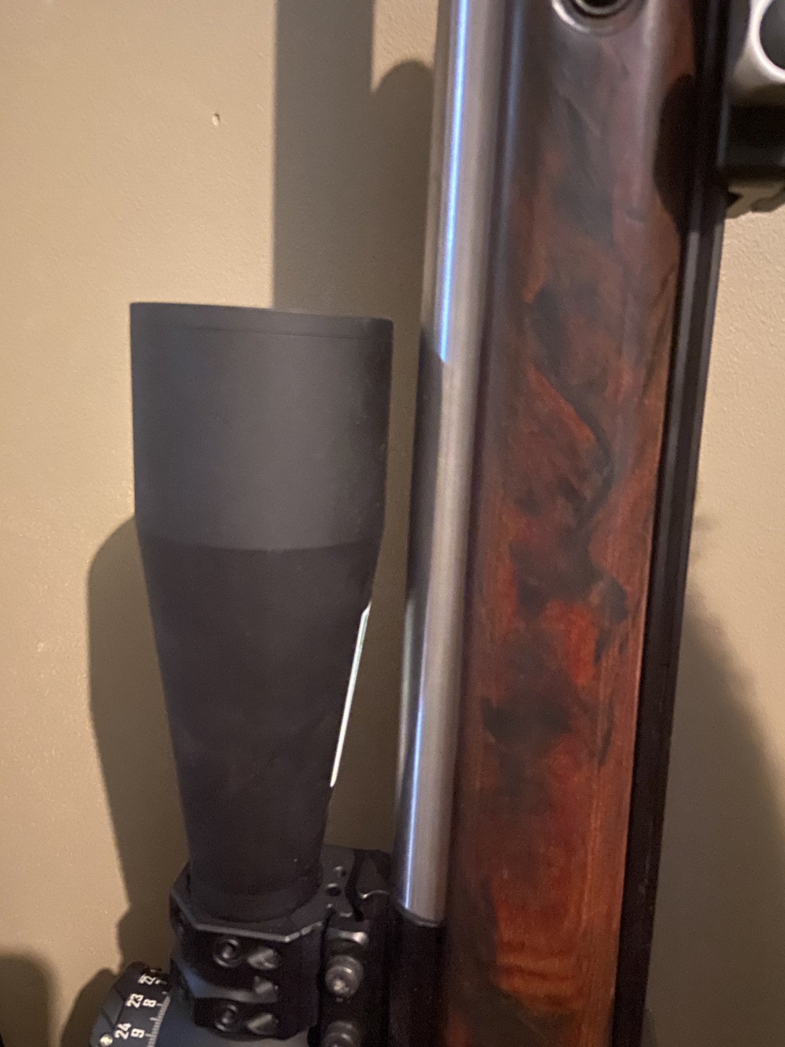

    I run a 1.125 " mpa mount with my bighorn heavy Palma. Bolt handle and scope objective clear . I think a 1.250 would be better though more room to cycle bolt handle. Hope this helps

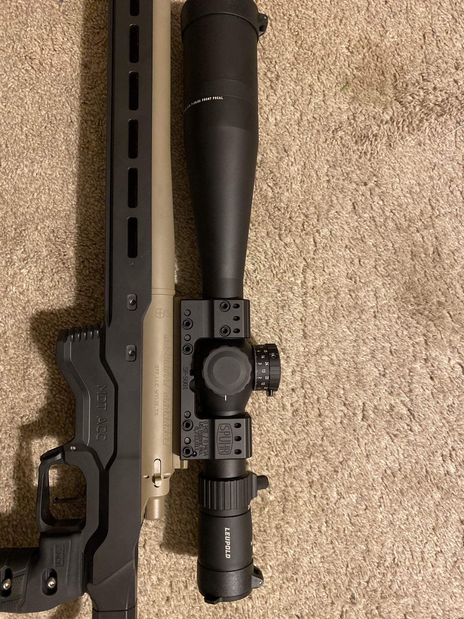

    Here’s how much room I had on mine with a medium Palma barrel. 5001 with plenty of room. Plenty of room for bolt cycling as well.
    @Rob01 has more experience using m24 contours and lower rings but I don’t know if he’s ran a mk5 or 35mm tube either. He might chime in here to help.

    Thanks for the picture and wisdom.
    I currently use either medium or high (cannot remember) Seekins rings on a 30mm tube. I know when going to that 56mm and 35mm tube things are way different
