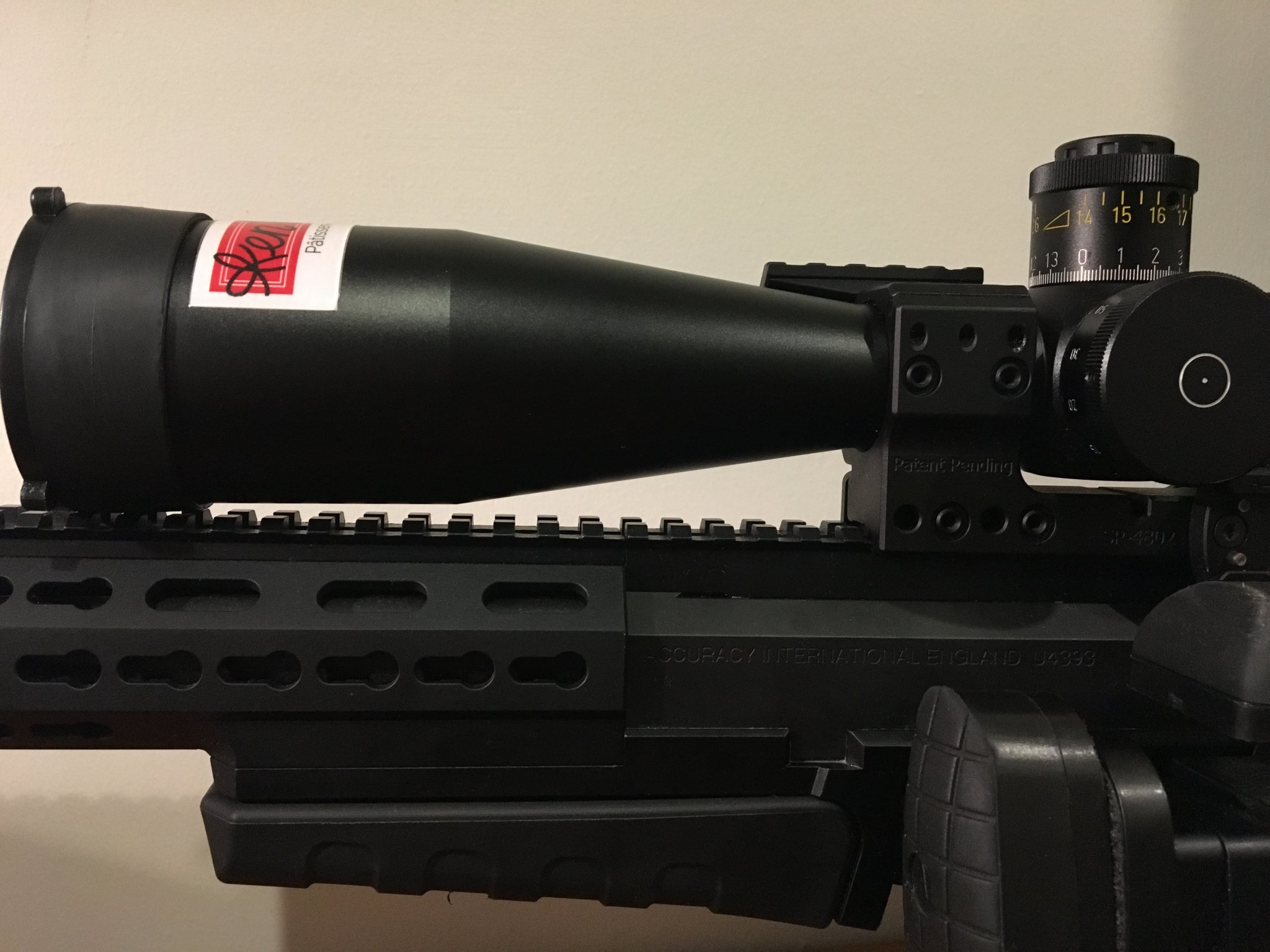

As above, which mount has worked best for you. Will be shooting 308 and 6.5 Creedmoor in rifle.Do you order AI specific mount or Picatinny mount? 6, 9 or 13MIL mount?Will be moving a 34 mm tube scope 25-27x maximum magnification scope.
Thanks!
Depend the total travel of your scope, how far is your range. Your AX should had 20moa cant already. I have the eratac adjustable inclination mount which I set my 100yards zero with 30moa incline with built in 30moa AI base. I get 25 mil of elevation of dialing
I have SP-4802 (37mm (H), 44 MOA) on zero rail. Scope is S&B 5-25x56.

Not sure why you’re against the 1.5” mounts or rings. Modern rifles and butt stocks stocks make it a non issue, at least in my book. With the top rail I’m running the highest Seekins (1.45 or 1.5 I can’t remember) rings with a 4.5-27 razor gen 2 and the vortex defender cap. You should be able to get away with a 1.2ish with the top rail removed.
Reactions: M8541Reaper
Yea I know, just have a preference for keeping things low (despite having an adjustable cheekpiece). I was figuring the 1.2 or 1.3 range would get me nice and close to the barrel with room for a cap. Something like the Badger High (1.275") or Spuhr SP-4006 (1.35").
Thanks for the info man!
