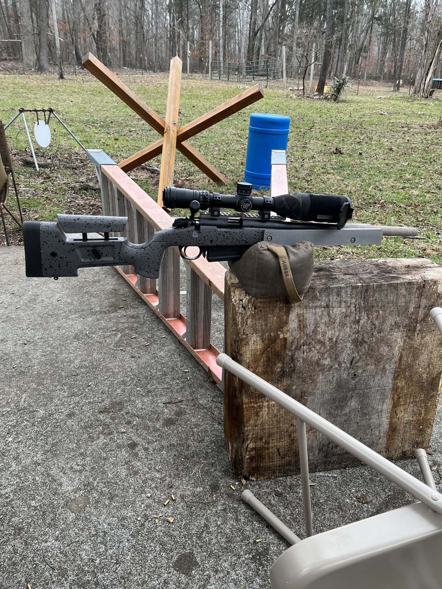

    I have the complete B14R rifle with steel barrel. I like the factory stock and my centerfires are in chassis so I have some comparisons. I just added an Area 419 ARCA rail to the bottom - I plan on leaving the B14R in its factory stock.

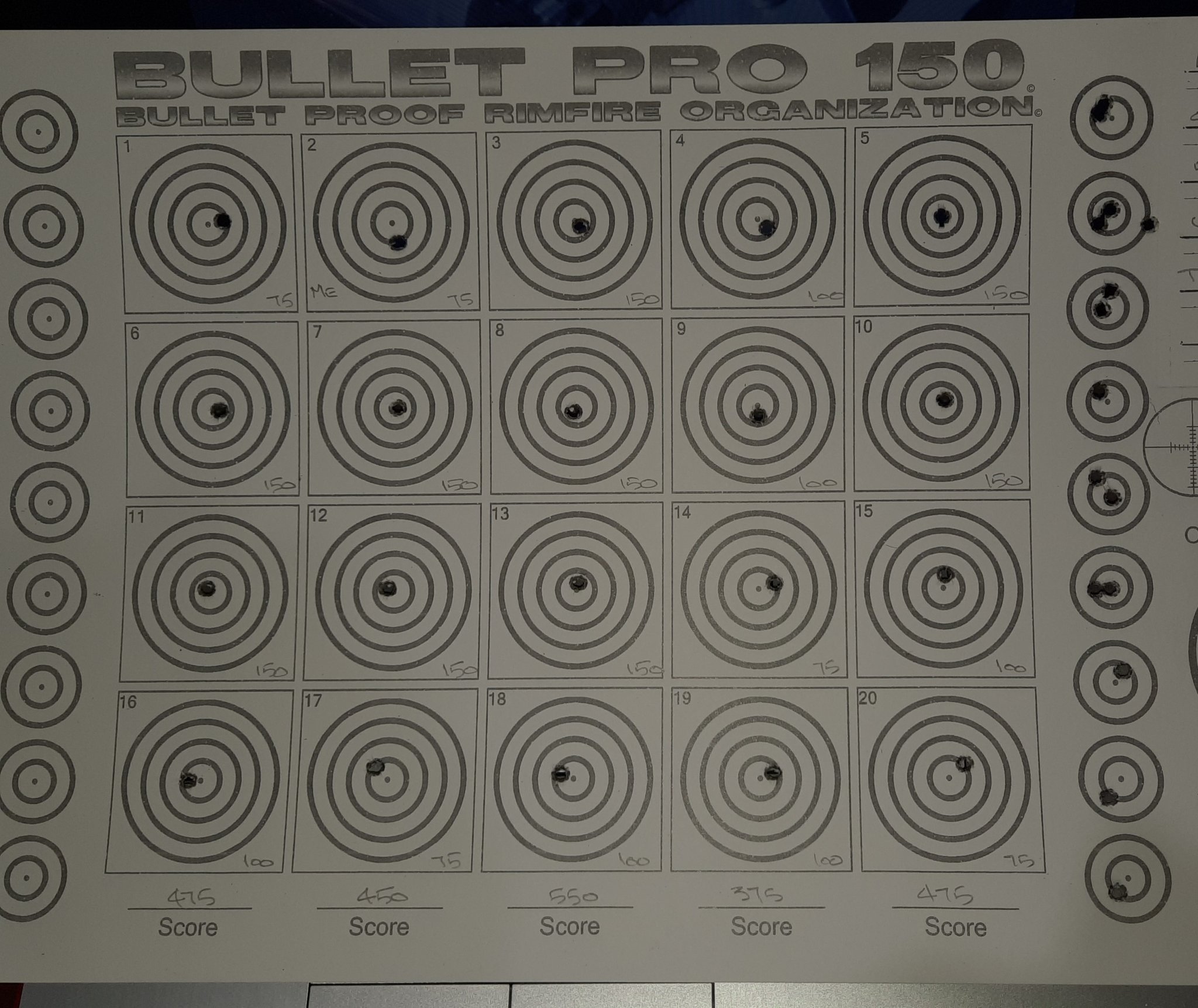

    My B14R shoots as well as My V22 Gen 1 does when sent to Lapua. And the Bergara has an aluminum mini chassis built into
    the ploy stock. I put my B14R into my V22 chassis but decided that it did nothing for it's accuracy. So mine has stayed in the OEM

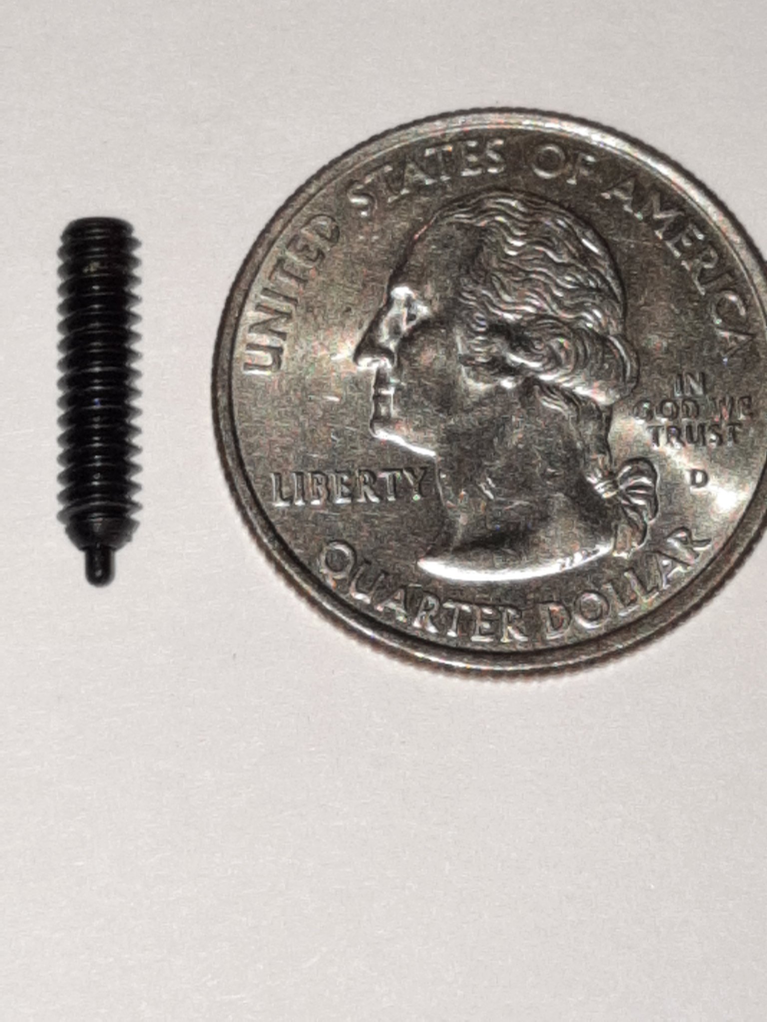

    stock. Even the trigger is easy to modify and get it down to 11 ounces with a #6-32 long nose spring plunger. A total cost
    of $4.56 and 20 minutes of time. The mod also provides the trigger with an adjustable sear stop. I'm really happy with my
    steel barrel B14R. The OEM trigger is pretty nasty but the targets below were shot with it. The mod just makes it nicer.
    The CF rifle is only a tube shroud that hides a pencil barrel so I would never but it.
    You can see that the #6-32 fit's fine in the trigger. There is a pilot hole in the OEM trigger so all you need do is enlarge it
    with a 7/64 drill and tap it for the 4.5 pound spring plunger. There is no need to open the trigger module.

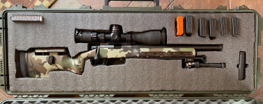

    I bought a barreled action when they first came on the scene and there wasn't many reviews or feedback. I got a great deal on my Grayboe on one of their 4th of July sales, so it was about the same price at the OEM rifle. Now that I have some milage on mine and some OEM stocks, my recommendation is OEM unless you are dead set on something else or perfect mimic of a centerfire stick.

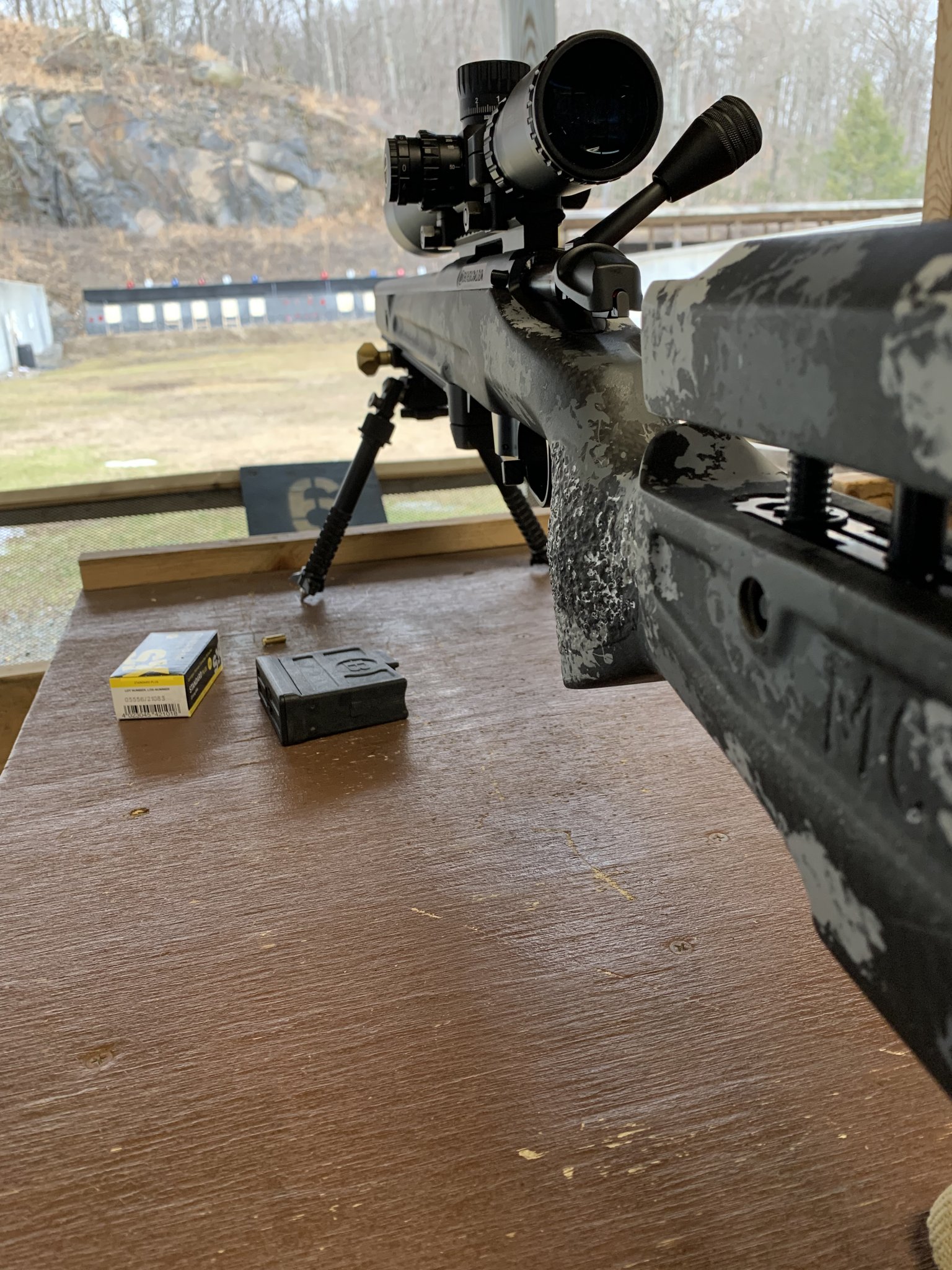

    I’ve got mine in a manners PRS1, it’s definitely not an inexpensive option but it matches my centerfire. It’s definitely a great option for PRS matches, just need to play with mags due to the slight rock you might get with the dbm to get rock solid feeding but once it’s figured out it’s a gravy sandwich
