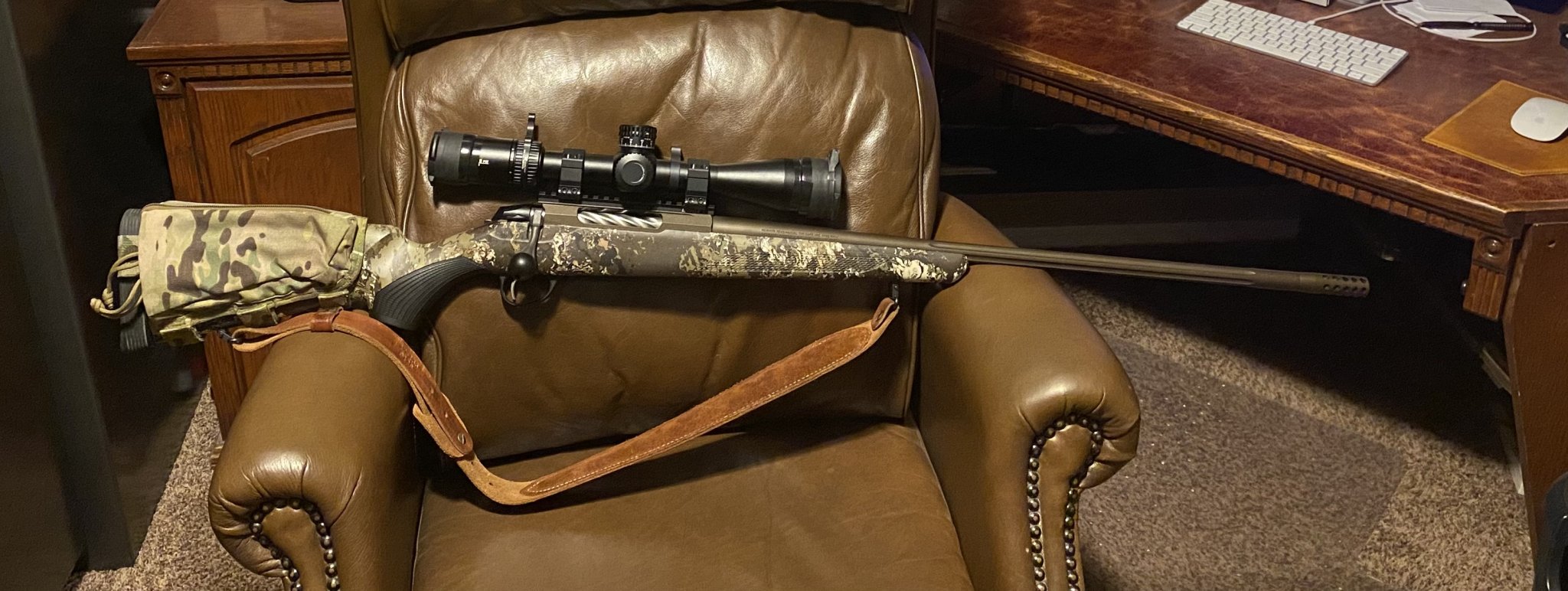

I had a similar predicament. Here’s another option.
I ended up selling my ss T3 superlite in 300wm to a friend for $600 when I found a T3x veil 300wm on the forums….mainly to get a threaded barrel for a brake. I had that superlite a long time and always wanted to thread it to use my suppressor or a brake, but it’s too thin in my opinion.
I paid $860 shipped for the veil. I sold the superlite to a friend, but you could probably get 700+ for yours.
Ended up with a nicer rifle for a pretty small amount of money ($260)….Threaded 5/8x24, factory brake, cerakoted, camo stock, etc
