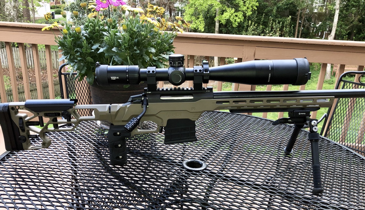

    T3X CTR is still in the plastic stock for $1100 at Eurooptic. I paid $850 for my T3X Varmint and put it in an MDT LSS-XL chassis (super-smooth feeding with MDT 10-round mags) and upgraded the bolt handle with an Anarchy Outdoors unit. Final retail price about $1800. Shop carefully and you can do much better.
    I shot 77grain SMKs more than anything else. The 1:8 twist was ample.

    View attachment 7414709t
    Your mags the mdt polymer ones?
    Yes. While the T3X Varmint was a perfectly good rifle with half-MOA accuracy and super-smooth feeding, I got a wild hair about building a 6.5CM/.223 switch-barrel setup on a Defiance Deviant in an MDT ACC chassis. So I did. Split up the rifle and chassis, sold both in a day. The magazines are now used in the new rig.
