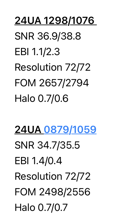

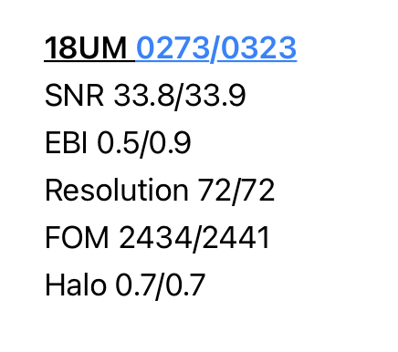

    1, 2, or 3?
    EBI is important because I’m looking at rural use, prefer not to use a lot of IR, other than while actively shooting.
    I asked for them, anyone else?
    The price difference isn’t significant compared with the cost of the units. I’m willing to buy once cry once if the aviation units are better, I definitely want the best performance in mixed environments with a lean towards rural starlight.
    If cosmetics are all equal I’d probably go with the 18UM on specs alone. Especially if there is a premium for the 24ua. I don’t think you’d notice the small increase in fom. I think you’d notice the decrease in EBI during extremely dark circumstances.
    That being said, ask about fixed pattern noise in the tubes and the cosmetics.
