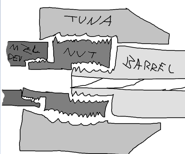

Well my plan is to turn up a sort of thread protector nut with threads larger than the barrel on the outside. And have an extension with 1/2-28 threads to bolt a brake or compensator or what have you on. So you could still experiment with muzzle devices, whilst the tuner/weight could be adjusted on the outside threads. See my super fancy potato shop (I'm very skilled at digital artwork!), I think this explains it a tiny little bit better;
Should work? Or maybe not? Any input on this "design"? Drawing no to scale... :LOL: I'm open for debate! 'cause the more I read into this stuff the more I want to try it. But everything I can find for sale online is overseas...

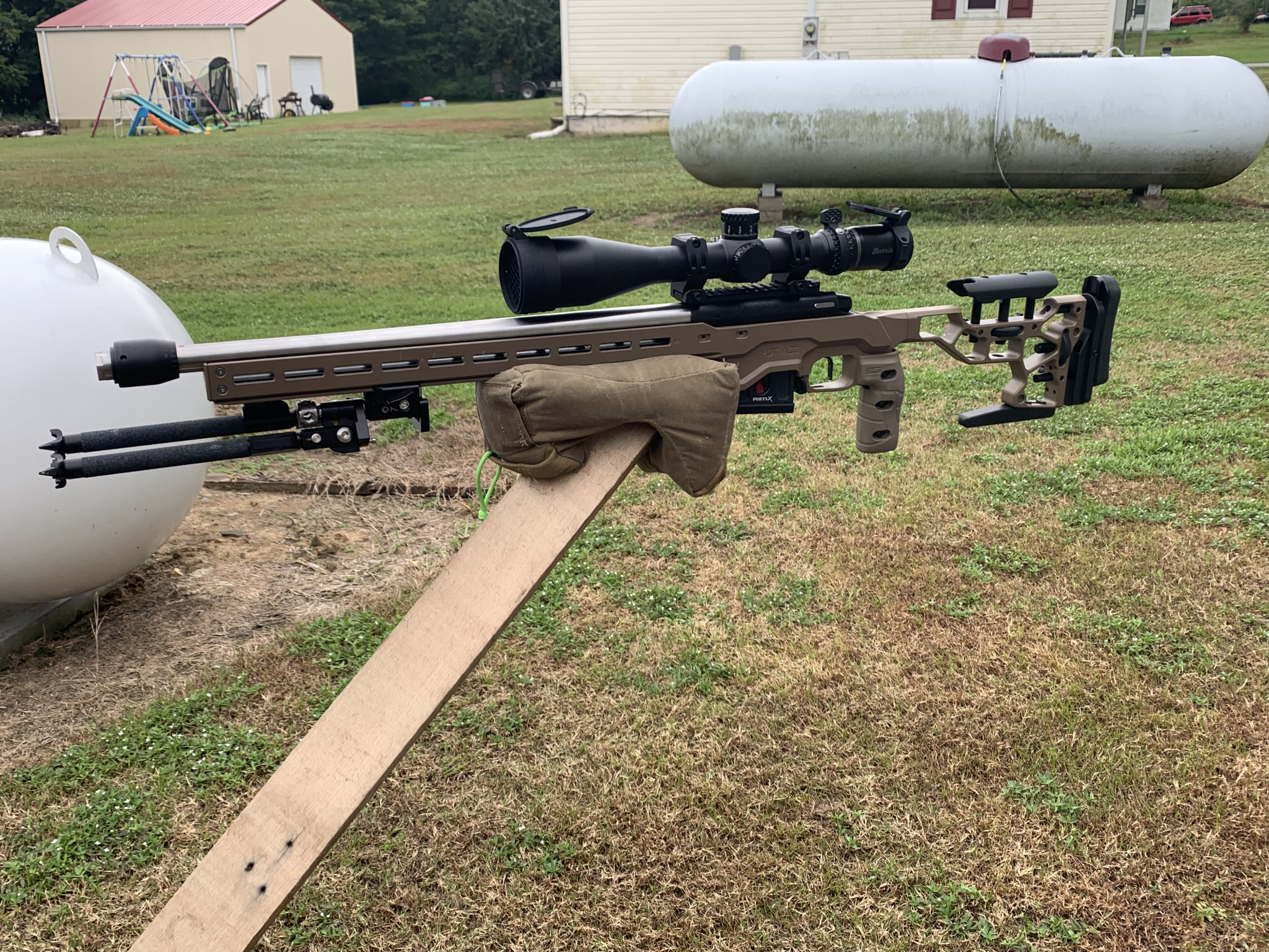

I am using an ATS tuner on my 5/8-24 threaded 22" M24 barrel on my RimX. I have beaten it on barricades and everything in-between during a match without an issue. It has stayed set where it needed to be with just 1 screw in it.

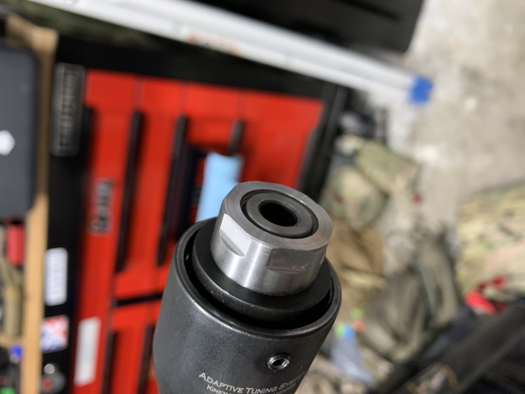

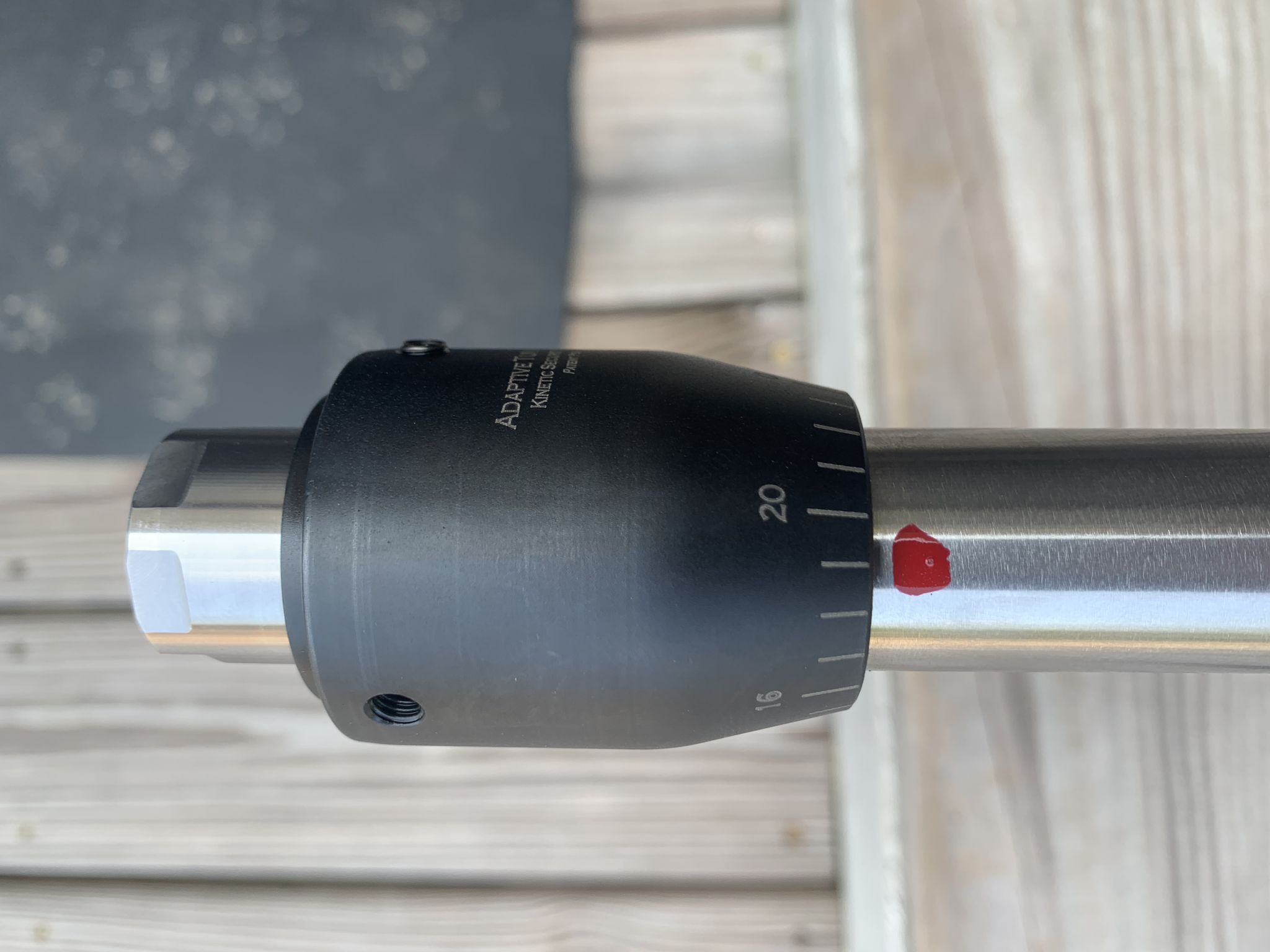

It was real simple to see it work. I made one rotation and back around to 20.5. the red mark is what I am basing my numbers off of. That was a quick tune at 50 in my back yard. I used probably 100 rounds to get the tune and fine tune it to where it is setting now. [20.5] it was fine tuned at 100 yards. This was also after the shorter thread protector was installed. It is amazing to see how such a small piece plays with harmonics.

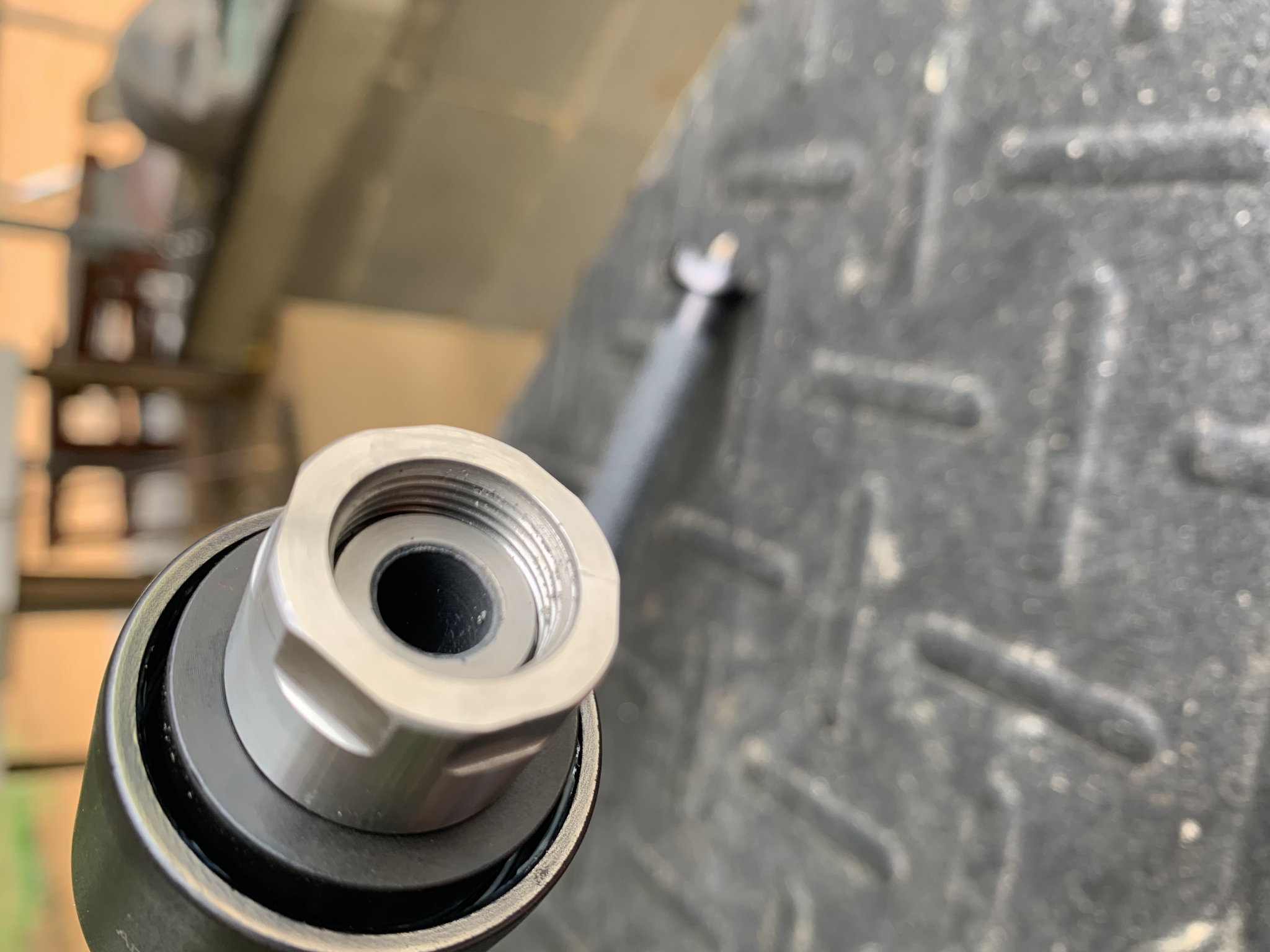

It just threaded onto the factory threads of the barrel and thread protector holds it in place.
I would say you have plenty of threads. I had PVA spin up a shorter thread protector for me and you can see the difference in the pictures.
