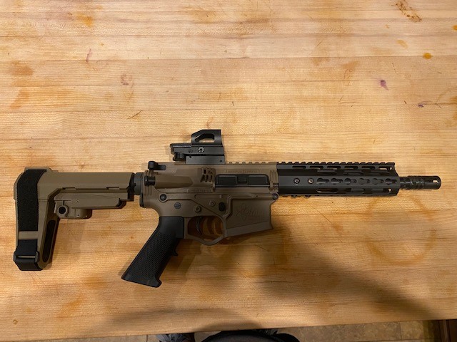

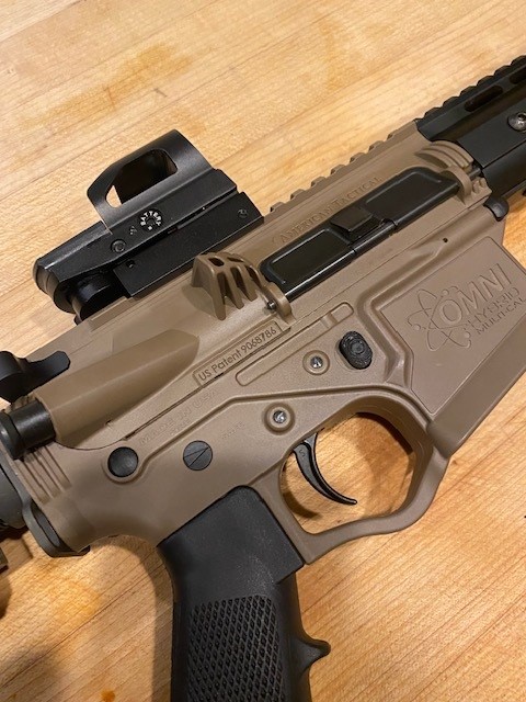

I have a 16 and 7.5 and for that distance either will do, the round was intended for 14.5" and below. so for home defense go short, 16" is clumsy. get something along these lines and you'll serve both purposes with equivalent success, and honestly even a super sonic 300 is pretty much ear safe with a good suppressor. here's one of mine, people knock the polymer lower, but for $299 at the time it was a deal,, and good luck to them finding anything close nowadays. but, throw can on it and you're good, even supersonic is quiet enough for no ear protection.
