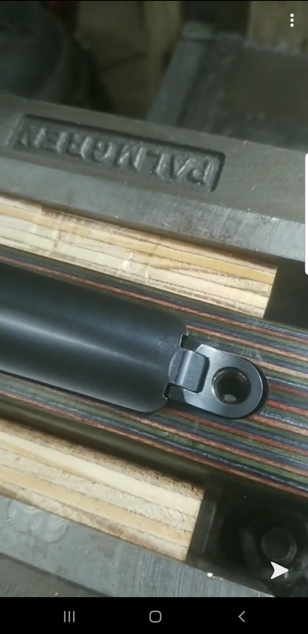

A couple paint sticks cut to length is all I used till this year when I found some good quality plywood scraps . It holds the stock well enough for cuts in the vise area when cutting further out a machinist jack holds it from dipping.
