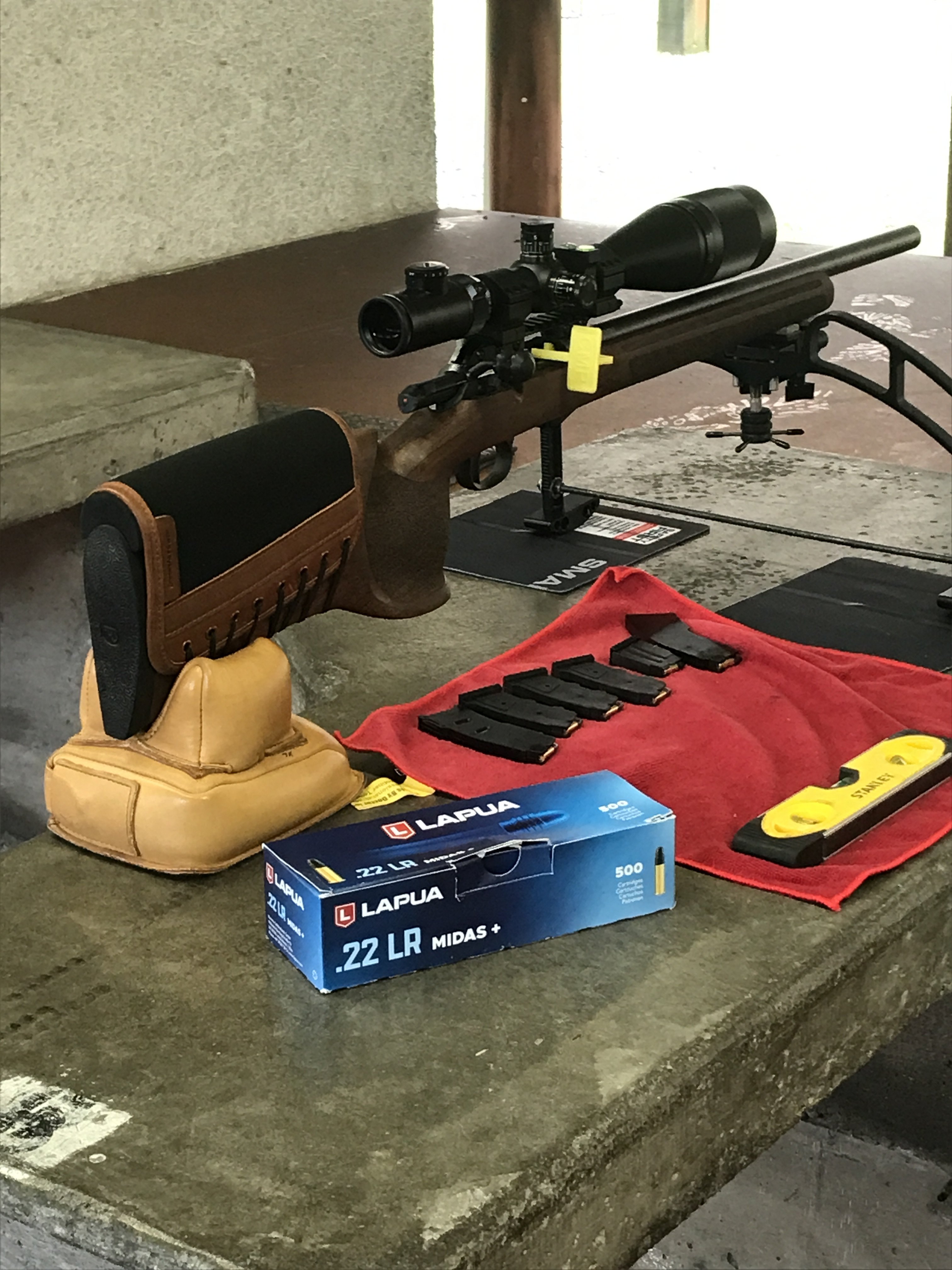

Considering either a Bergara B-14 R .22 LR Trainer Threaded 18" Carbon Fiber @ $1,100 or the Tikka T1x UPR .22 LR 20" @ $1,200
I have a CZ 457 MTR that has shot a 5 round/50 yd group down to .13" -once- and can also throw a round out 1/2" from
a group without thinking. Most good groups are .25-.3 range. I have been shooting for 10 months now. ARA and N50 mostly.
I had the Midas+ ammo matched at Lapua test center in Feb. That was good for about a .1 reduction in 5 shot group size.
Or I could just buy another $220 CZ Varmint Barrel and see if I get lucky.

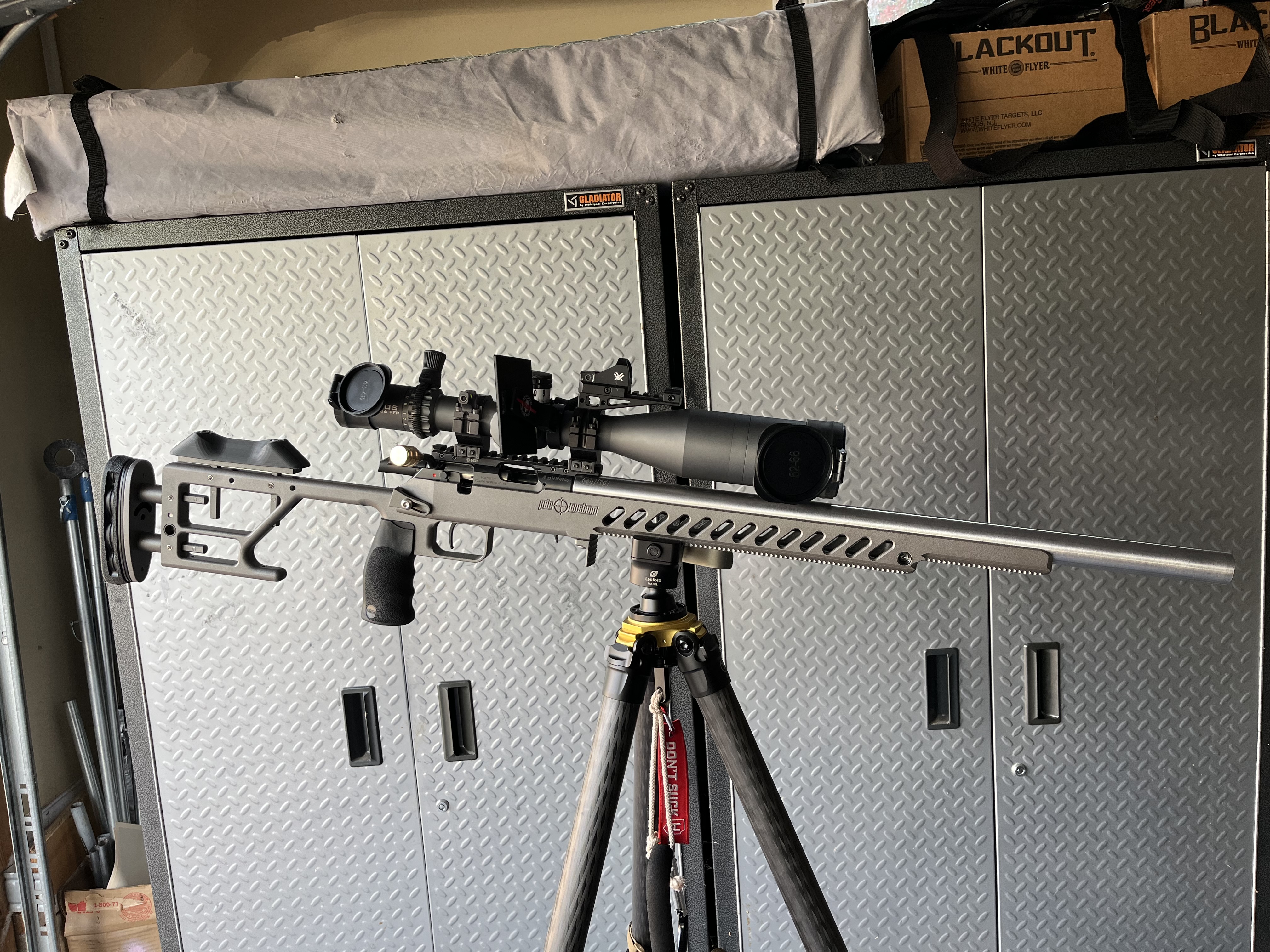

This is my heavy CZ sitting in a PDC Custom chassis with an L3I barrel. It is a tack driver, and given that you have the action, would set you back $1100-$1200 or so.
