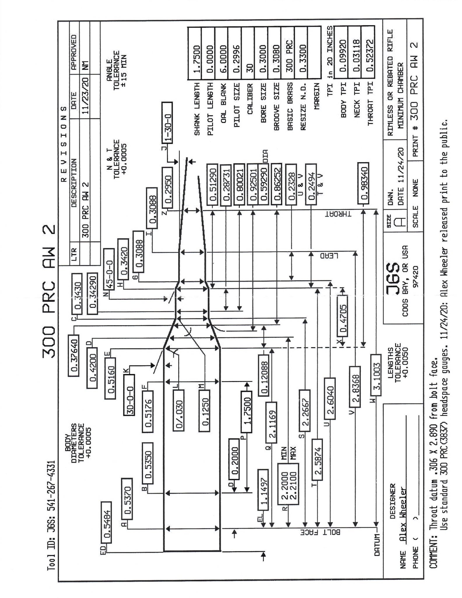

Hi Everyone
I was using the Forster FL Sizing die to size my 300 prc brass. I just got my whidden gunworks click adjustable sizing die. Looks like whidden die doesn’t size the body as much as the Forster die, I compared the measurements below the shoulder body junction.I bump only 2 thou.
Reamer print: 0.5160
Fired: 0.5160
Forster Die: 0.5125
Whidden die: 0.5160
Ps: I tried to chamber both cases with the ejector and firing pin removed, bolt drops freely on the Forester one but the whidden one drops a little bit slowly with gravity
My question is am I going to run into pressure issues with the whidden die?
Is it better to have some more clearance in that place?
I really like it, it sizes more consistent
(-/+0.0005)
Thanks

A few of us tried Whidden dies years ago and all had issues. They seemed to be about the worst made dies you could buy at the time. Not sure if anything has changed in the last 6-8 years. I also bought one of their mini chassis inserts for a Mauser which was super cool but the action screw holes were cut so poorly that they were visibly off about 10*. I can't really find a good reason to give them another chance when there are so many good options out there.

They asked me to send 3 pieces of fireformed brass + the die so they see what they can do or they can build me a custom die for the difference, I just emailed them back that I want to proceed with the refund.
I will buy the Short action custom die, I am so happy with the results I am getting on the 6.5 cm die that I am using.
They took care of me on the chassis thing, no issues with customer service and I got something workable in the end but it just seems the QC is pretty much non existent.
