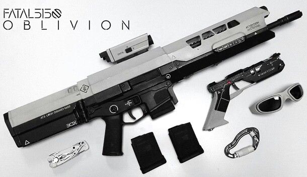

    Oblivion
    It will 100% make a difference. I deployed to the middle east multiple times flying tankers and our maintenance team repainted some of the control surfaces white IOT keep their temperatures lower. I love the storm trooper comparison!
    Thank you for the input. I think every little bit has got to help
