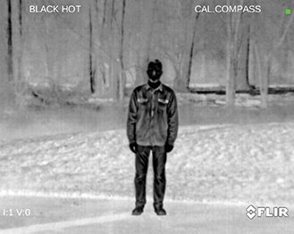

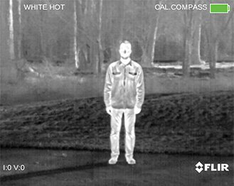

Thanks for the replies guys. I am new to the thermal game and like white hot, but I notice on a lot of videos most of them are black hot. I just wondered if the resolution was better with black hot?
On some of the higher end thermals the clarity and detail on black hot is noticeably better than on white hot, which makes for good video, particularly in open areas, fields, etc.

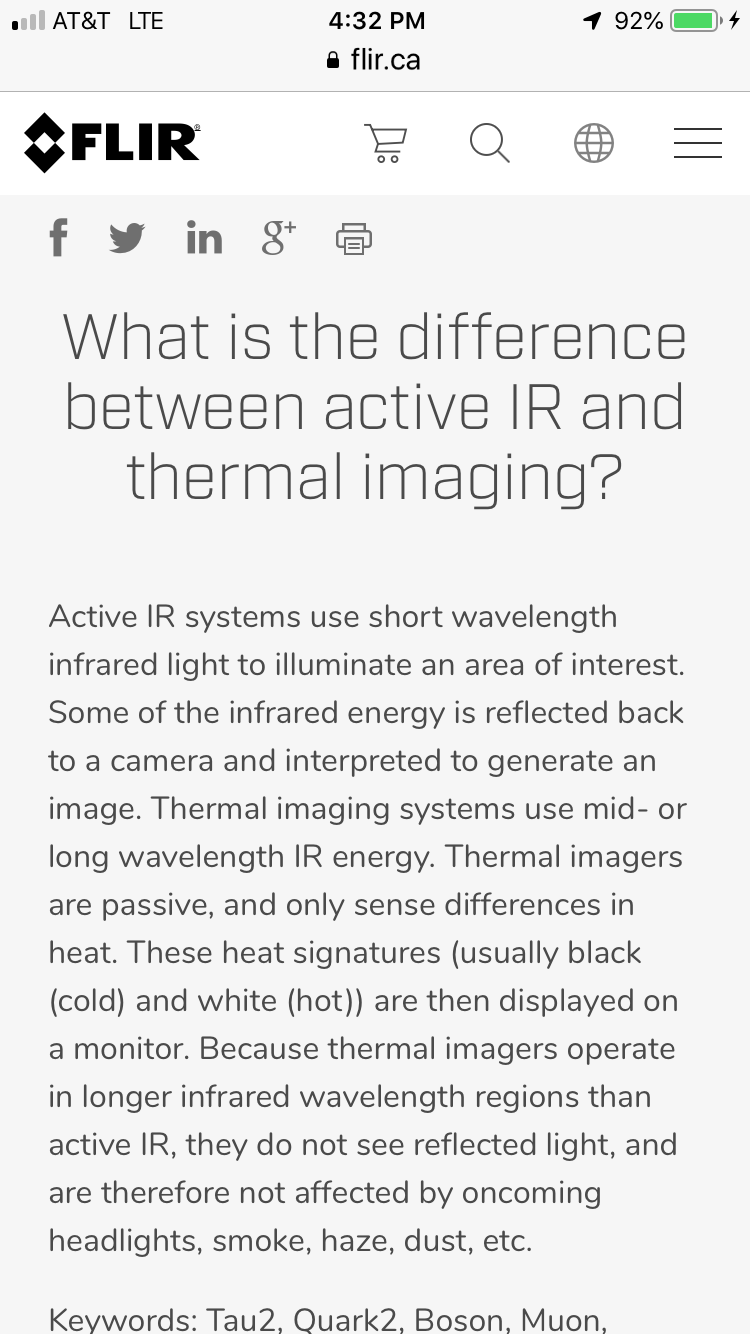

He was being a dick bag and attempting to use semantics. Apparently because I said “IR” instead of “thermal” he got all typery snipery and decided to make an issue of it.
Well, Thermal is measuring IR. Just a different wavelength than what he was thinking. :)
"A thermal imager is a non-contact temperature measurement device. Thermal Imagers detect the infrared energy emitted, transmitted or reflected by all materials -- at temperatures above absolute zero, (0°Kelvin)-- and converts the energy factor into a temperature reading or thermogram."
I actually do most of my scanning and shooting in black hot. I don't see white hot as preserving my night vision better because either way, once compromised, I am using my other eye for night vision anyway. Sometimes, in certain conditions, white hot works better, especially for picking up difficult to see targets. As TheHorta noted, black hot looks more natural. It looks more like B&W TV used to look. When it comes to hog hunting, I see a lot more black hogs than white hogs, so black hot looks much more realistic.
