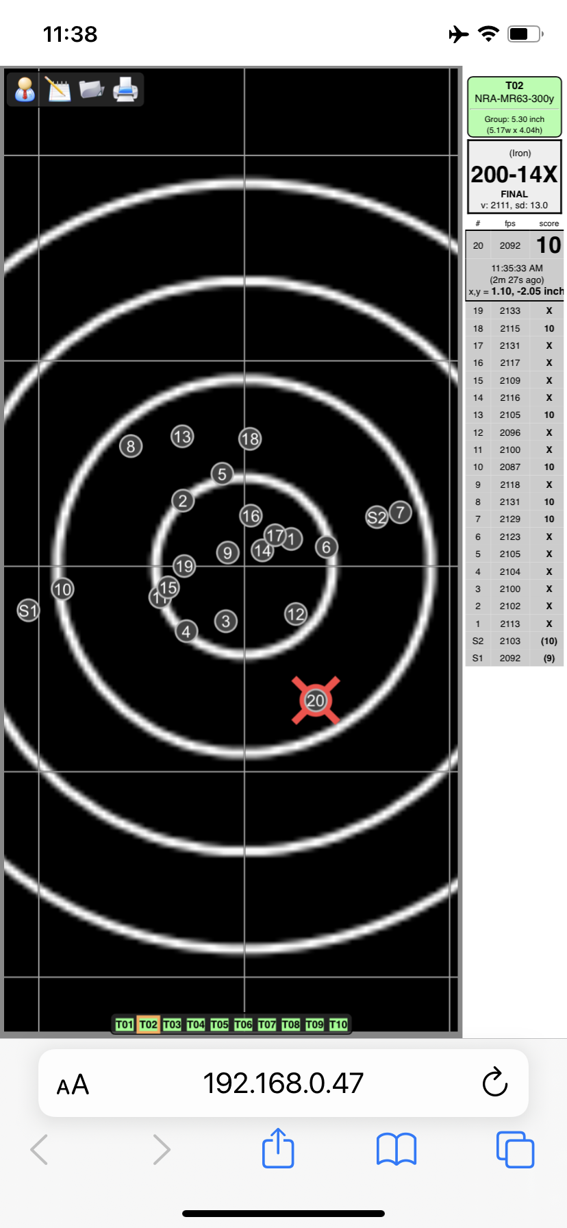

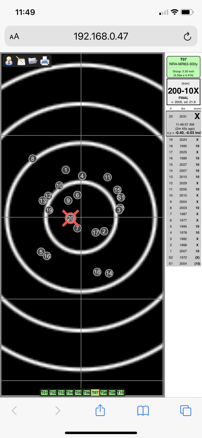

These were fired with SMK77 prone slow fire at reduced 600 yd target at 300 yards sling shooter here, it s a fairly tight x ring. The barrel was a WOA Shillen 7.5R 20" service rifle with Wylde chamber, well over 4000 rounds. I was still cleaning 600 full course target also with the 80.5 Berger this summer at Perry before I pulled it. WOA is my go to for service rifle tubes. C/Lake is great too. Button barrels I pull at about 3000-3500 max but this one kept going.
