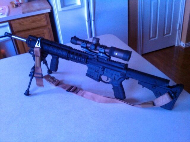

My "go to" AR is a frankengun that I built in 2009-10 with a White Oak 18" SPR with Rifle Gas. I use a 1:7 twist, not the 1:8 and it absolutely loves Black Hills Match 77-Gr.
Rifle shoots an honest 1" at 100 without cherry picking the 1/2" and 3/4" groups. I know there must have been a stovepipe or some type of malfunction over the thousands of rounds I've put through it... but I just can't remember when. I've taken 3 Carbine classes with it and the only time that it malfunctioned was when we were forcing it to for clearing drills.
I have several ARs and AR VAriants but if I need something that I have 100% confidence in to go "bang" and put rounds where I want them regardless of situation; this is the one I grab.
