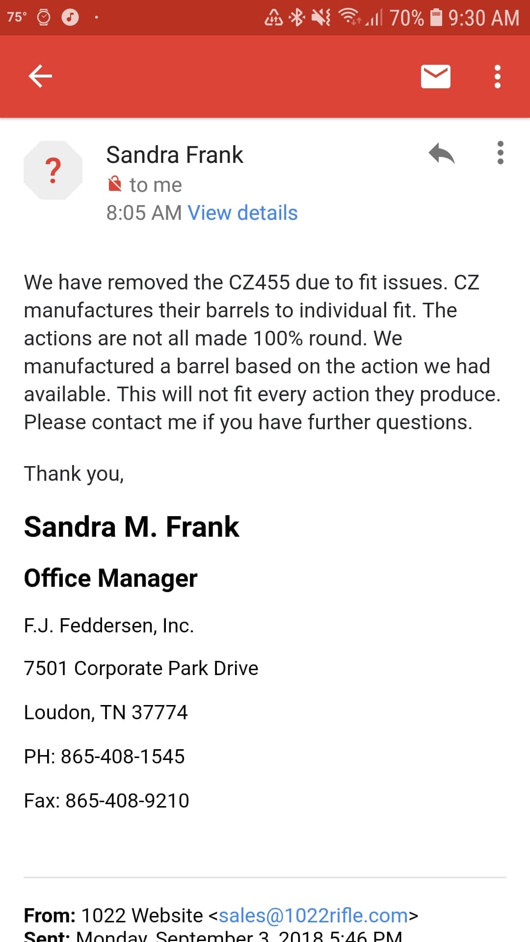

Fedderson no longer makes barrels for CZ 455. :(
I was wondering that myself. Did you happen to call and talk to them?
yes
