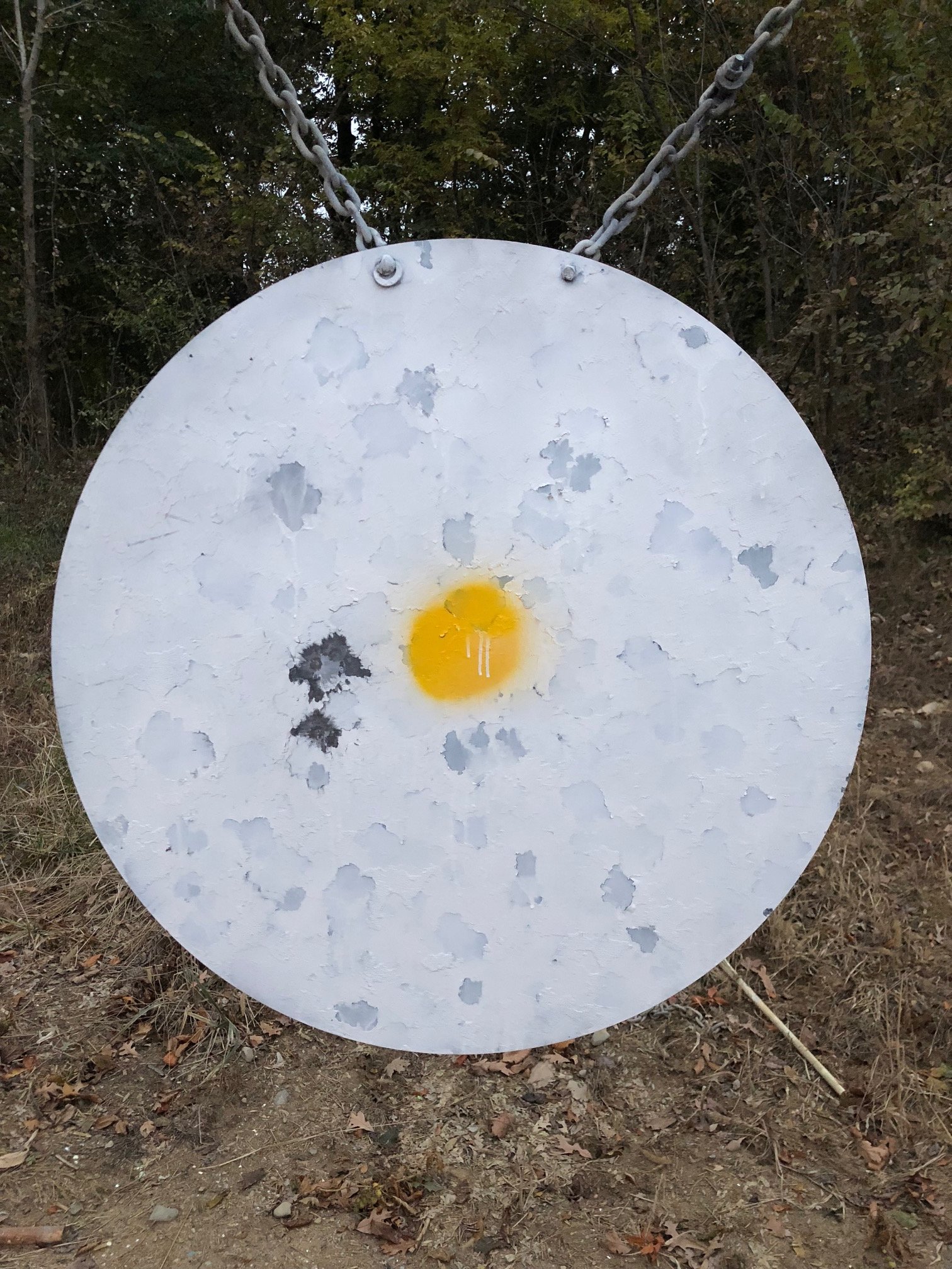

Go with PVA this is my 1k group with my hand load

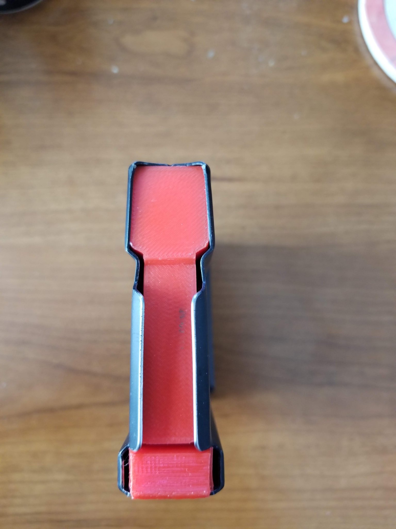

what is a binder plate
It's an extra plate on the inside of the front of the magazine, at the seam where the magazine is welded together. It reduced the room for long cartridges inside the magazine by a fairly substantial amount. The intended purpose of it is to make the magazine more durable, but I personally haven't seen or heard of magazines without binder plates failing at the weld before.
images
You can see it at the front of the magazine there, the rectangular piece up against the front of the magazine between the mag body and the follower. It's just a piece of metal that runs the entire length of the magazine, meaning you can't run as long of bullets inside the magazine because the binder plate takes up space.
There's a photo of the magazine I use most often, which is an AICS pattern magazine with no binder plate (made by Accurate Mag). As you can see my follower in the spacer kit I use is able to go all the way up to the magazine body since I don't have a binder plate in this magazine.
