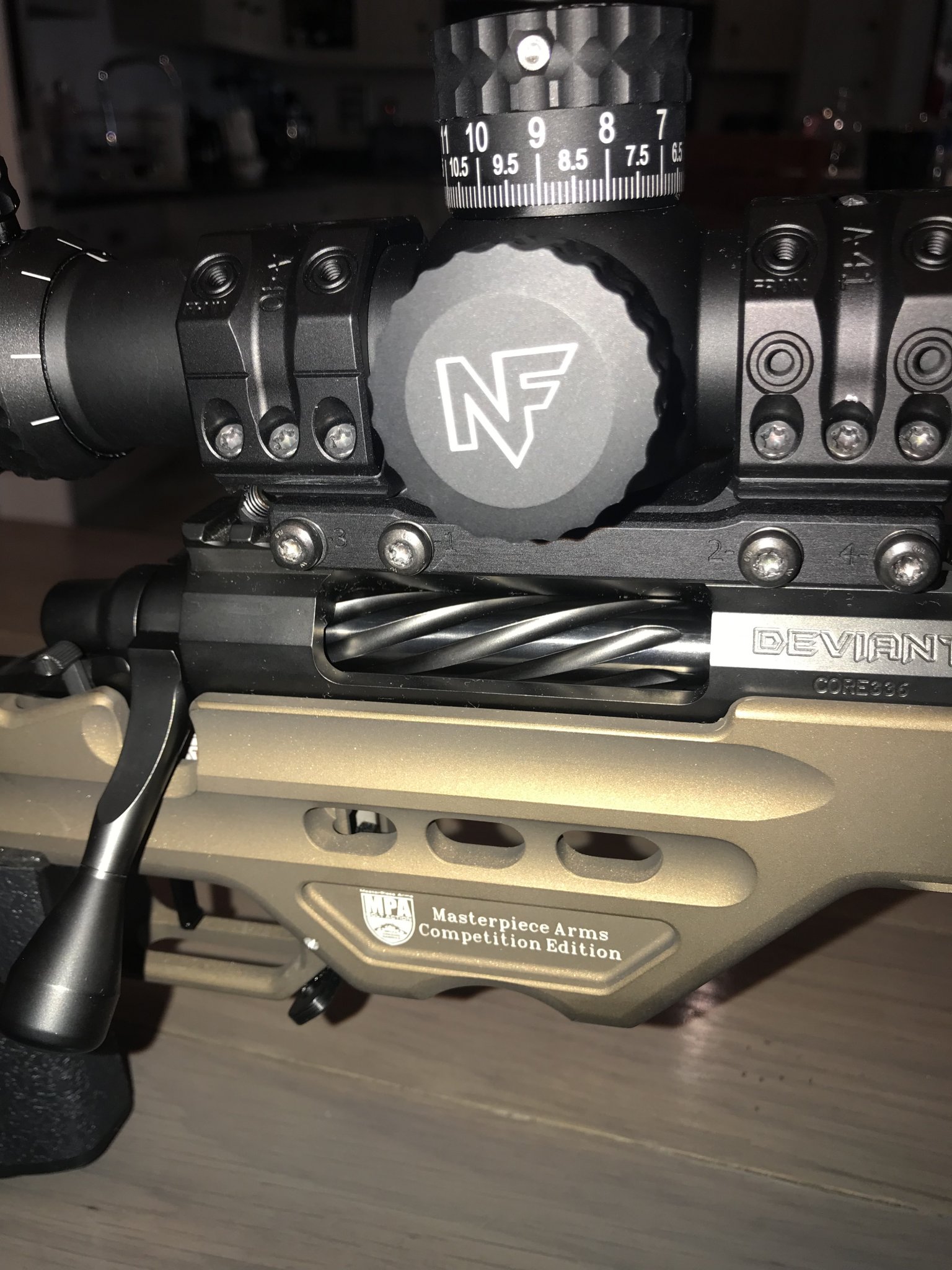

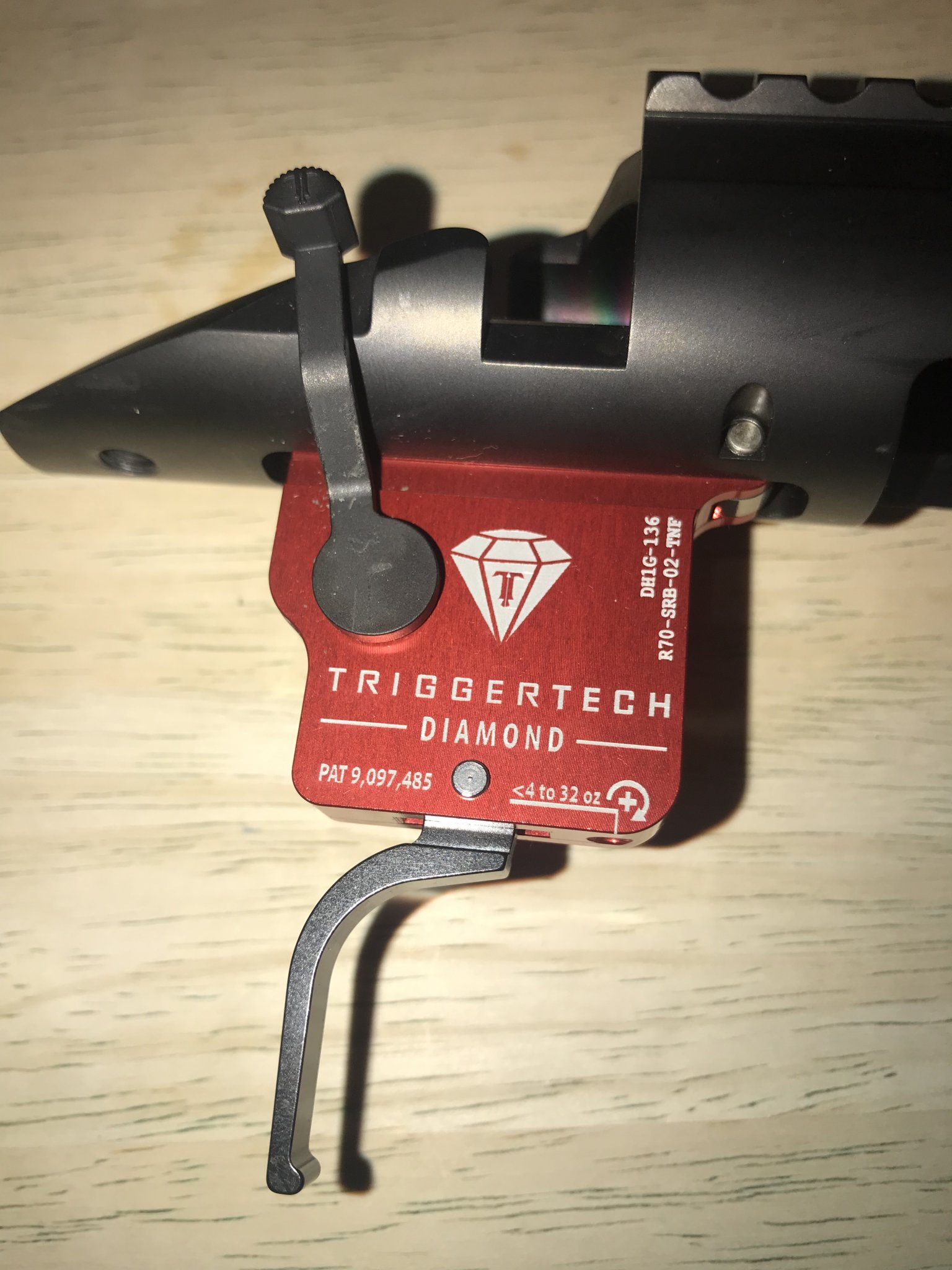

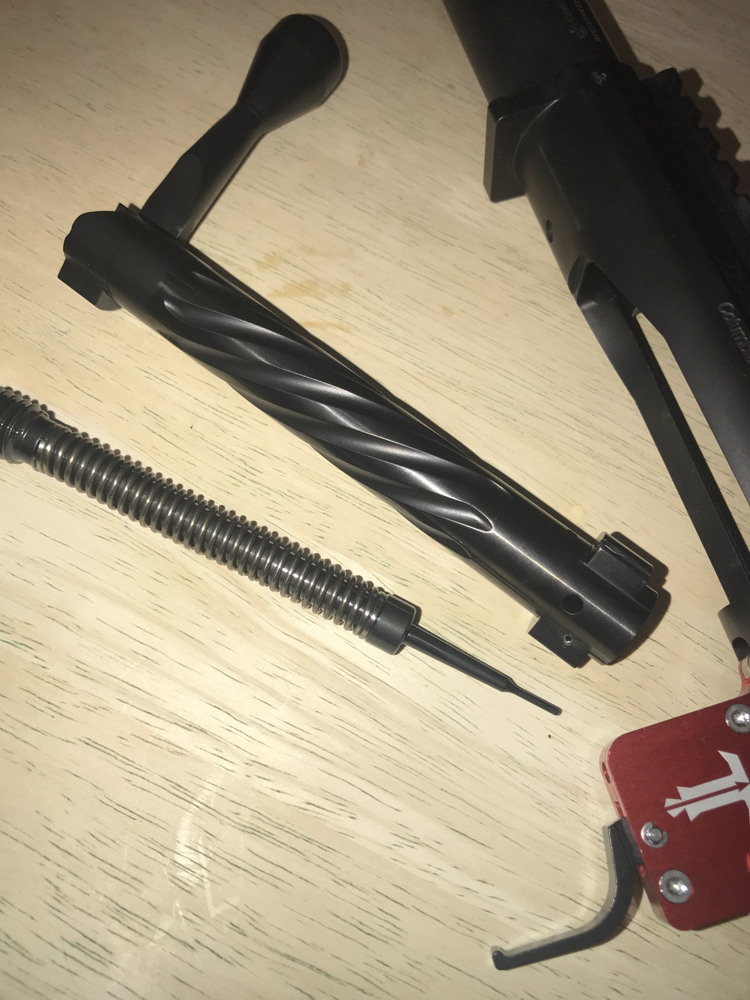

    Exactly. Mine was also done by Defiance. Holding up well and I would do the same again next time. Very happy with it.
