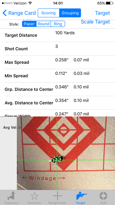

I've had good luck with mine. I only have the one cherry picked group picture but It's a sub moa shooter. 20170909_180333_resized.jpg

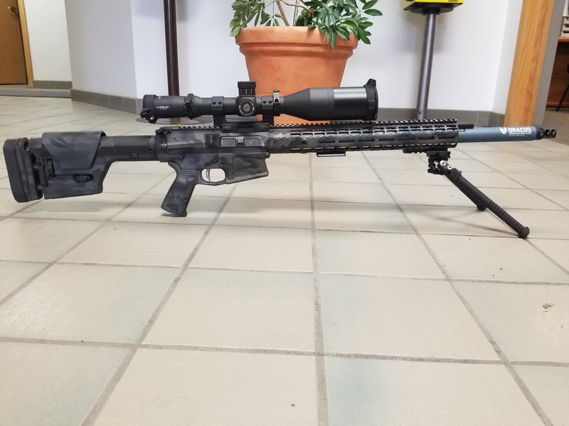

M110 SASS clone using Aero upper and lower. When I built this, Aero was using ER Shaw barrels. They now use Ballistic Advantage, whom the own. 1 MOA out of this gun, under $1000 to build.

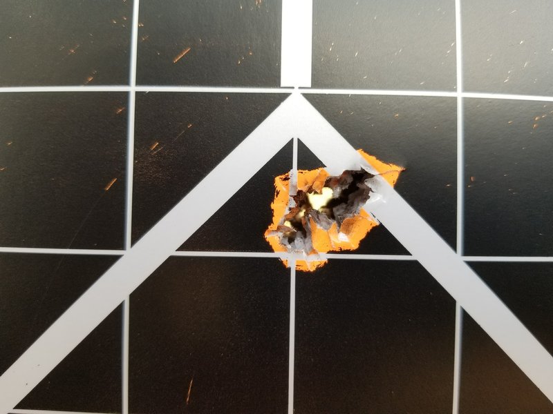

I did a 6.5cm on an aero upper and lower with a 22" bartlein barrel and this is with 130gr Berger ar hybrid

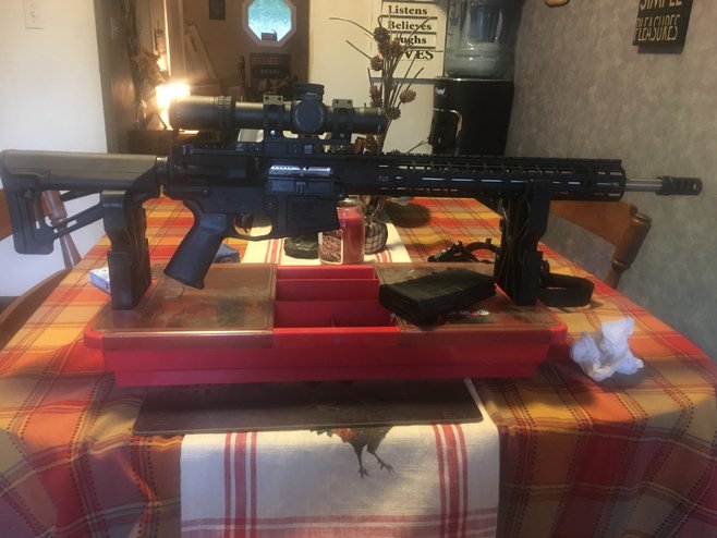

M5e1 upper and lower
M5e1 mlock handgaurd
Jp 18” light contour 308 barrel with rifle length gas system
Jp silent capture spring
Jp low mass bolt carrier
pws buffer tube
Giessle ssa e trigger
apa lil bastard brake
magpul furniture
slr sentry 7 adj gas block
trijicon 1-8x28 accupower
ad mount
have only fires one group and it put 4 shots touching and the 5th was still under 1 moa.
I couldnt be more happy on how it shoots.
