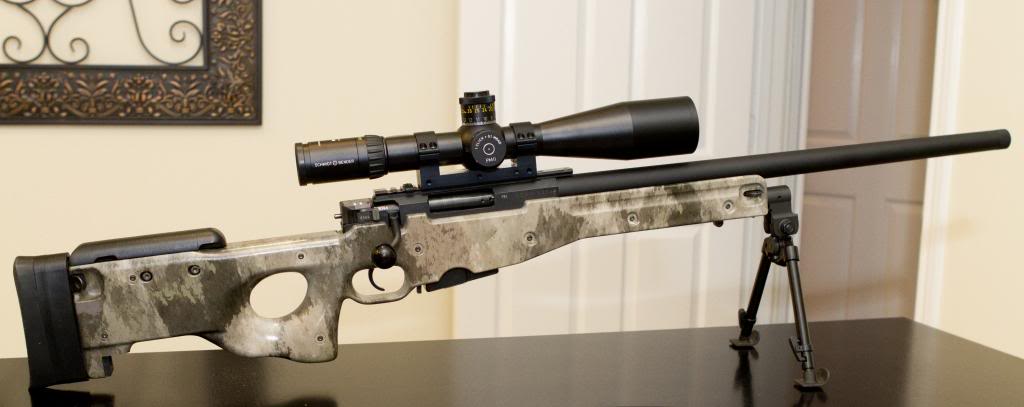

    Stiller Tac30 AW in southpaw
    Kreiger barrel chambered in 243 win, 1:8, MTU contour, 24" 5R rifling
    Stiller BDM
    Manners T4A, painted Multicam by Todd(usgunworks on snipers hide)
    Nightforce 5.5x22 MOAR
    All gunsmith and cerakoting work down by Scott Weichel of Live Oak Accuracy
