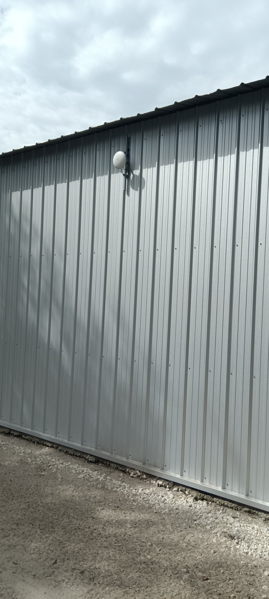

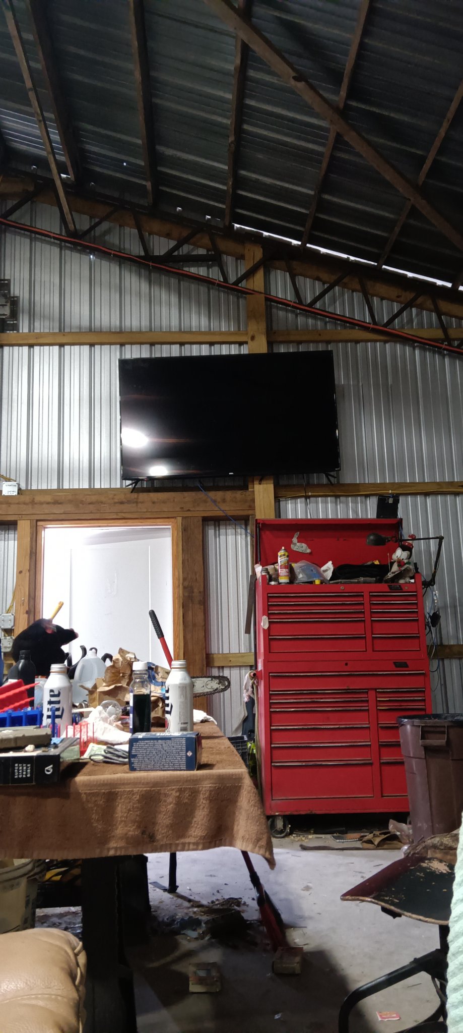

    We had ours put up about 6 months ago and I got them from Amazon and they were almost 200.
    I'm not very fluent w computer so I don't remember which ones the guy told me to buy, but damn is all I can say.
    We shoot it's ross a non obstructed view to our metal sided barn which acted like a faraday cage.
    Unconditionally works great. I get fast Internet in the barn and hung a 75 inch color tv.
    Life is grand.
    Reactions: Jgunner
    Life is grand.View attachment 8245056View attachment 8245057
    Yep that is the NanoBeam AC Gen2 and they are excellent. We use them for applications where we need more throughput. Amazon charges more than anyone else.. They are $99 direct from the Ubiquiti
