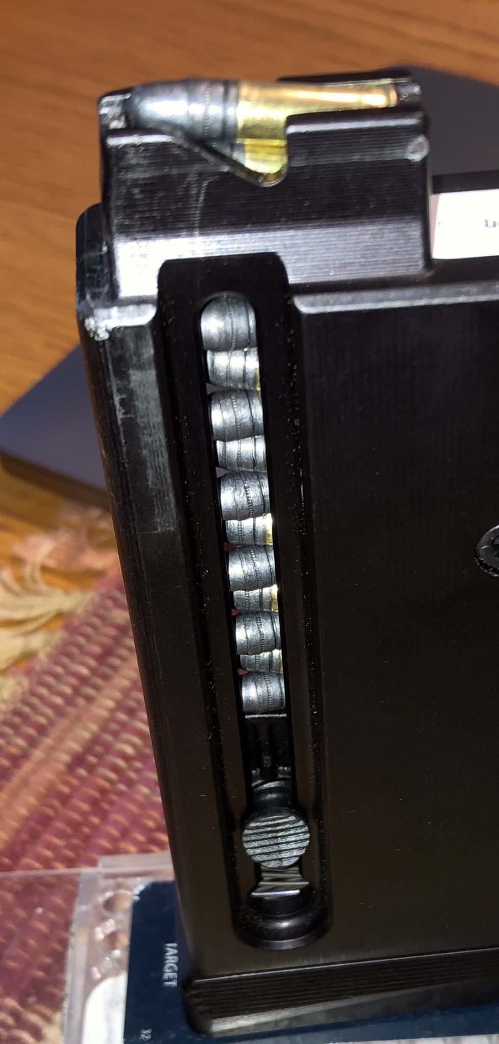

That's interesting (discontinue / redesign). I have two 15-rounders. Early on, I had quite a but of trouble with misfeeds - cartridge simply would not strip out of the mag and bolt stopped cold. I was very confident rim-lock wasn't the issue.
What I finally learned is the cartridges MUST stack in the mag with the noses staggered as shown in the photo. If two catridges stack with the bullets NOT staggered as shown - top round of the unstaggered pair will present nose-down to the bolt, which then pushes the round into the front of the mag and bolt ain't'a'gonna close.
My polymer 10-rounders will do the same thing if rounds aren't staggered but, for whatever reason, the 10-rounders load properly with less fussiness.
