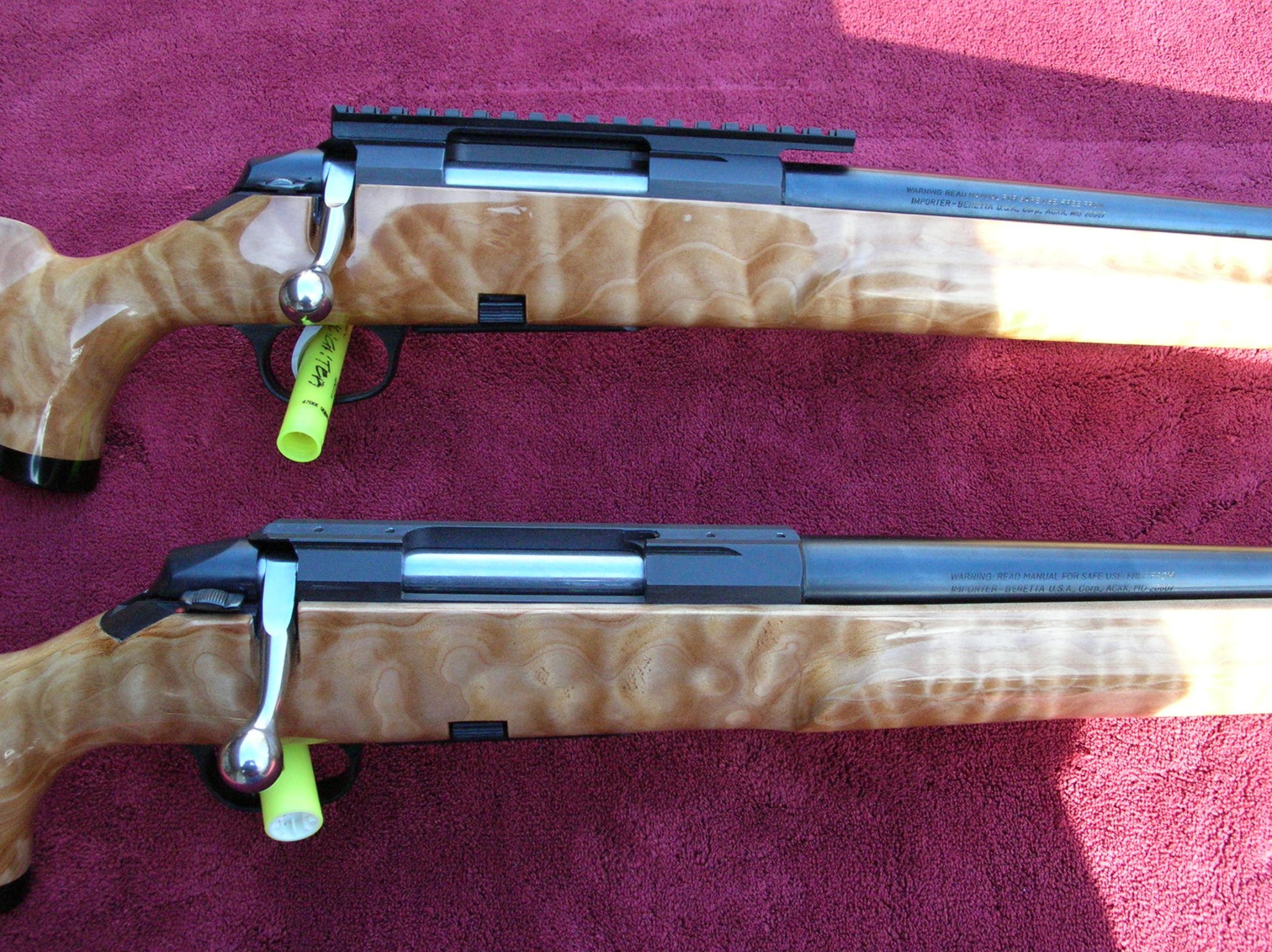

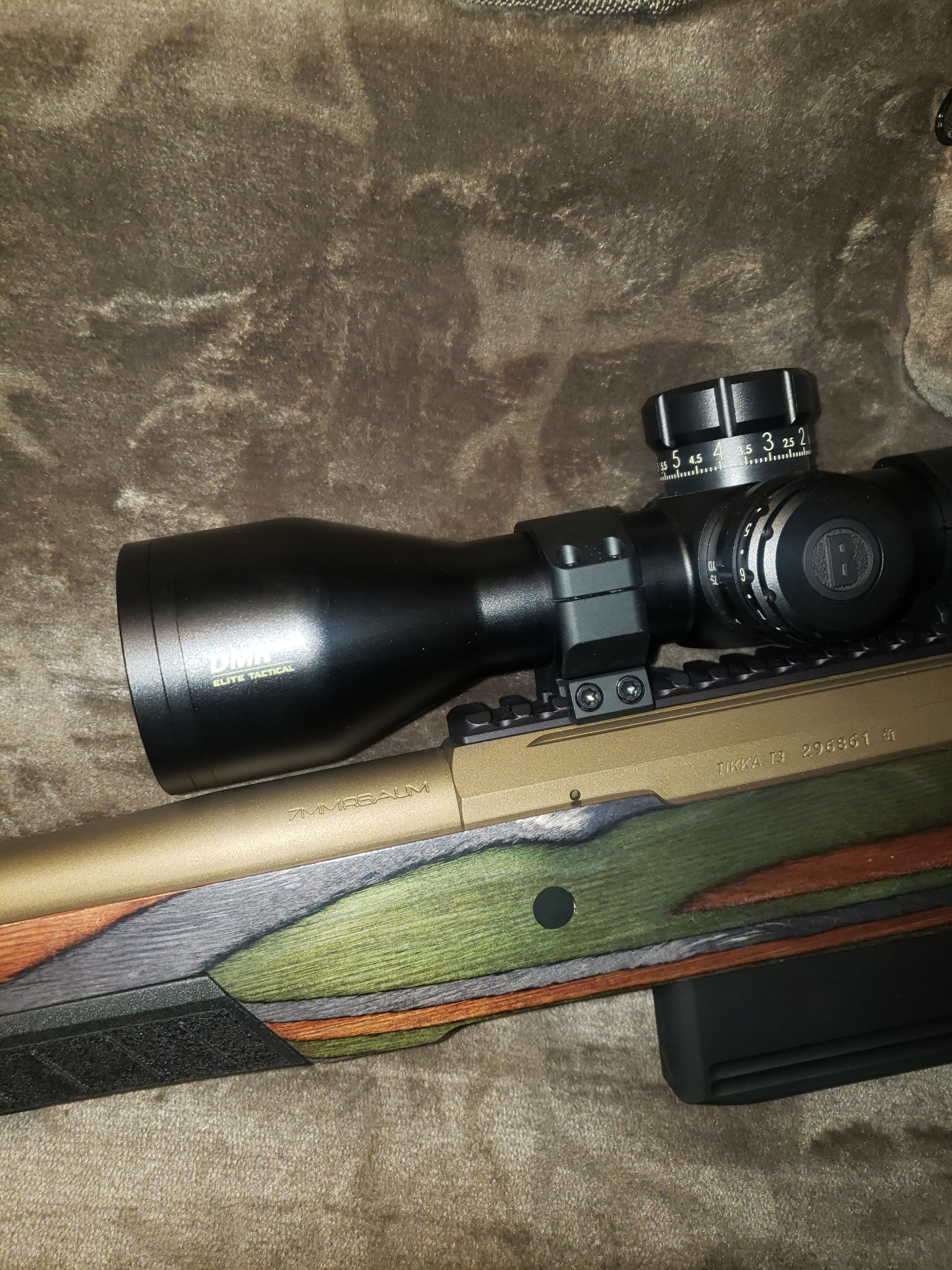

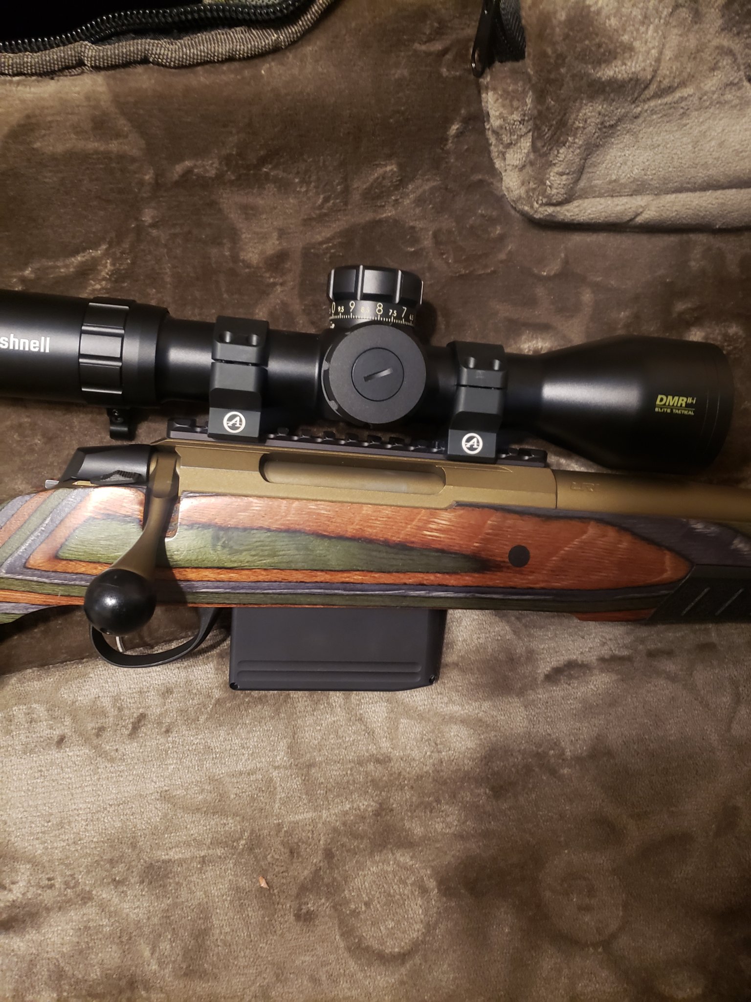

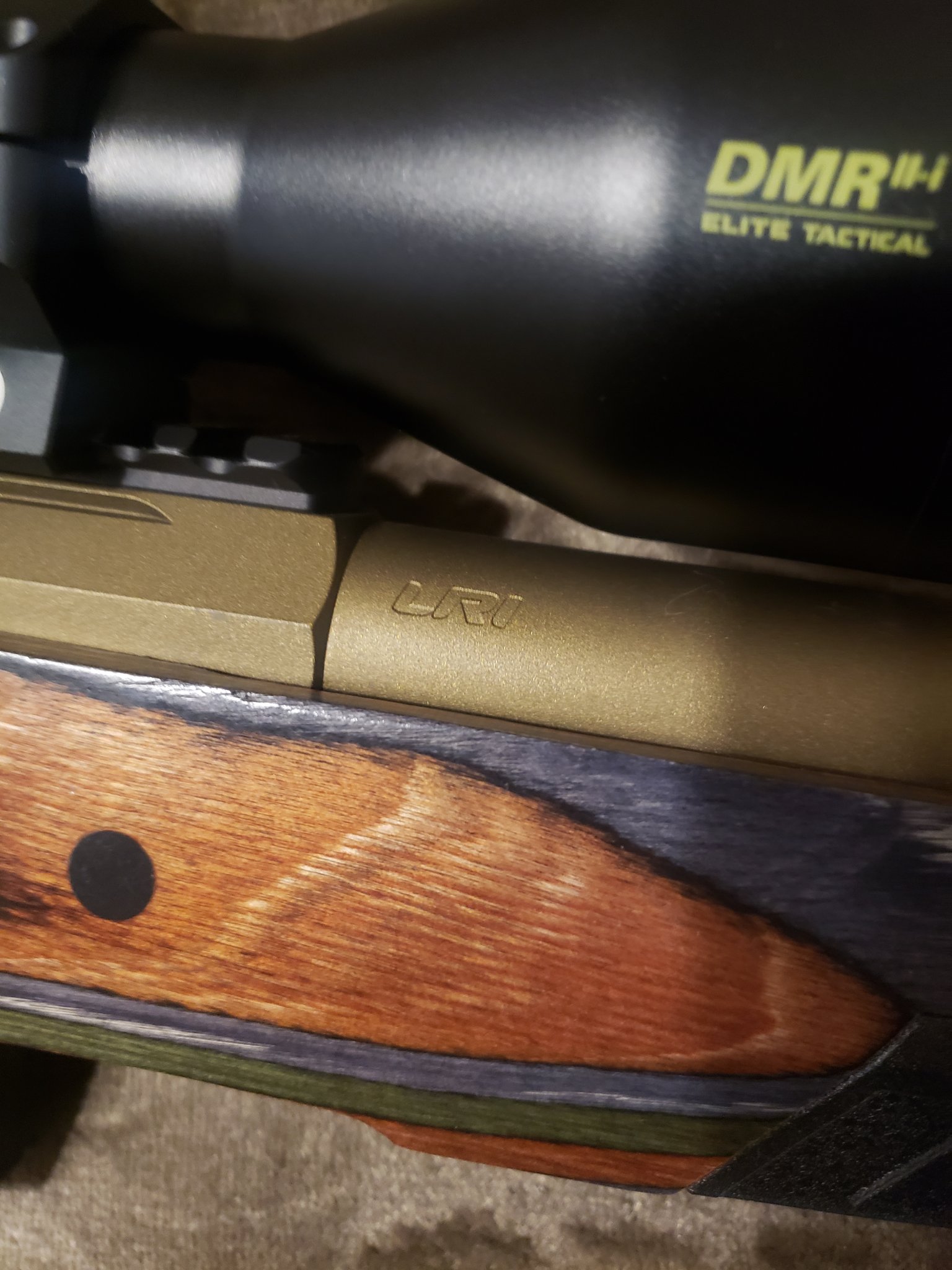

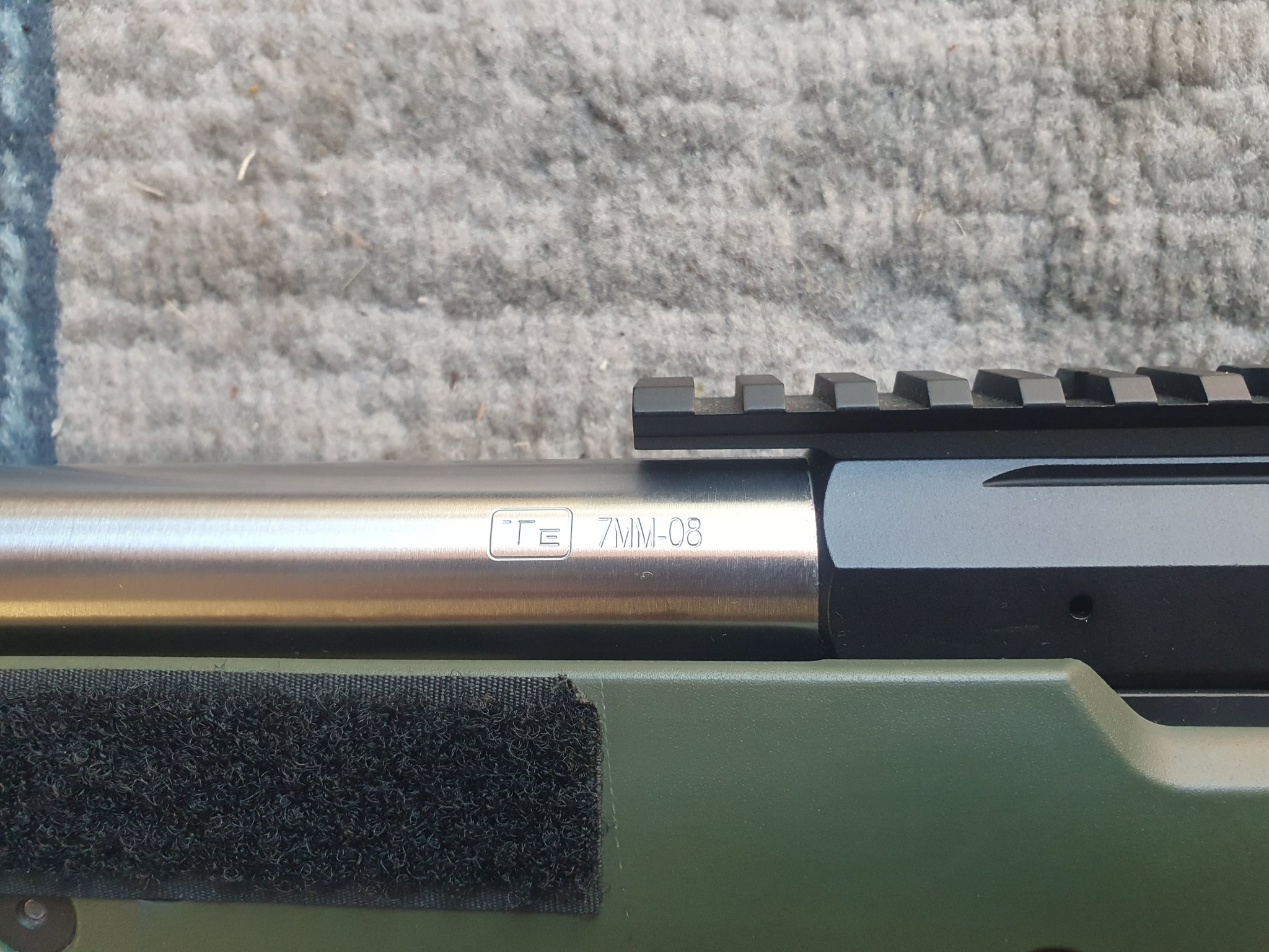

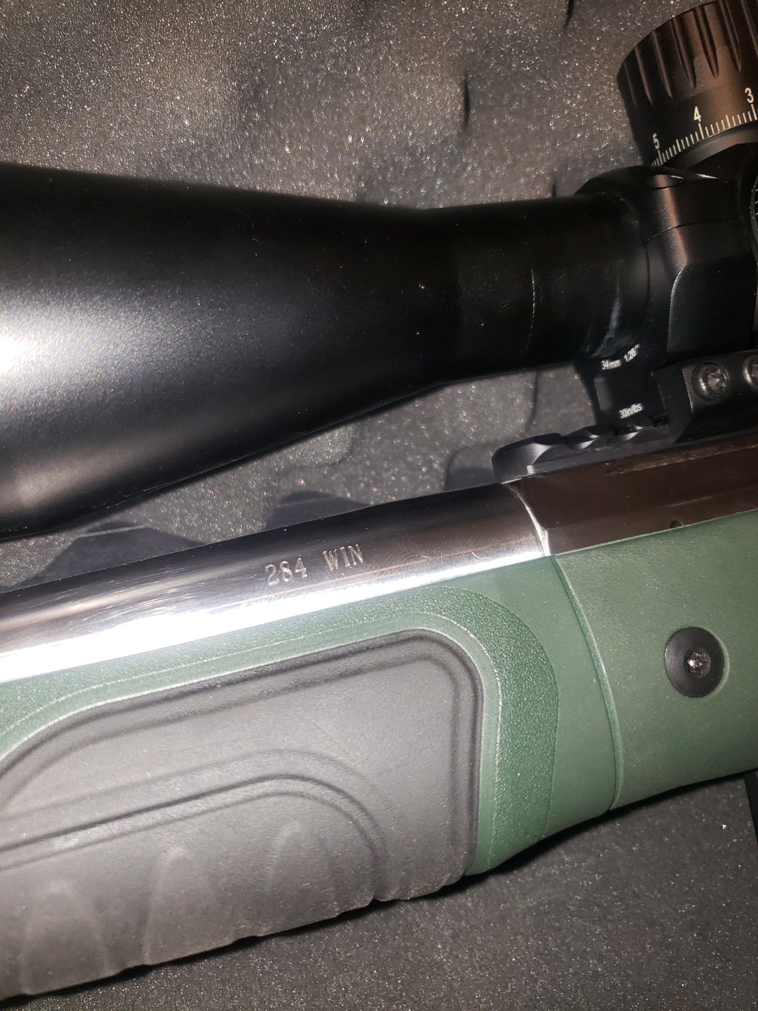

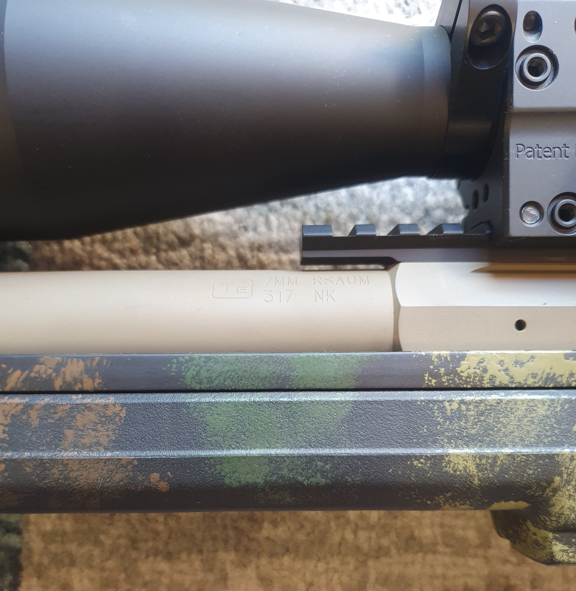

    I've got a few rifles built on Tikka T3 Actions, 7mm-08 and a 7 RSAUM.
    Both have HV profile barrels finished at 26".
    Both actions have the standard bevel and my gunsmith just turns down the shank to the same as factory.
    No complaints with either and both look fine.
    I'll take a couple of pics later and post here.

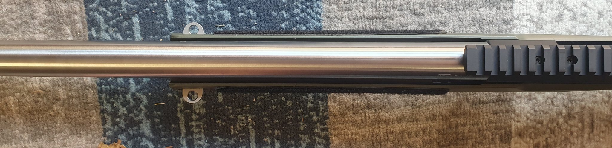

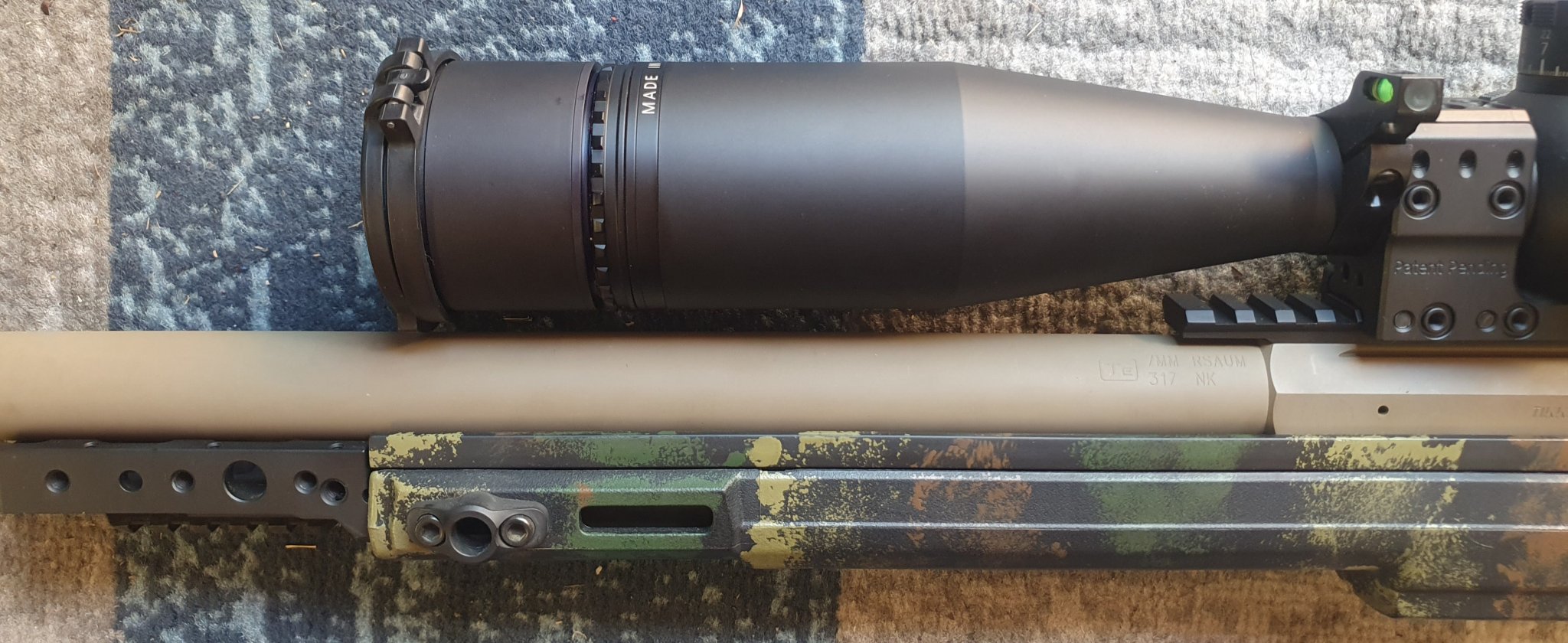

    Maybe, on most chassis and one stock I havnt had any issues with 1.25 tennons. Specifically an mdt acc and mannners t6a and eh1. Honestly when I spec a tikka stock now I make sure they cut the barrel channel for 1.25” tennon spec just to keep it more flexible for barrels.

    Yes. I’m just pointing out that the ‘trench” that he referred to in the OP is a non issue as long as it fits the stock. There is zero issues with a larger ten on diameter.
    I’ll even mention that most gunsmiths will turn down a blank to 1.12-1.16” for tikkas for the reason of athletics with the action being slightly smaller.

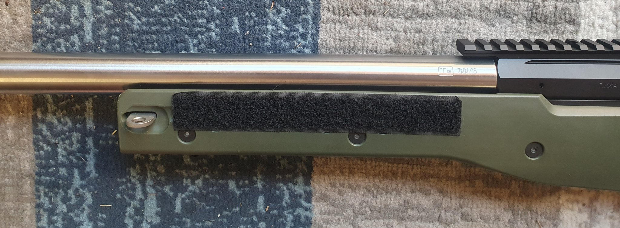

    1.20” is the width, flat to flat, of the action. You’d need a 1.12” to not have any gap at the radius, I have a 1.15”, and I can get a fingernail in. If your smith were to face the action, you could get rid of the radius up to the side flat without removing any significant thread, as they are recessed slightly, but you still have roughly 15 threads…not an issue for accuracy or strength.
