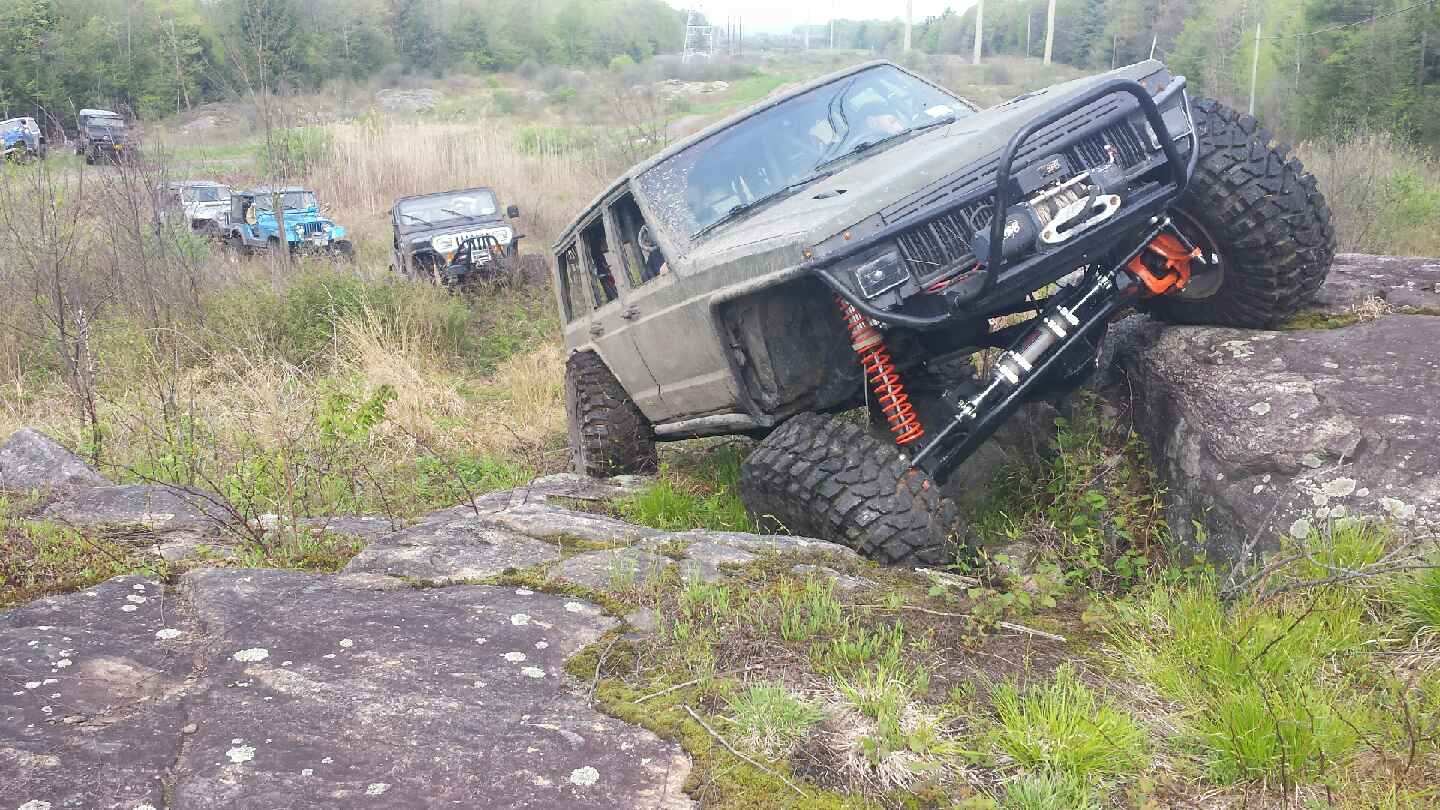

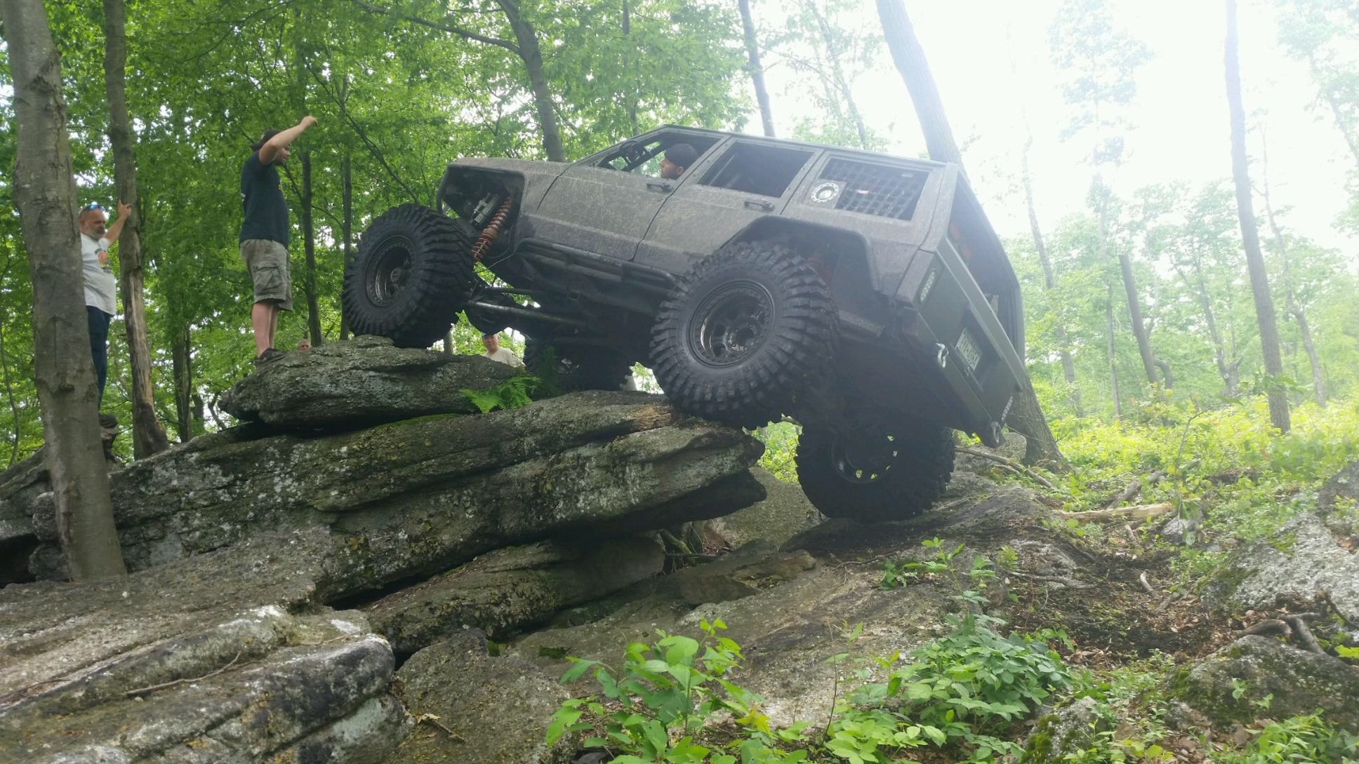

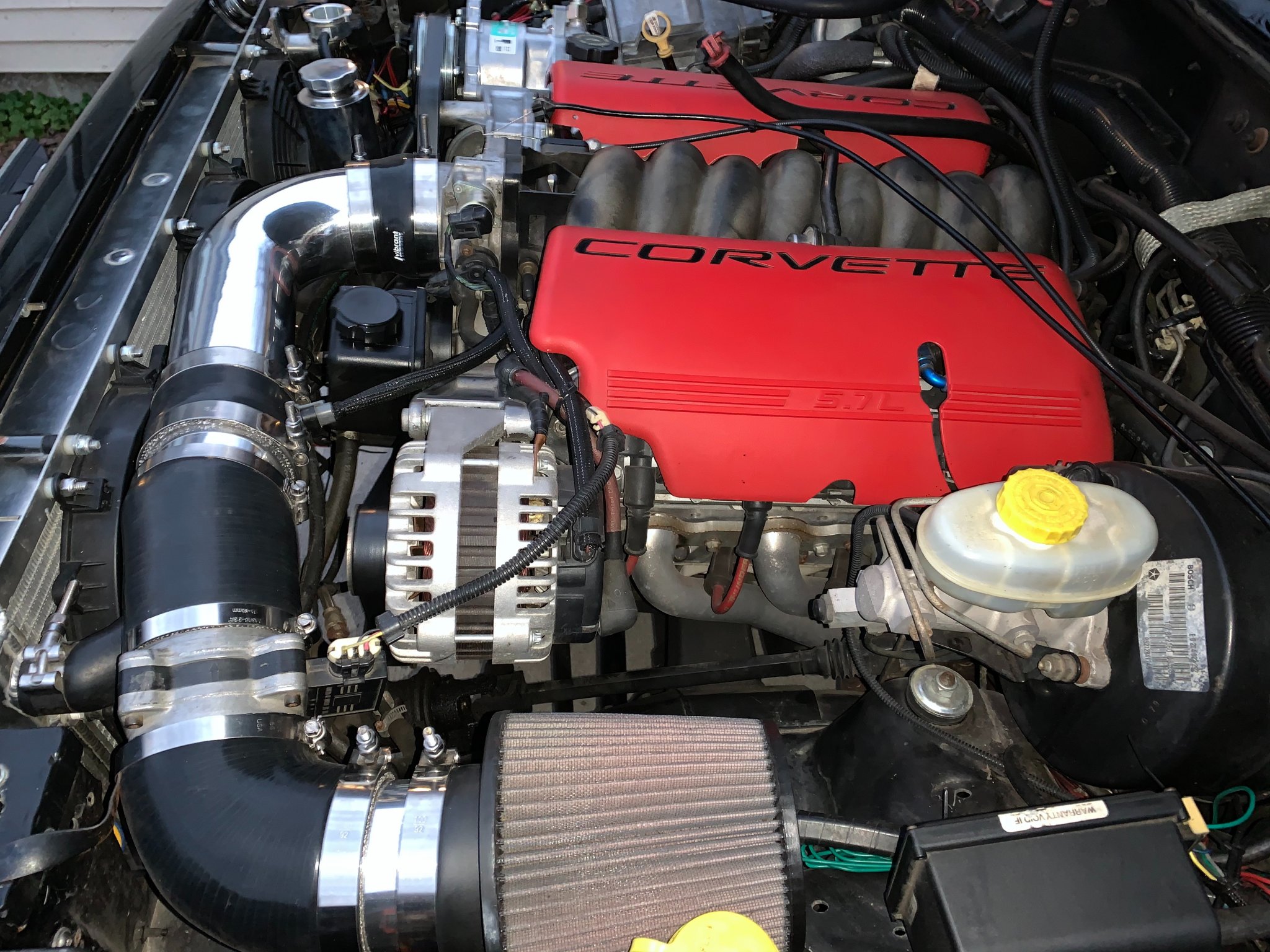

Some time ago, probably 12 years or so, I decided I needed a vehicle better suited to get to campsites, shooting spots, and just having fun. More than the current (at the time) hotrod mustang. So I got a 2001 Jeep XJ and a fistfull of cash for the Cobra. I was happy. I knew up front that the engine was tired, but over all, the Jeep was in great shape. I drove the hell out of it for a few years, then one time heading up the Rockies towards Vail, Colorado while pulling my tiny popup camper, it started to show it's extreme lack of power.
Well. the rest of the trip went alright, and the off roading in Utah was fun, but I started looking into how much I was going to spend freshening up the 4.0 six banger. Turned out, I decided to go a different direction.
I've been a retired mechanic since forever it seems like, and I've always had to work on other peoples stuff, but never had time for my own. It was time for My own hotrod project to get started. Operation (Jeepzilla) as dubbed by my late mother, who basically talked me into doing my own build project.

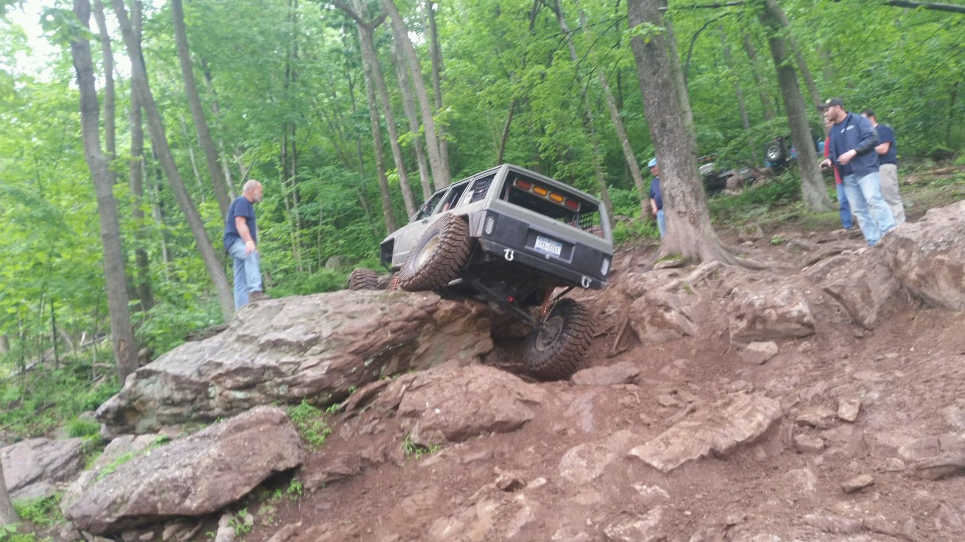

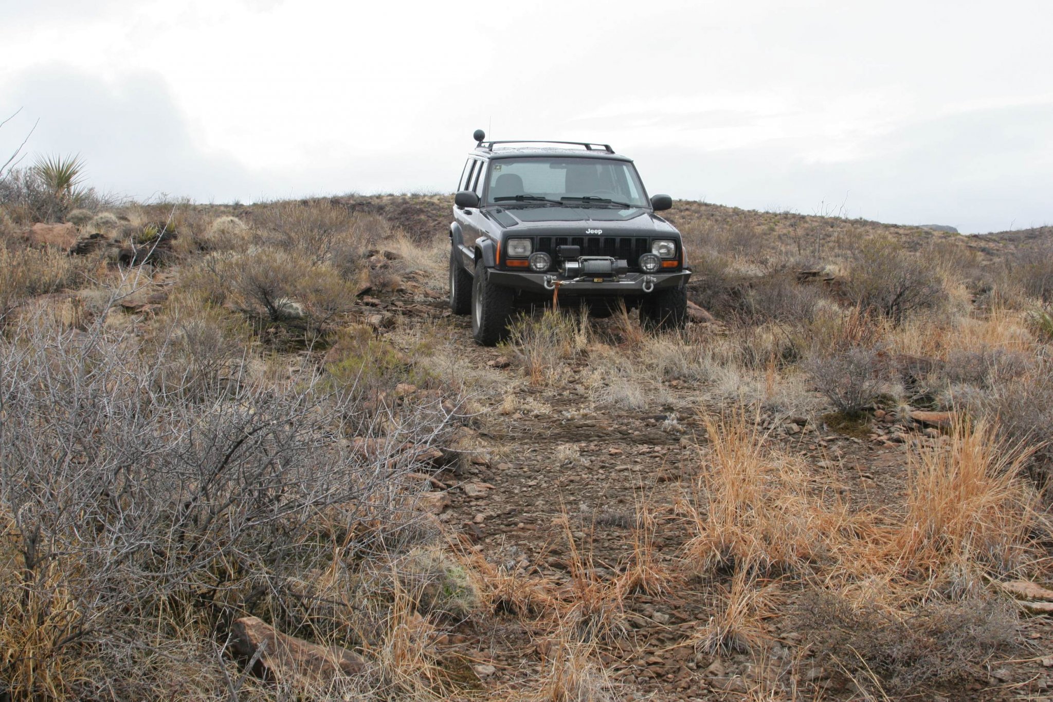

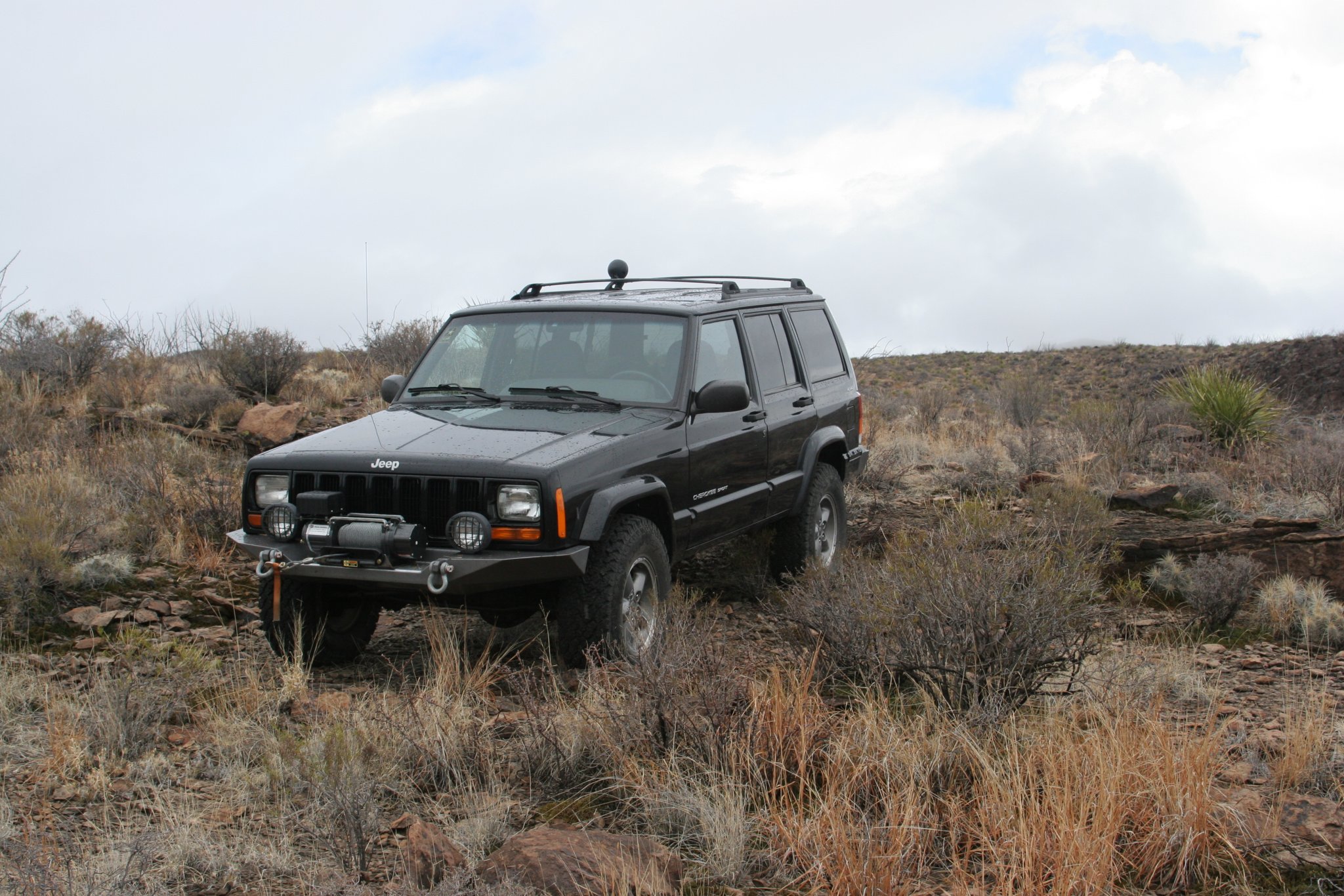

Pics of the little XJ before the work started, having some fun in Big Bend Ranch State Park, Texas. Circa 2010.

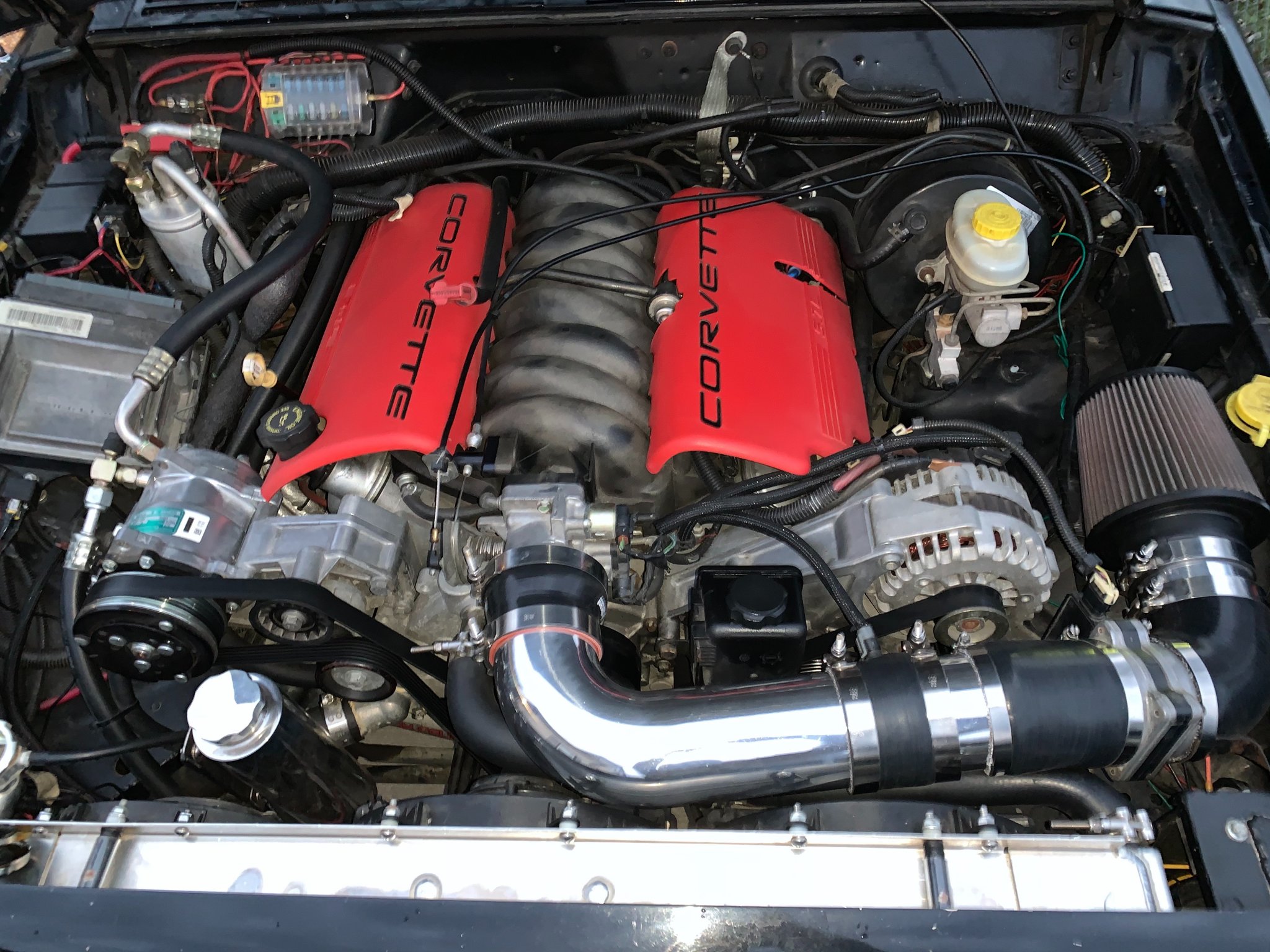

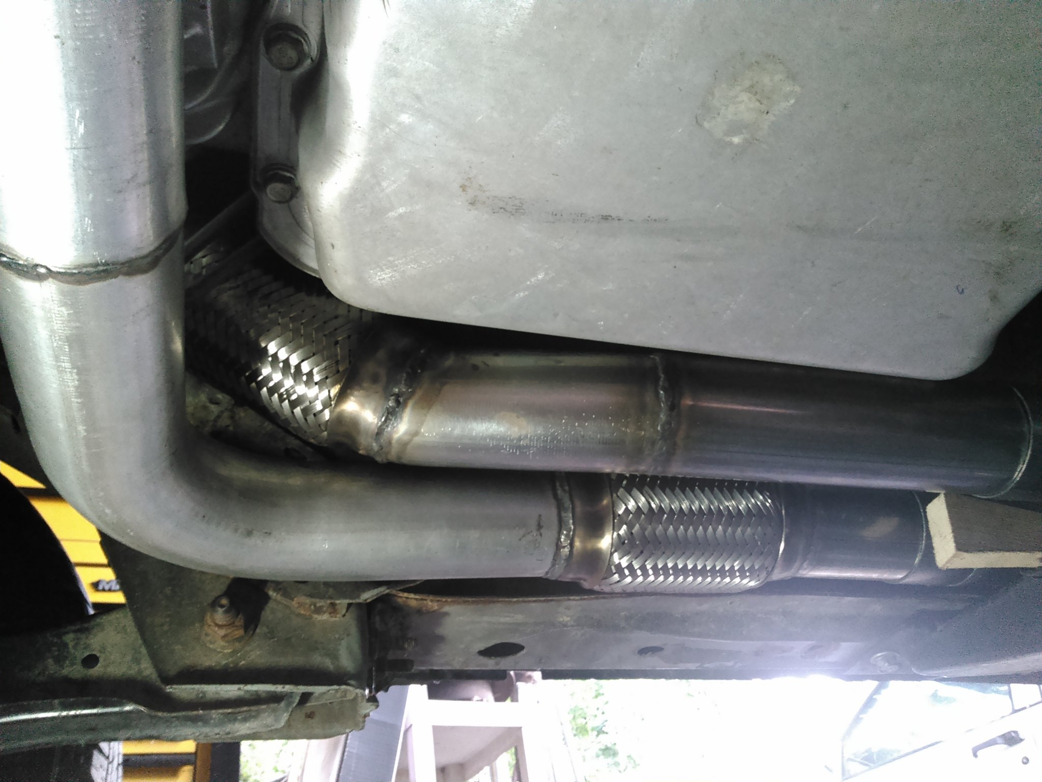

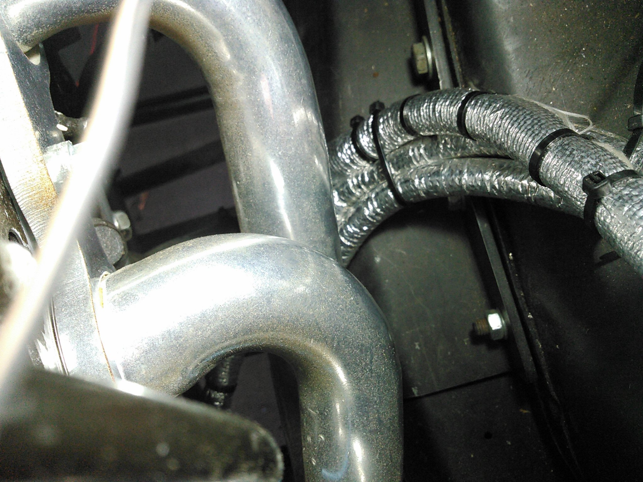

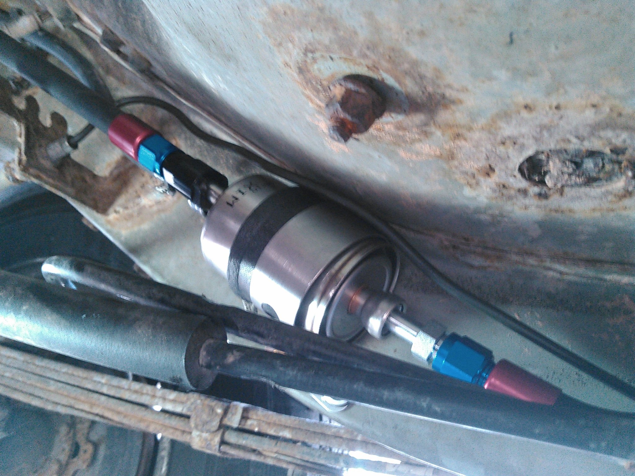

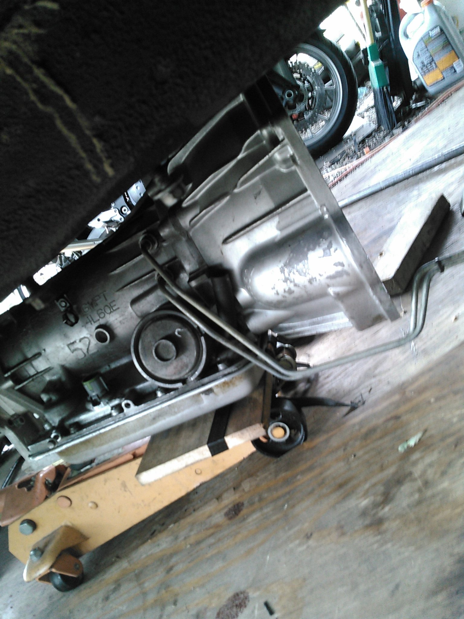

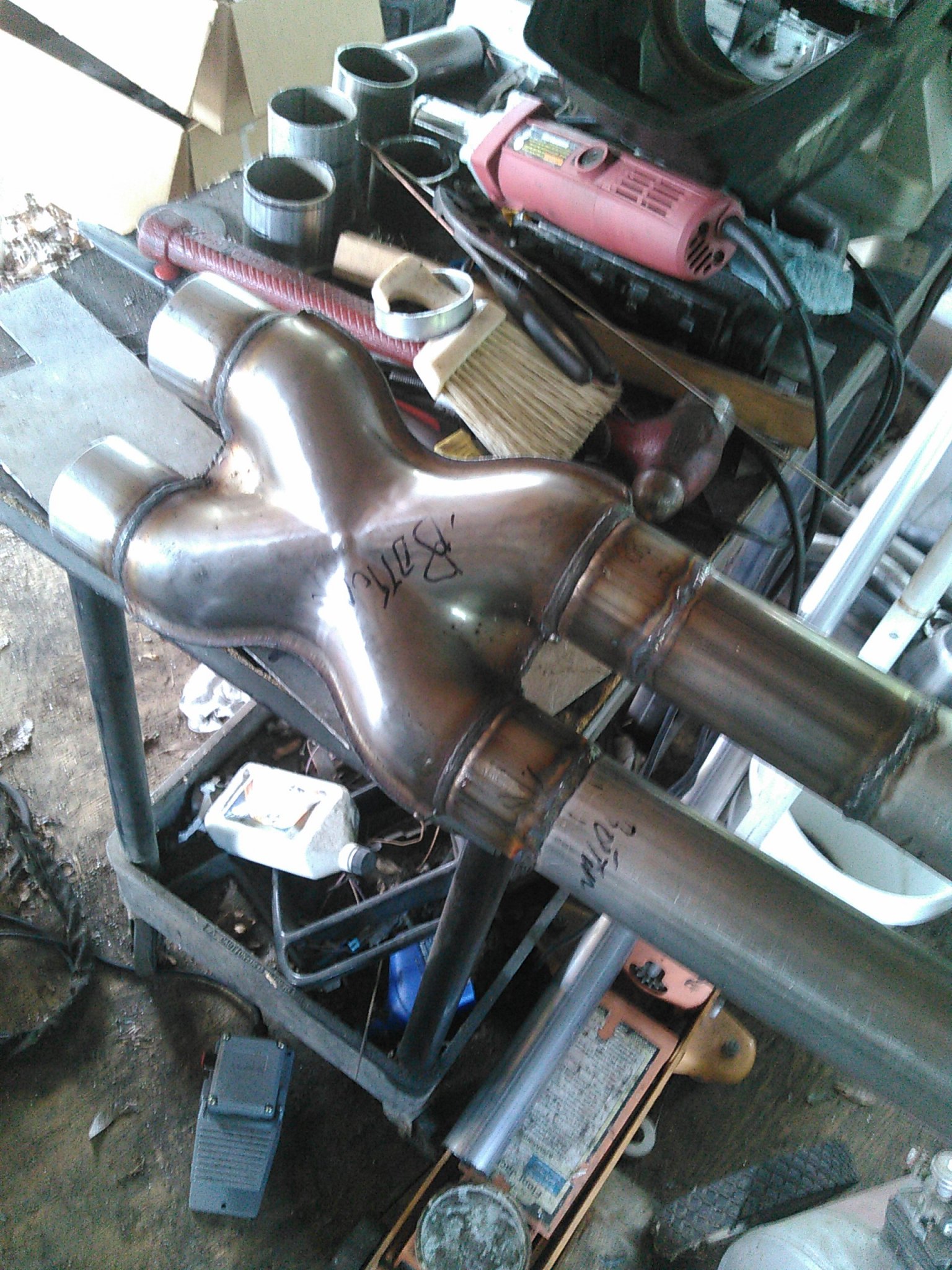

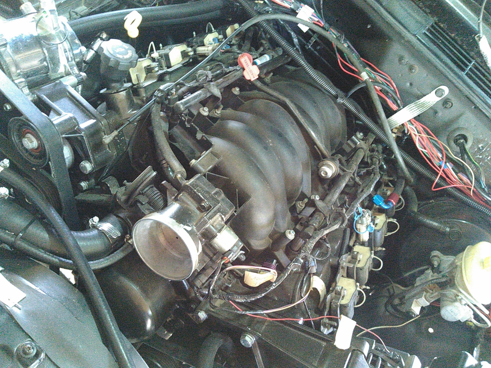

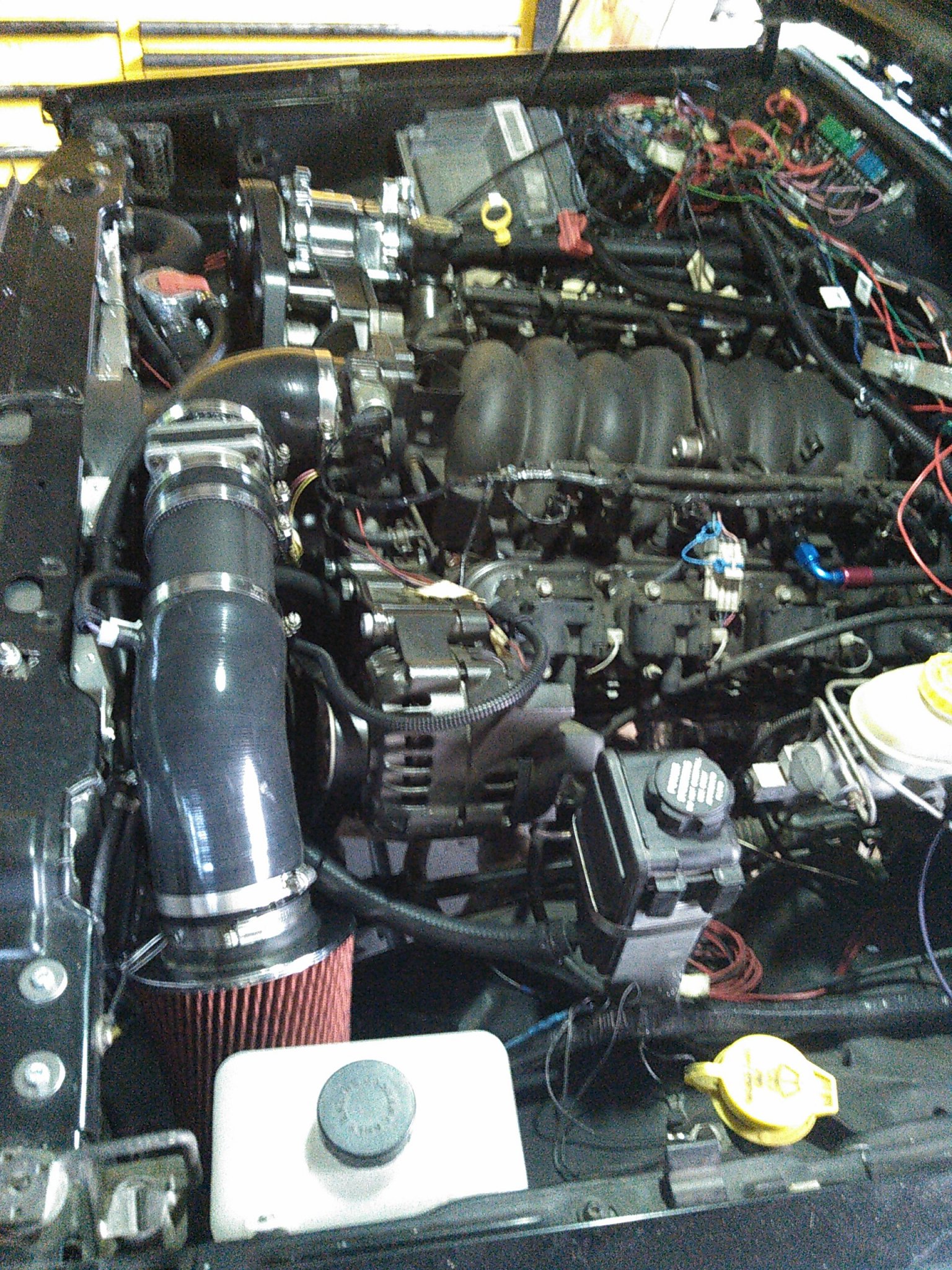

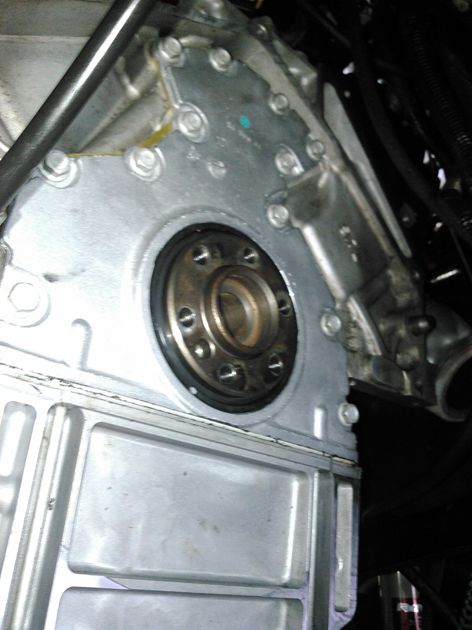

Starting around 2014, I got to sourcing parts, and suppliers. By about May of that year, I had the six banger listed on Craigslist, and it was gone the next day. Lots of folks will tell You they are torque monsters, and while I'll agree they long lasting, and durable little power plants, I strongly disagree about their torque/horsepower numbers. It's just not there. A good running one will put down 190 Lbs Ft of torque at the crank. You'd be lucky to see 150 at the wheels.
My first acquisition was the engine/tranny combo. A 5.7 L LS1 V8 and 4l60E trans out of 2002 Trans Am. Also the wiring harness, and Delphi ECU. Engine mounts and Radiator from NOVAK, and a transfer case adapter from Advance Adapters. On with the build.
Reactions: crackerbrown

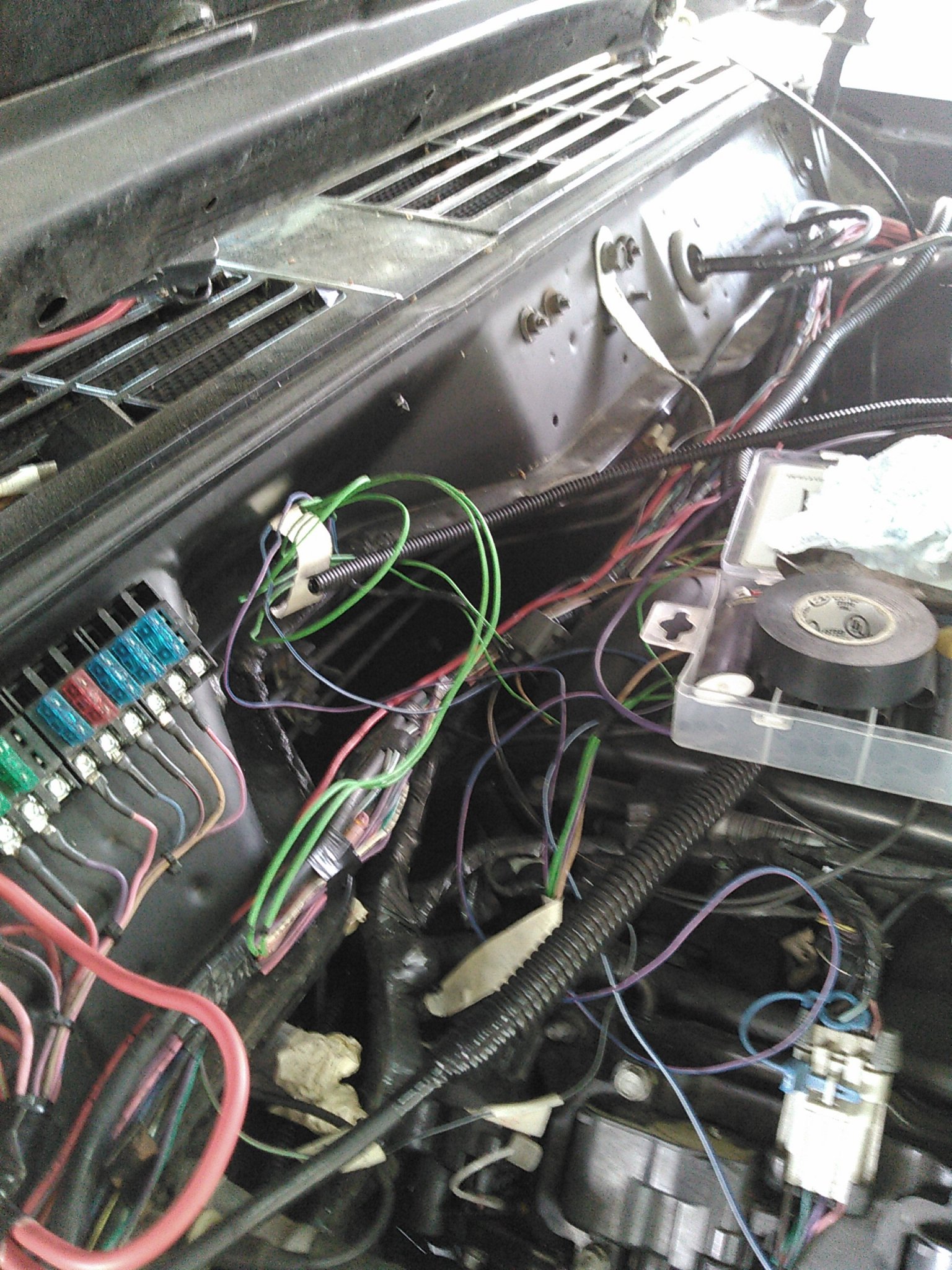

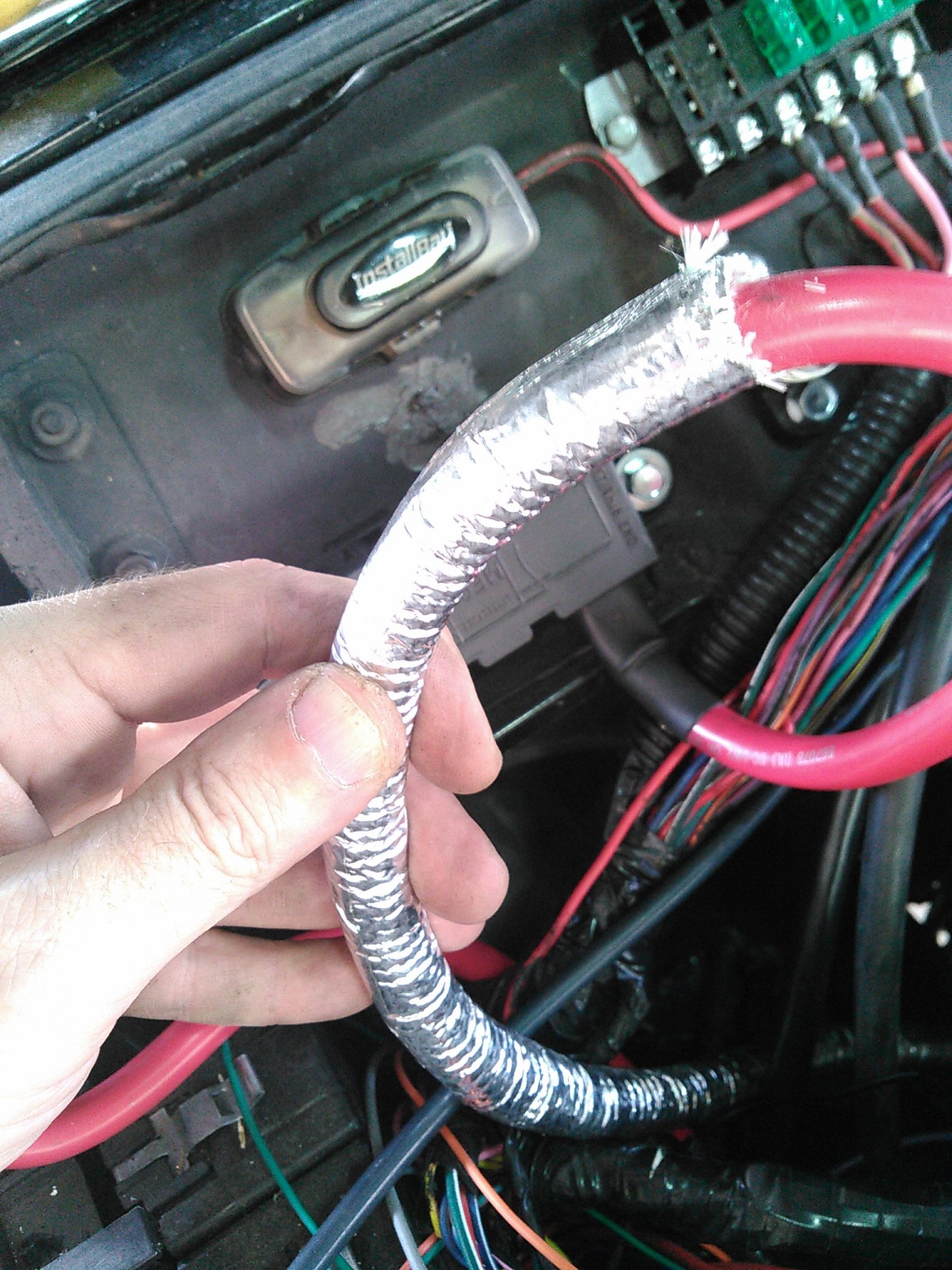

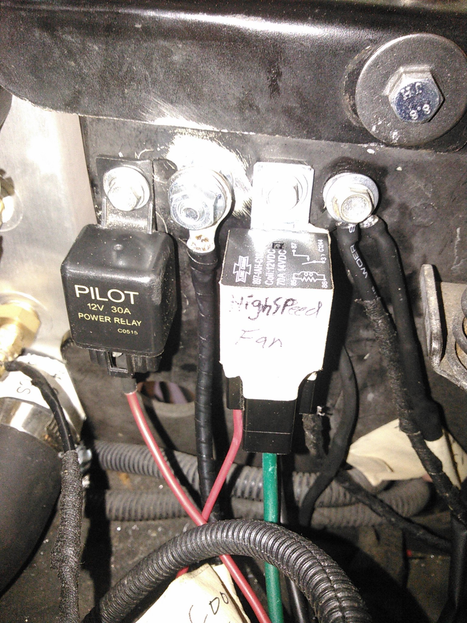

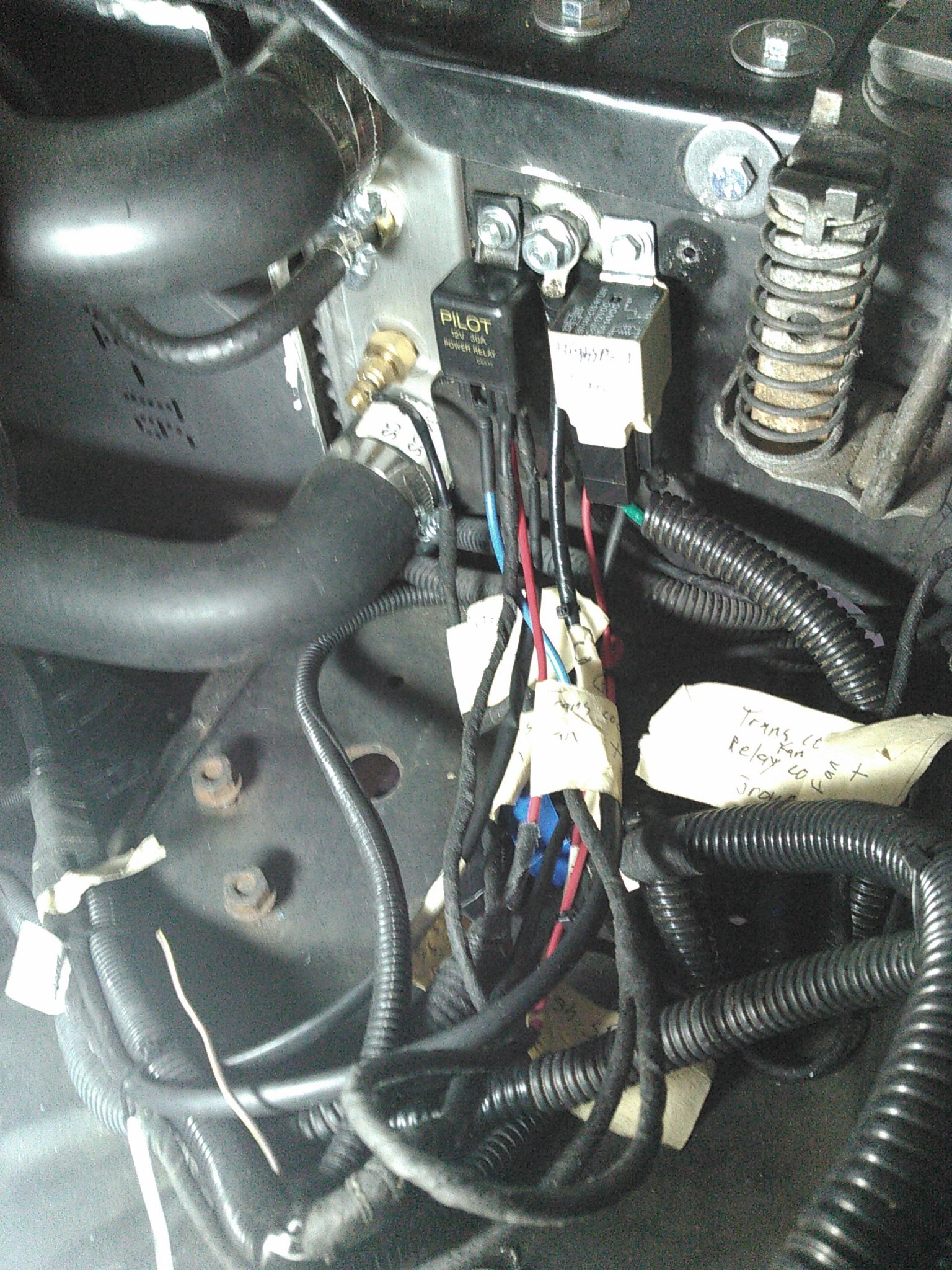

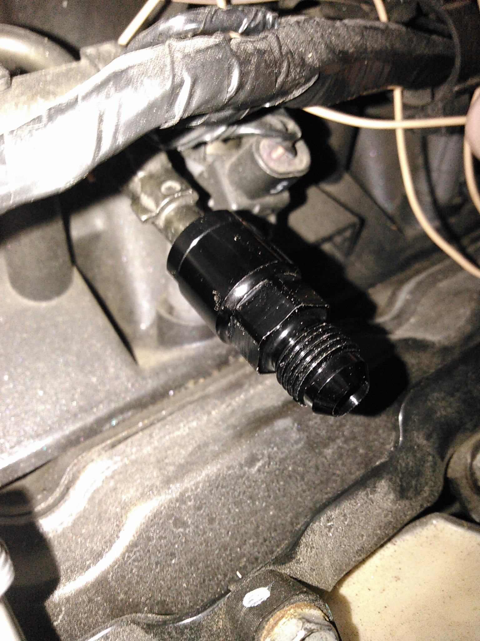

Started merging the two wiring harness halves together, after trimming down the unneeded pieces of the GM harness while watching TV over several weeks off and on. Not boring. Kinda therapeutic actually. Built most of the needed wiring before planting the engine in there.

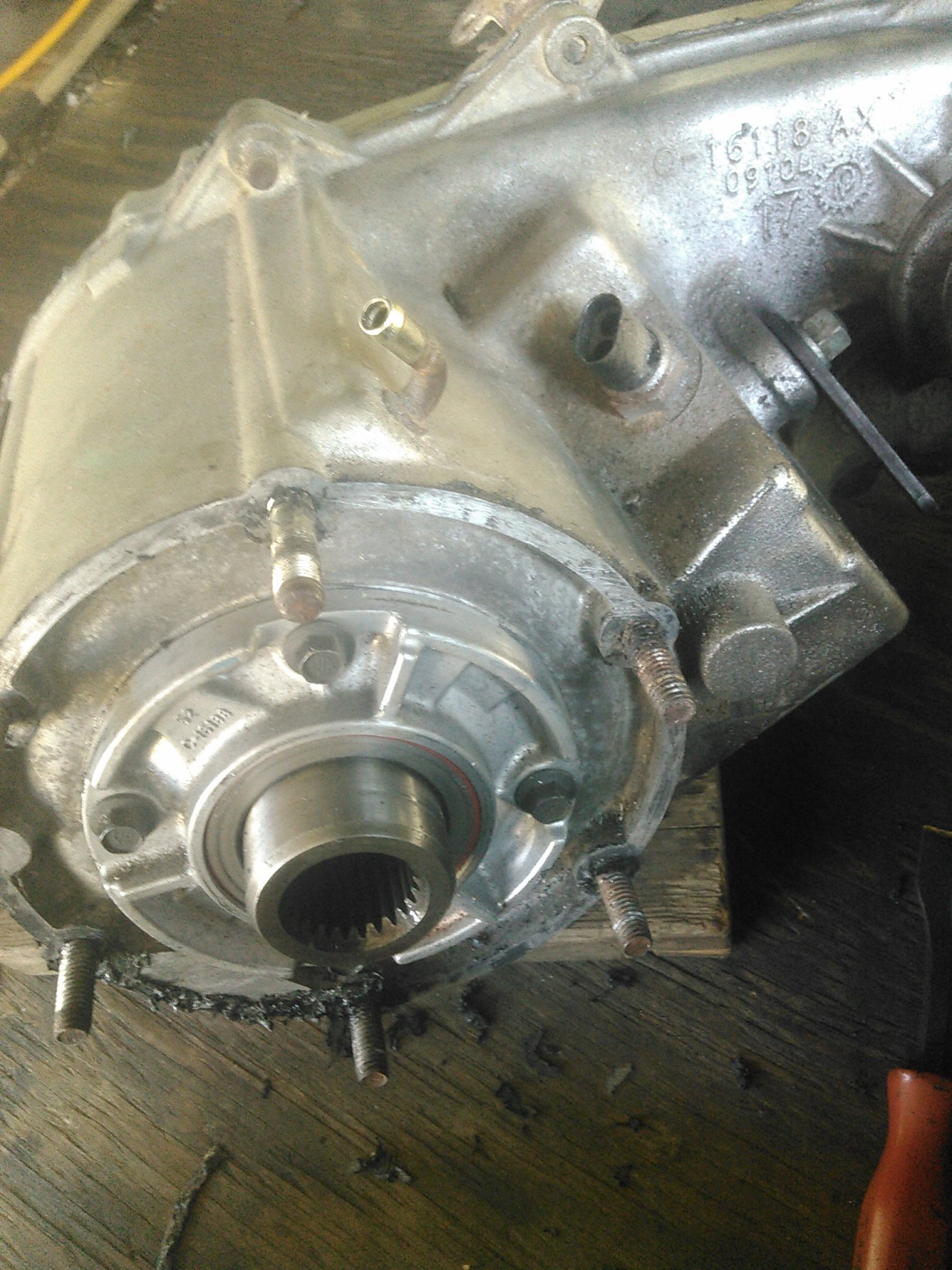

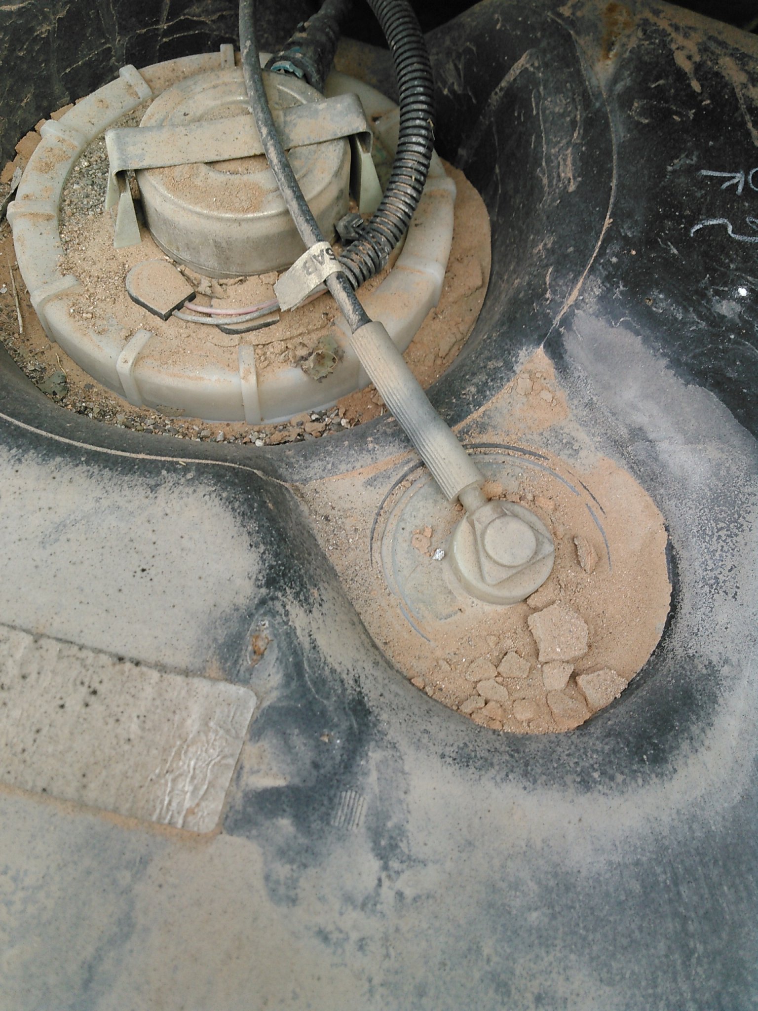

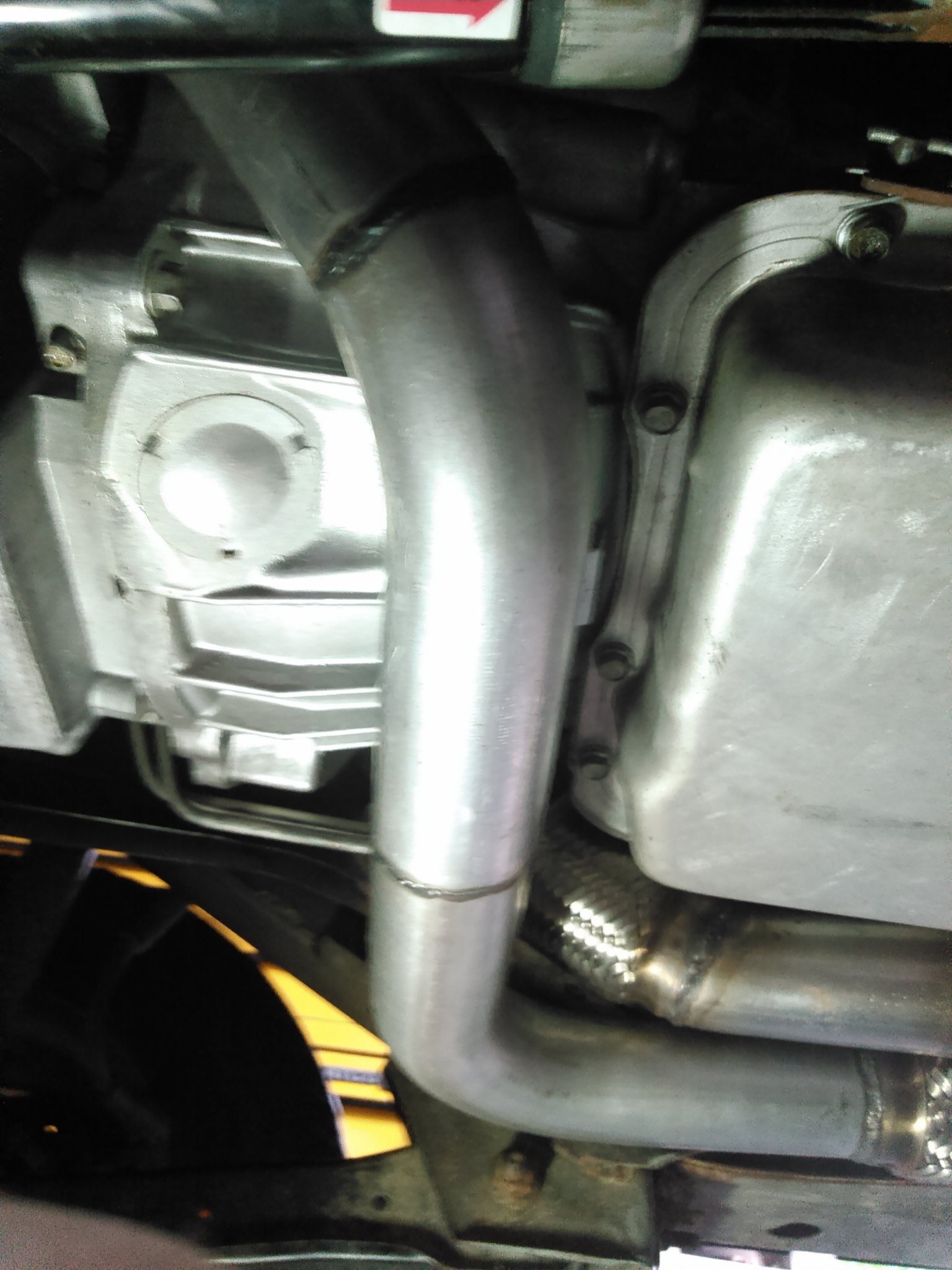

Had to completely rebuild the GM transmission, and install a custom shorty output shaft, designed to work with the 231J transfer case. It works well. After building the trans, I installed it on the back of the engine, and jammed it in the jeep. Still a lot of work ahead, though.

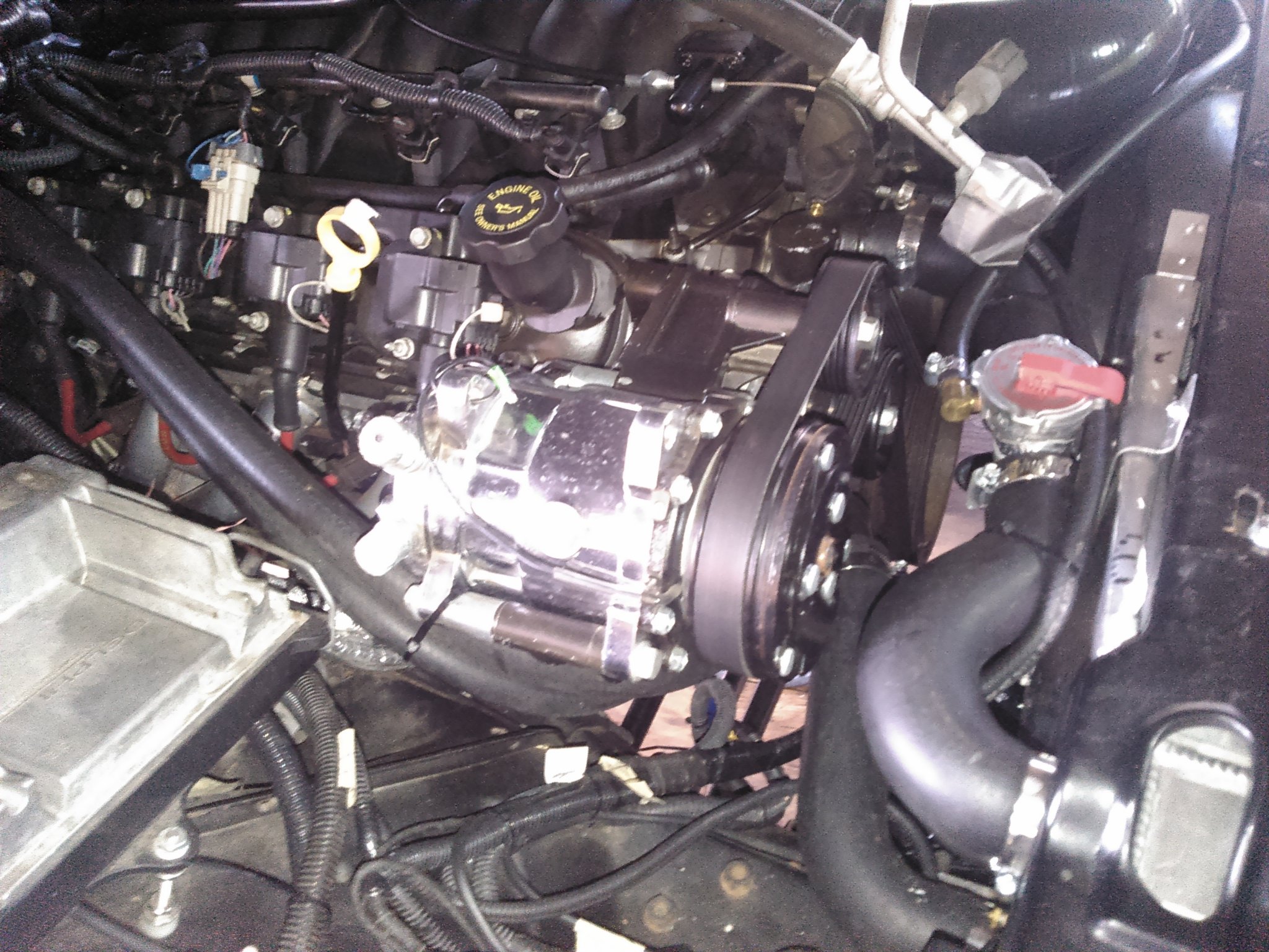

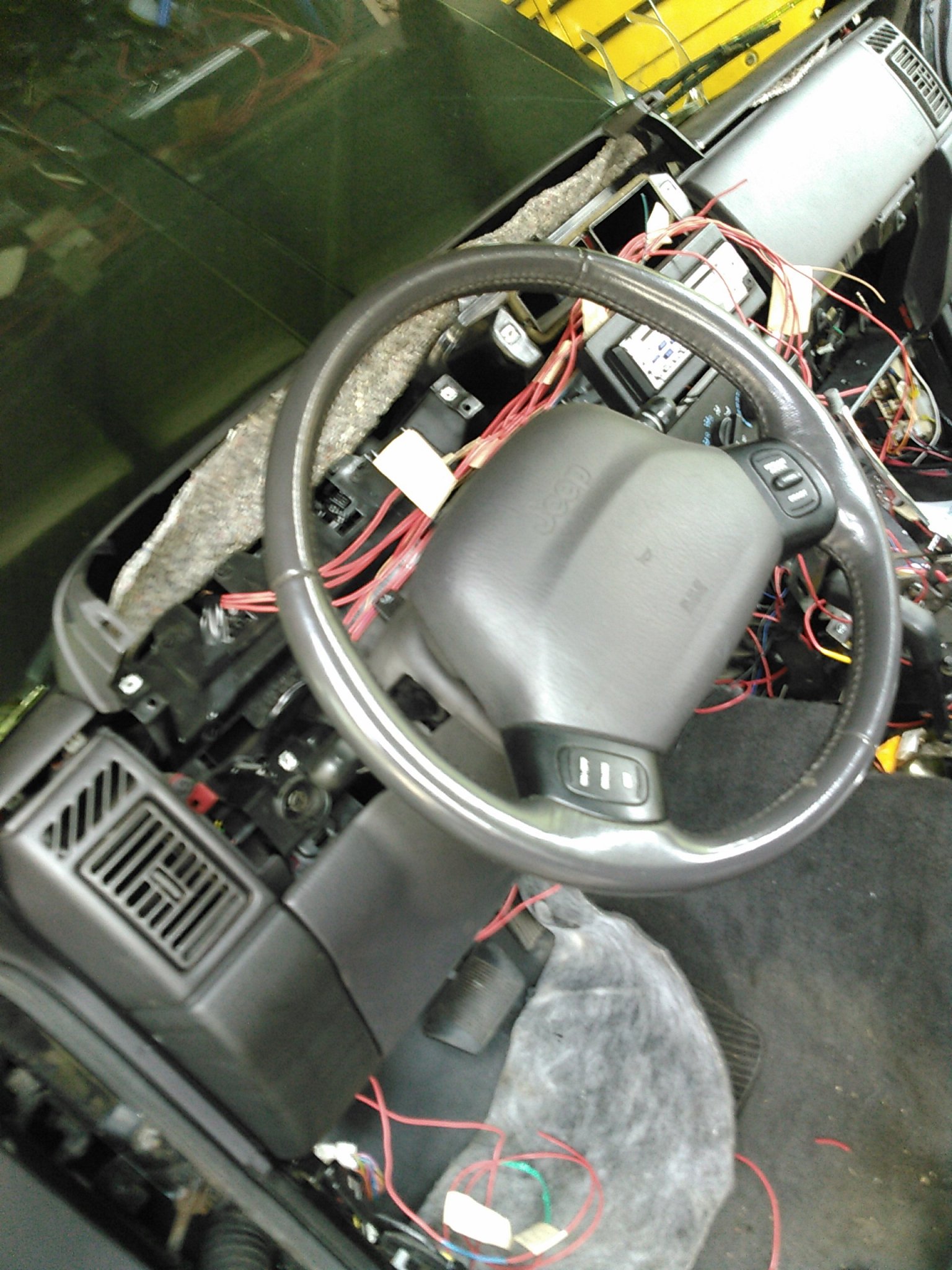

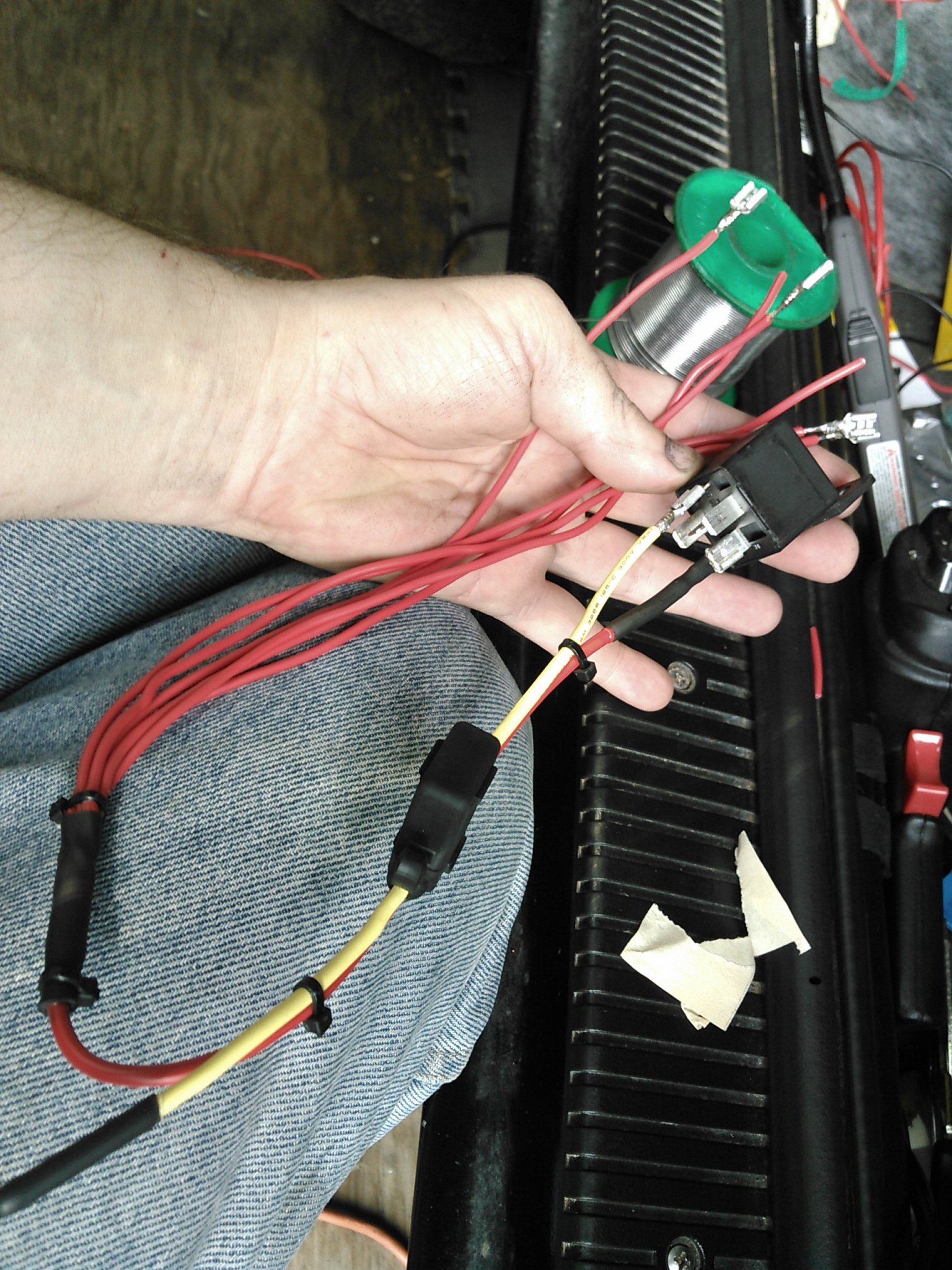

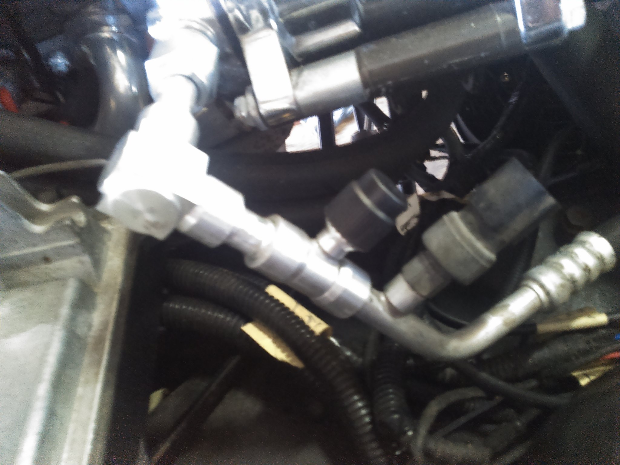

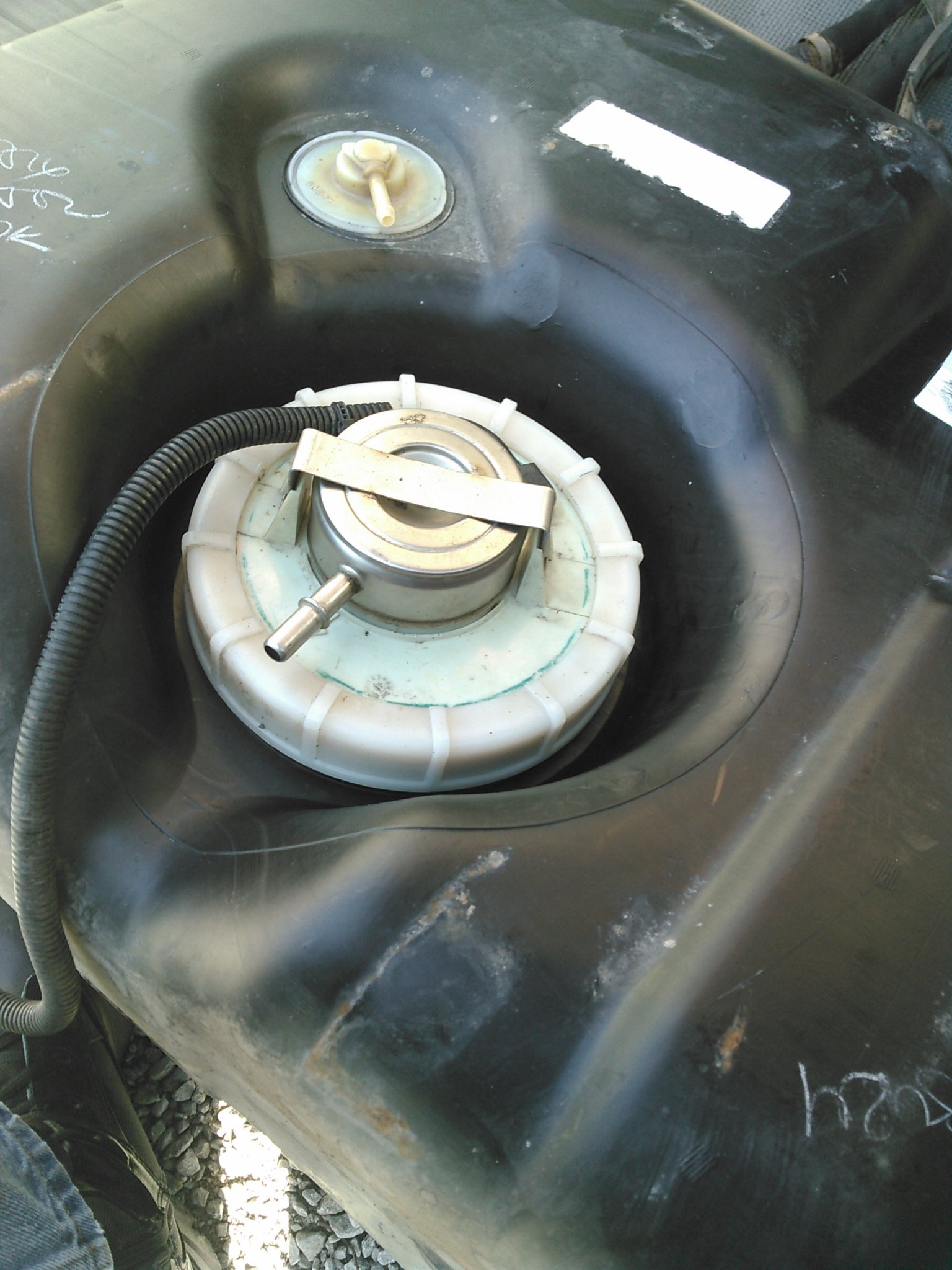

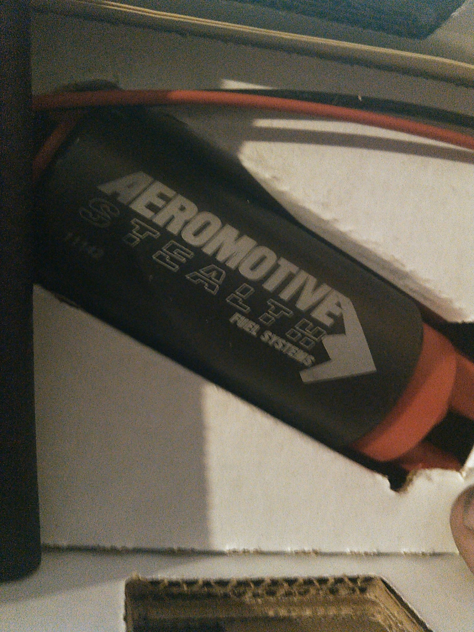

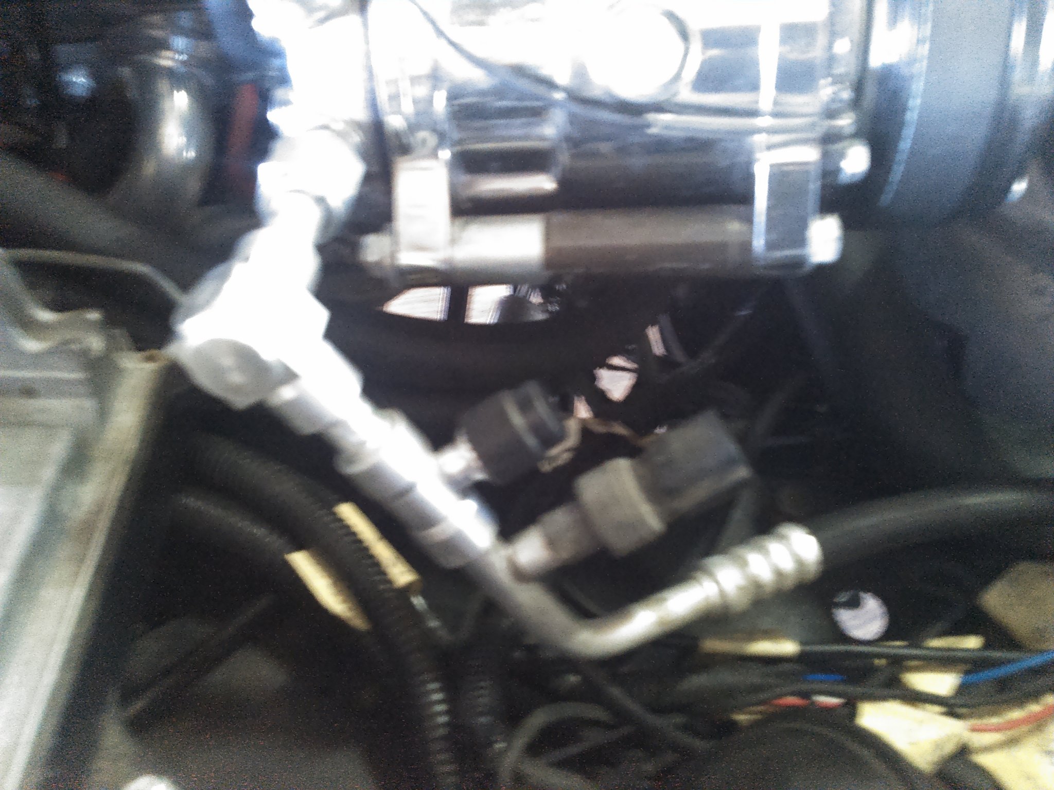

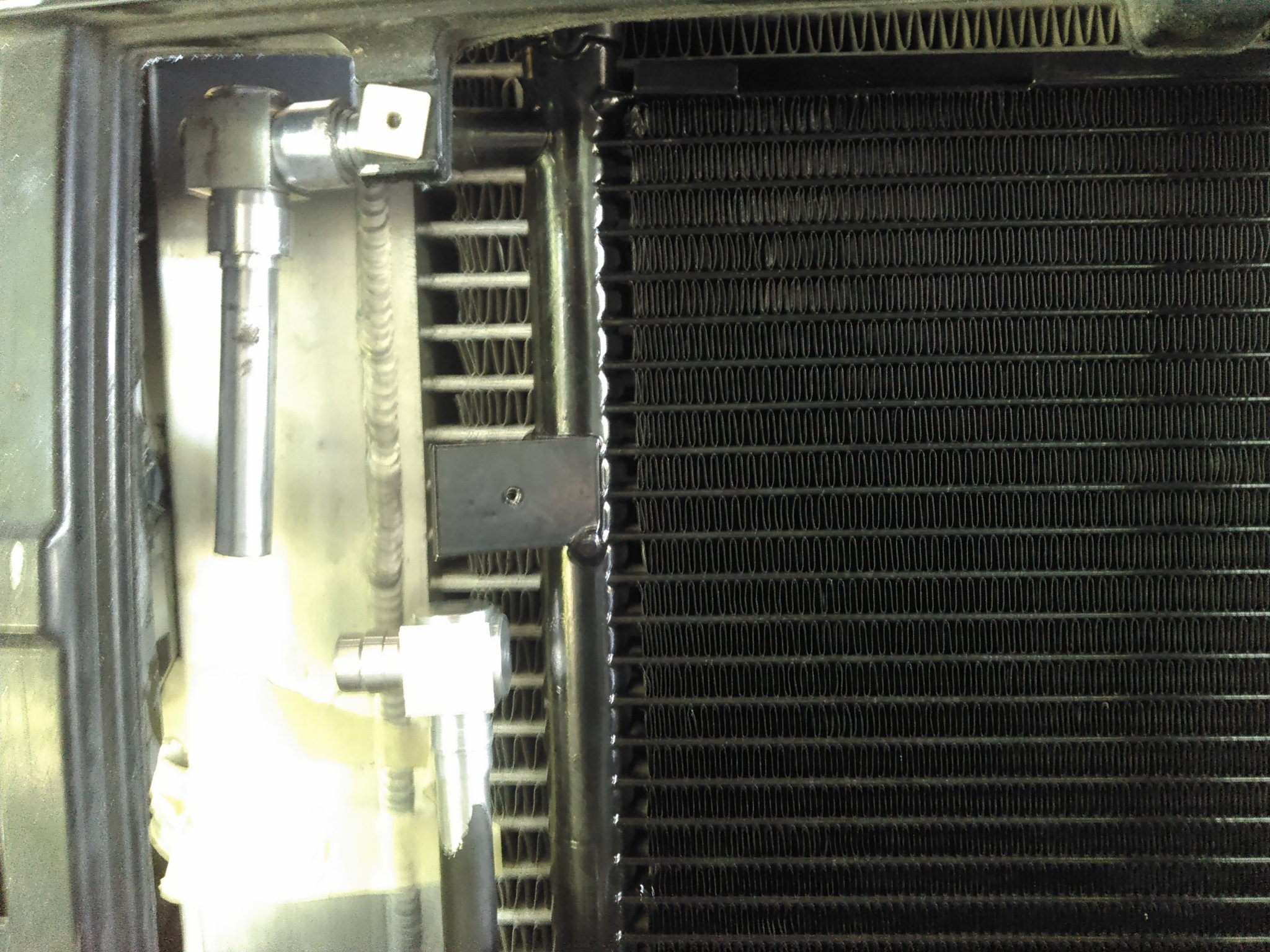

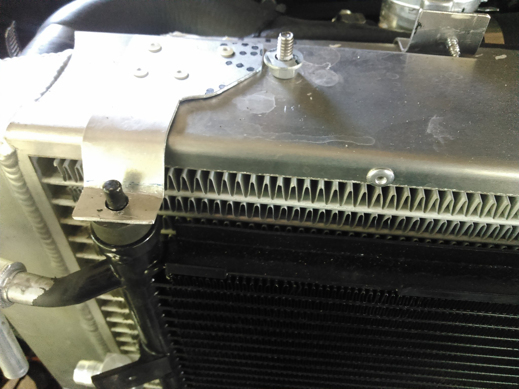

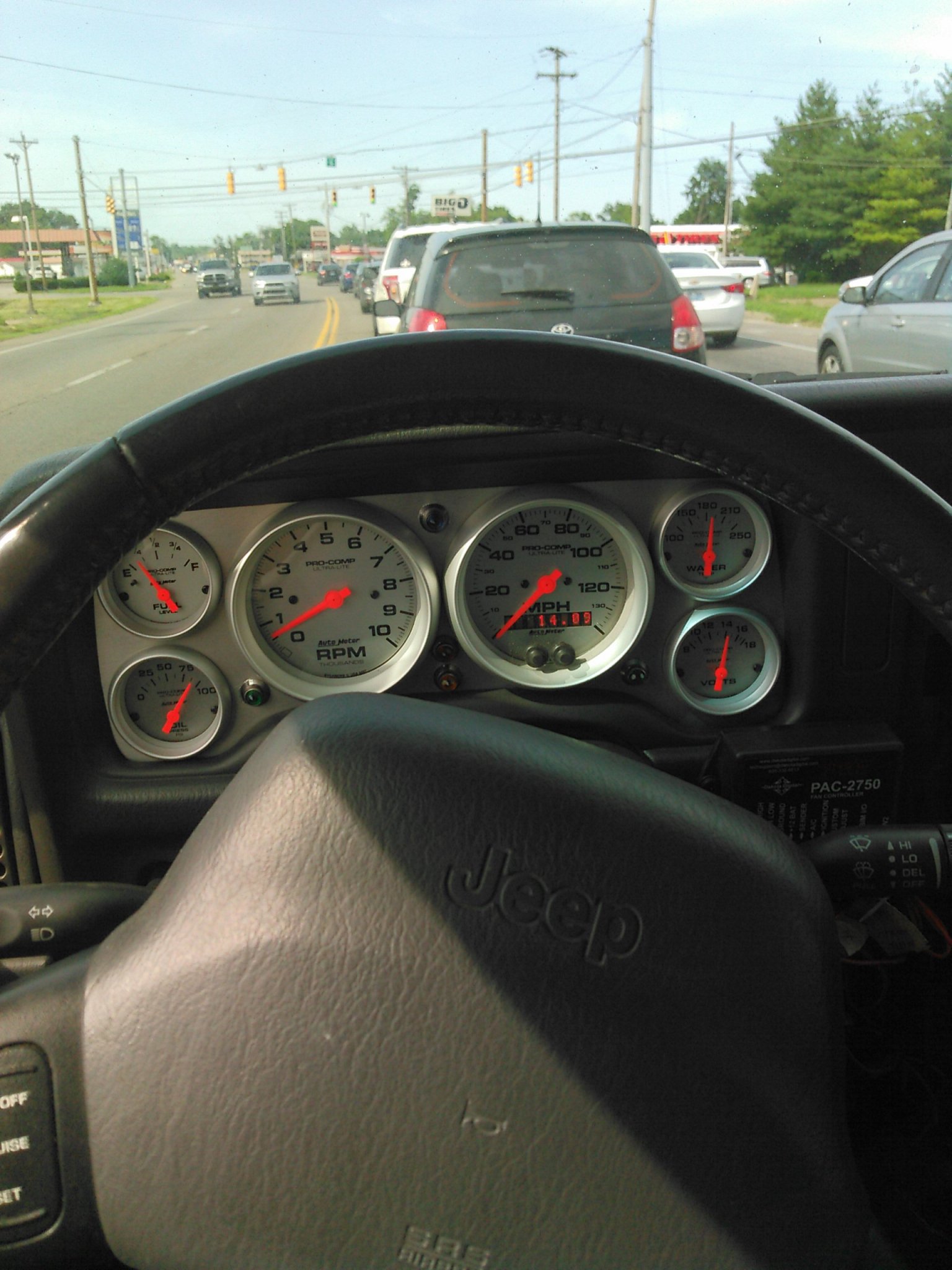

Had to build my own gauge cluster, and accessory harness, as well as make the A/C system work with a mix of Jeep, GM and aftermarket parts. The fuel system also needed upgrading, a lot.

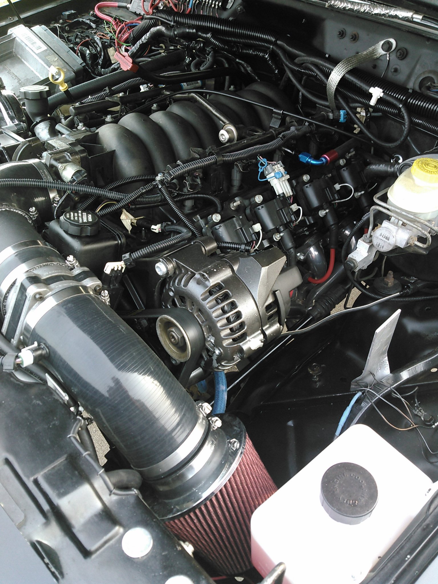

Since then, the ol Jeep has evolved, and the engine is now a 6.0 LQ4 version of the LS, with the cylinder heads from the first Trans Am motor, and I did a thorough port and polish job on em. Tuned the ECU for part throttle fuel economy, and then it goes a little rich, "12.5 to 1" at wide open throttle for full power. A little extra timing, and it's bumping up against 450 HP with mostly stock parts. No more problems pulling the camper.
Who else has Jeep stories?

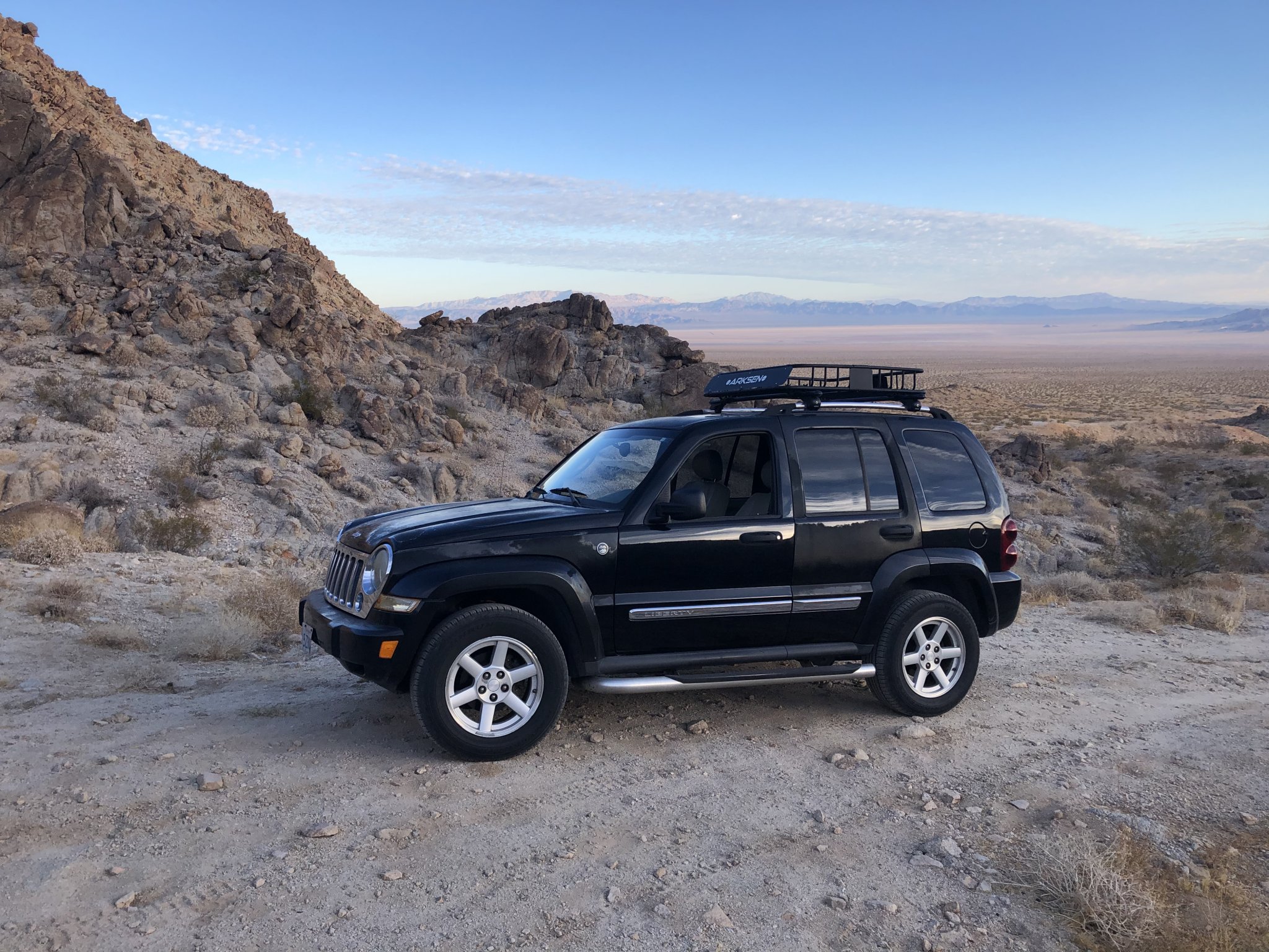

Just starting my adventure— 2006 KJ. Wanted a little trail Jeep to run around in with the kids. She did great on our first outing last week. Starting with a lift and new shoes, we’ll see where it goes from there:

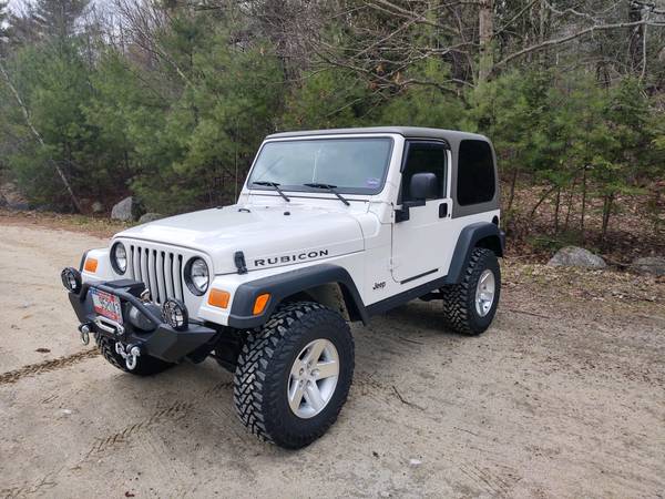

A 03 Rubicon that was stock with a 2.5" spring lift and 33's, it wasn't as unstoppable as the built 01 TJ but was pretty impressive for what it was

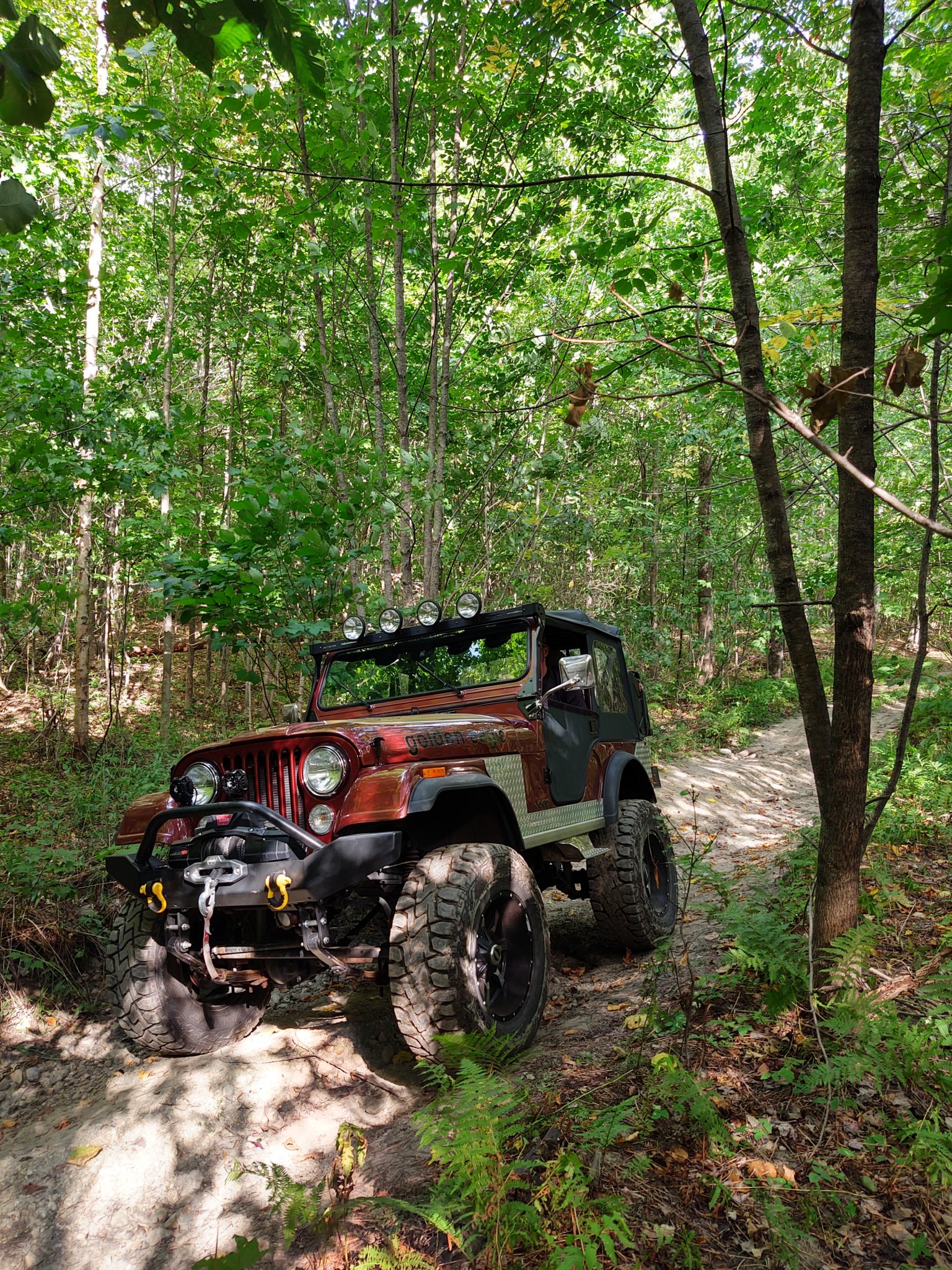

And my current project is a 79 CJ5 with way too many parts to list but basics are a new 304 with a flexolite radiator and electric dual fan assemble, T18, Dana 20 with a twin stick conversion, Nitro Dana 44's with 3:73 gears (works great with the transmission and transfer case gearing) ARB's, about 4" of lift between the shackles and springs and 35's, basically everything but the body, frame, windshield, and dash assembly is new. The new custom dash is on order from DD Fab right now with Phantom gauges on standby for the winter:

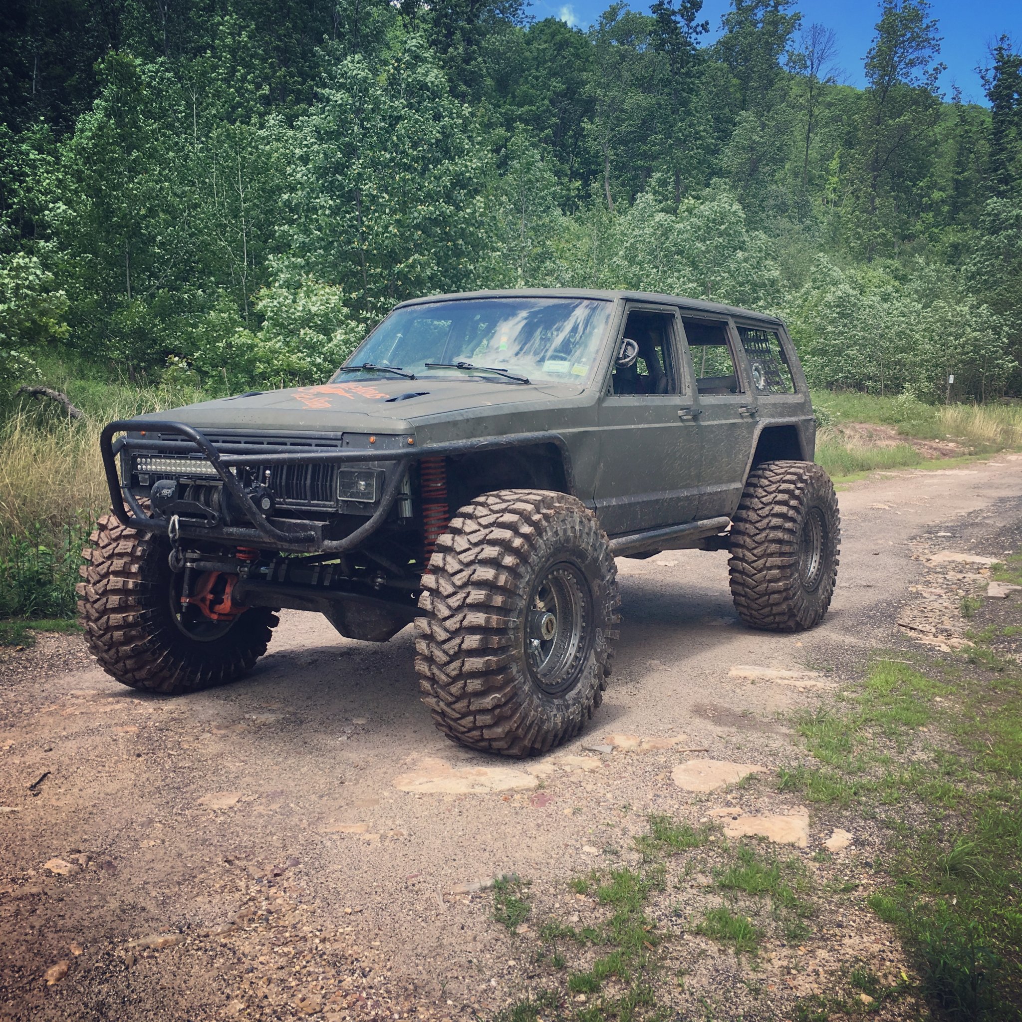

This guy does off-road recovery with “the Banana”, a Cherokee. He says that stock they are terrible but jack them up, pull the sway bars and lower your tire pressure and they are monsters!

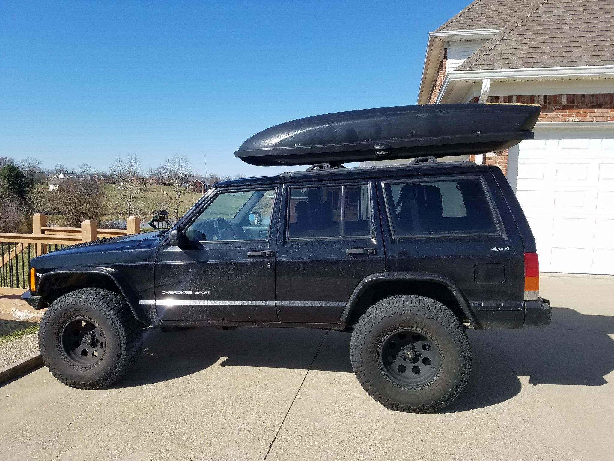

Had my Cherokee for about 8 years I believe, started out stock and ended up with fabricated 9” axles, 40” stickies, coilovers and alot of cage inside, it worked well. Wanted to do some ultra4 races but never got around to it.

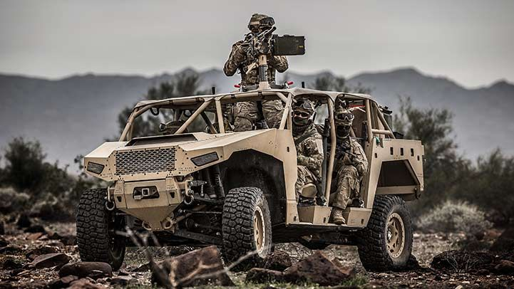

It's the base used in this:
