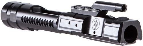

If you wanted a subdued coated BCG, go with PWS DI BCG. It has a really slick Isonite coating that I believe is better than anything out there. I was able to pick one up for $99 before the previous election but the price for one of these is double or even triple now.
