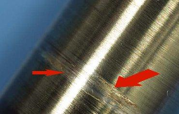

    How do you tell if you’re “galling”? I’ve run my Sinclair neck turn mandrels with and without neck lube and couldn’t feel much of a difference. As a result i stopped using the Redding Media because it was messy and I couldnt clearly see a difference in performance after using it.
    You will see the brass on the mandrel. Brass is gummy compared to tool steel. It starts to build up on the mandrel.

    What galling looks like:
    Galling will flow along the direction of relative motion between the two parts. In the case of a expander mandrel, it will be longitudinal
