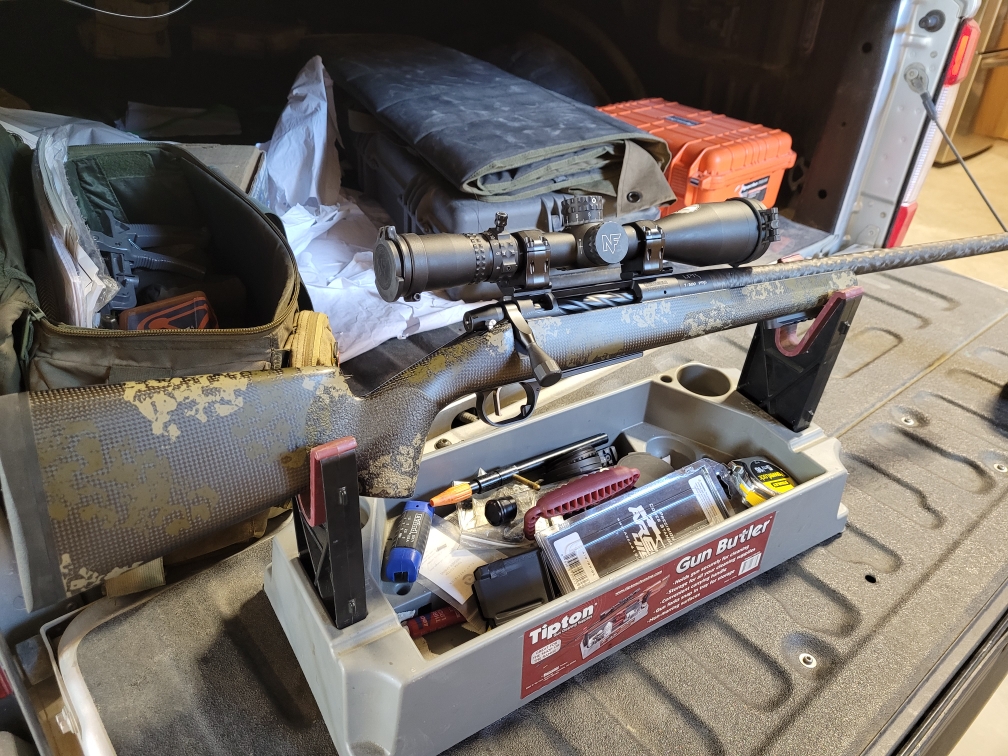

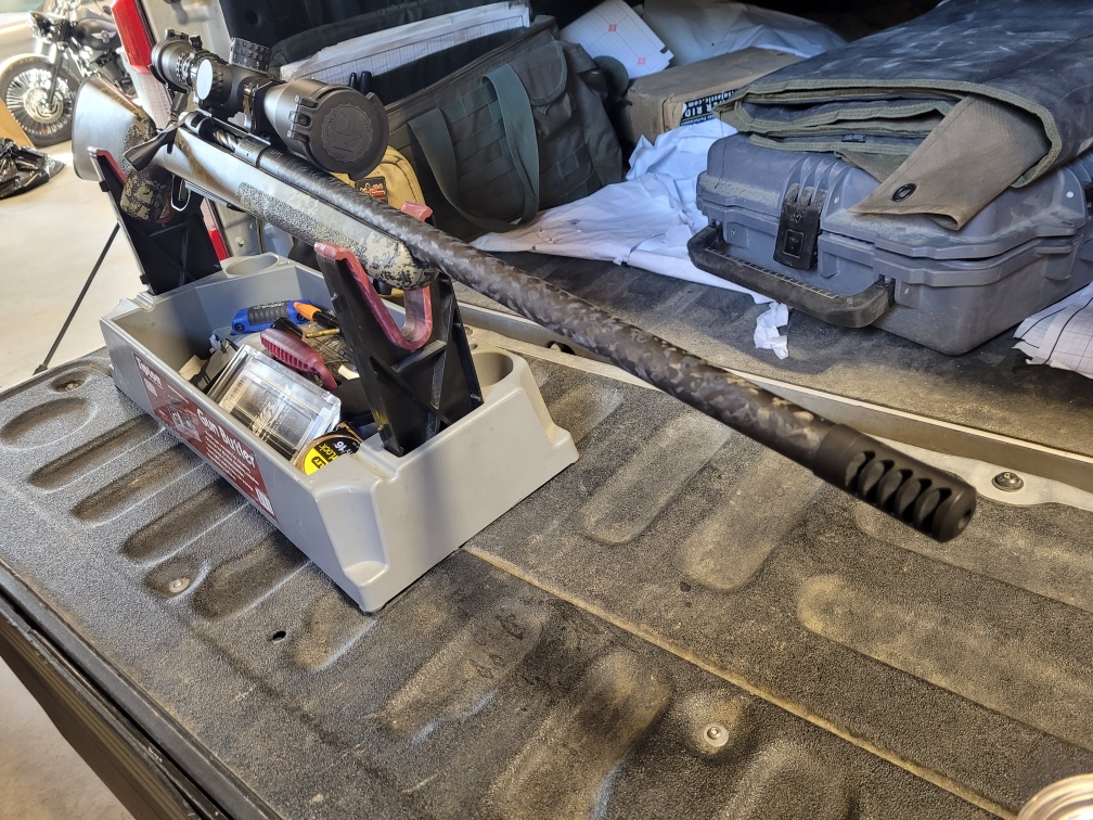

    Ive got one. 22" rock creek 8tw carbin, terminus helios lite, alterra carbon hunter stock, just under 9# with a nx8 4-32x50. Running 195 bergers at 2990 with N570. The terminus shows pressure early, figured I'd get more out of it, but it shoots well, grain under pressure.

    Standard powders like H1000 or Retumbo were 60-80fps slower before pressure. Looked back through my data. N570 Topped out at 3100(bolt lift) with 190LRHT, but accuracy is at 2970-3000. 195s shot there, and at 2920fps with N570. N565 with 190s made it to 3040fps before psi signs, shot well at 3000 fps. This chamber has a 535 diameter at 200 line, similar to AW spec prc reamers to prevent clickers and get adequate case sizing. Saami is 533 at 200 line. I have a very long freebore as all I planned to shoot were berger 184, 190 and 195.

    Barrel life I'm unsure of, 270 rounds on it. Its a light hunting rifle. 77gr N565 for 3000fps with 190lrht jumping 25k from a 22" rock creek 8tw carbon barrel.
    Barrel life is subject to rate of fire, and powder energy/flame temp. H1000 or Retumbo vs N565 or N570, will be 15% less barrel life. 28 Noslers might get 800-900 accurate rounds if you treat them nice with cooler powders. Run blowtorch powder and 600-800rd is more likely. Case capacity of a 7/300 water weight is right at 96gr with adg brass, 28N is 103. There will likely be little difference.
