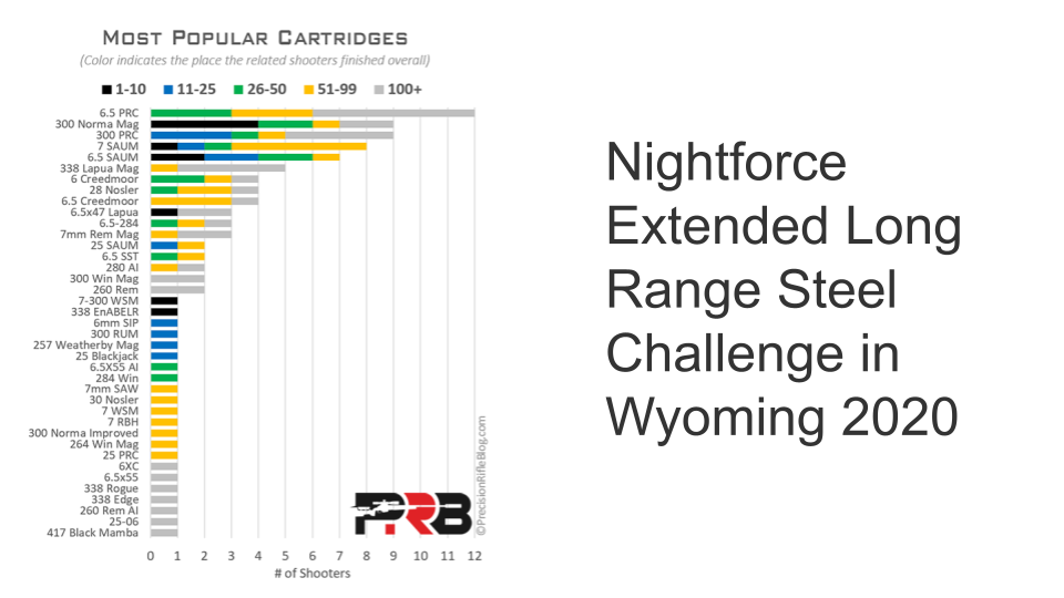

better get some long and lapua actions then
Well, originally, that's why I have focused my 3 bolt action builds around 556, 308, and 6.5 Creedmoor. I did this because I was not intending to reload, and I wanted to share my ammo between my AR-15 and AR-10 as well as my bolt action rifle. Having had many threads on the Semi-Auto forum, I've now been convinced to reconsider reloading, and if I go down that route, well then that opens me up to a lot of possibilities. If I reload, then I guess I could replace my 6.5 Creedmoor build with something more exotic like 6.5 PRC, 300 Norma Mag, 300 PRC, or 6/7.5 SAUM. (I know nothing about ammo, I'm still learning)
I don't know if these cartridges require a long action though. I just know that I want a 556 trainer gun, a 308 primary gun for competition and hunting, and a long-distance gun that can hit beyond 1000 yards. My long-distance caliber / ammo considerations are based on this chart:
"Beyond 1000 yards" is pretty nebulous.
You aren't totally off with your existing plan since you also have MSR platform rifles
.223 is a nice cheap easy to shoot option and with a long barrel and good loaded ammunition, 1000 yards is possible with a high expectation of accuracy.
.308 is nice since it matches a lot of what you will have, and a good bolt gun will easily get to 1k and a bit beyond
6.5CM is a nice target round that easily reaches out to 1300 yards and beyond.
If you want to go to the mile easily or beyond, then look at the .300prc or the .300NM
.300 PRC will be a lot less recoil, a lot cheaper to shoot and just need a standard magnum long action boltface.
.300NM needs a .338LM bolt face and a pretty long action, both of which put you into a different class of rifle.
