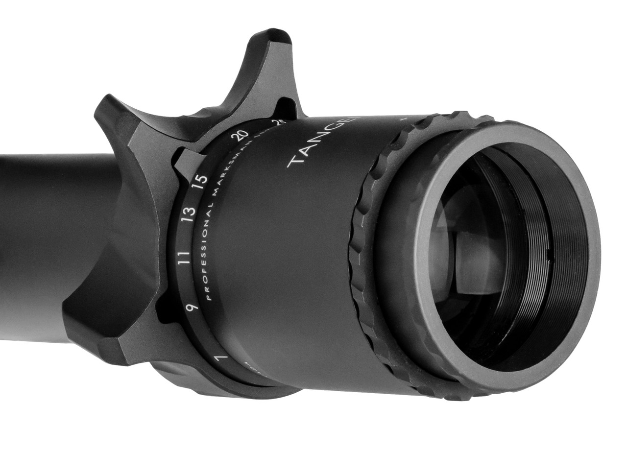

Why are non-translating turrets desirable?
Because they speak a foreign language and it sounds sexy?
Help a brother out here.
What is a non-translating turret?
I've never heard of that.
I understand turrets that stay the same height when dialed are called non-translating.
Turrets that get taller when dialed are called translating turrets because, I guess they “translate” the dialing to additional physical turret height.
Apparently the former is desirable, though I have no idea why.
-Stan
No need for them if there's a little marker that pops up like what the Kahles has
Thank you.
So it isn’t “I need non-translating turrets because the additional turret height catches on barricades and enemy trip wires” as much as it is “If there is a revolution indicator of some kind already, then I don’t need the turrets to translate” or “I prefer revolution indicators instead of a translating turret to tell me where I am during dialing”?

My mind thought that the non-translating turrets could have more durable and shock resistant built as the turret cap is not directly linked to the reticle gearing / housing or at least can be made safe from impact causing a failure.
The counter to that is that a non-translating turret is more complicated with additional small parts and gears to drive the actual shaft that moves the erector tube, while remaining at the same position. It is entirely possible that these small parts are more prone to go out of whack (technical term) and cause the non-translating turret to malfunction if used heavily. The translating turret is corrected directly to the shaft and doesn't have to rely on a more complicated gear system. It's like rack & pinion steering (translating) Vs work and roller (non-translating). (If I remember my car steering technology correctly. Nowadays everything is power steering and the one in my car is electrical, but these things do not exist in riflescopes. Power assisted turrets, oh wow.)
Yes. Your zero is a random hash line, that doesn’t correspond with numerical zero, engraved on the turret body. Granted your zero never corresponds to numerical zero as engraved, but I don’t have to be consciously aware of that when the translating turret design doesn’t show me those engraved lines. Perhaps I’m just a slack-jaw, but it never made sense to me to track the zero position and current turret revolution in my head when a sufficiently thoughtful design declutters the view of the turret and indicates the revolution. Before zero stops were de rigueur you could actually lose your zero if you didn’t have it marked; that recently happened to an acquaintance’s older value line scope on his son’s hunting rifle.

So does this mean you prefer the pop-up doohickies on non-translating turrets?
-Stan
Correct. Some scopes have rev indicator windows which is also a nice implementation - TT Marksman, Steiner T6Xi come to mind.
Thank you.
I recently switched from a translating design to a non-translating design and I liked the translating better as the rev lines on the turret are a larger visual reminder for me to zero out my turrets than the pop-up doohickies are.
This is a training thing so no big deal but I realized the situation rather quickly.
-Stan
Some of it is marketing but NF ATACR turrets are translating and they're probably unmatched (but definitely unsurpassed) for zero retention. I do wonder about the correlation there if there is one.

It's a personal preference thing, personally I don't have an issue with either style.
In some ways I preference translating as it's more obvious if you are a revolution out. The caveat to this is the older 5mil turrets has do many damn lines that I could never remember what line I was zeroed on so it was basically worthless.
The S&B colour change in the turrets is pretty fool proof but the turet sticking up away from the housing is the most obvious of them all.
