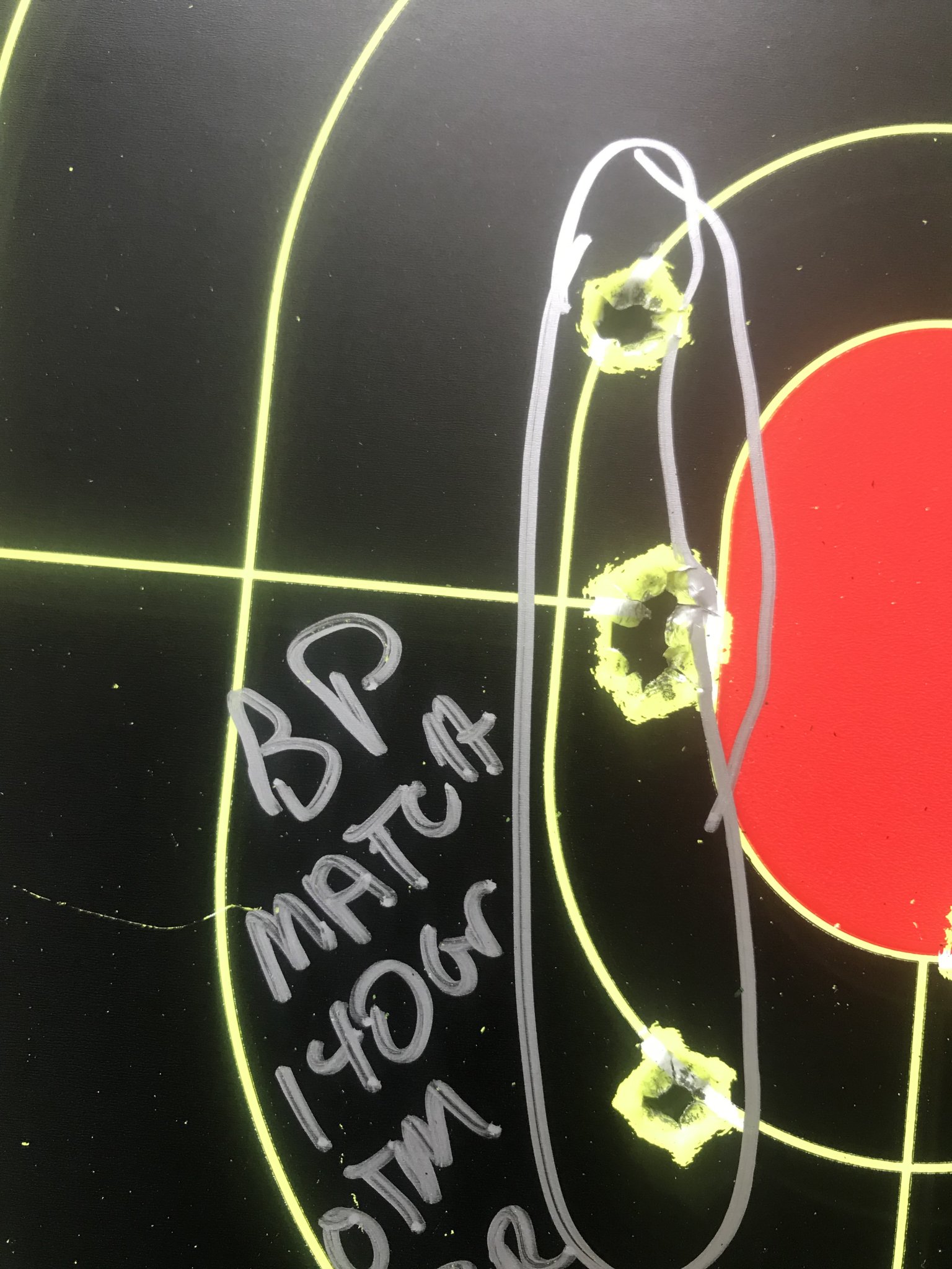

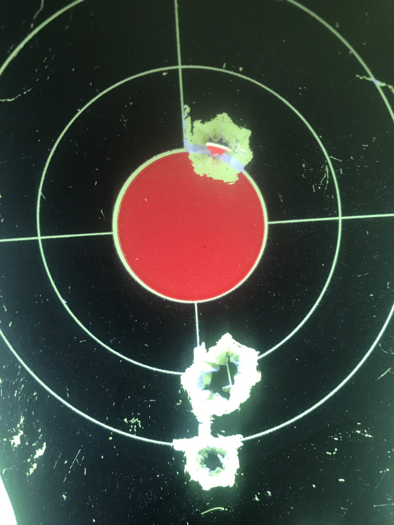

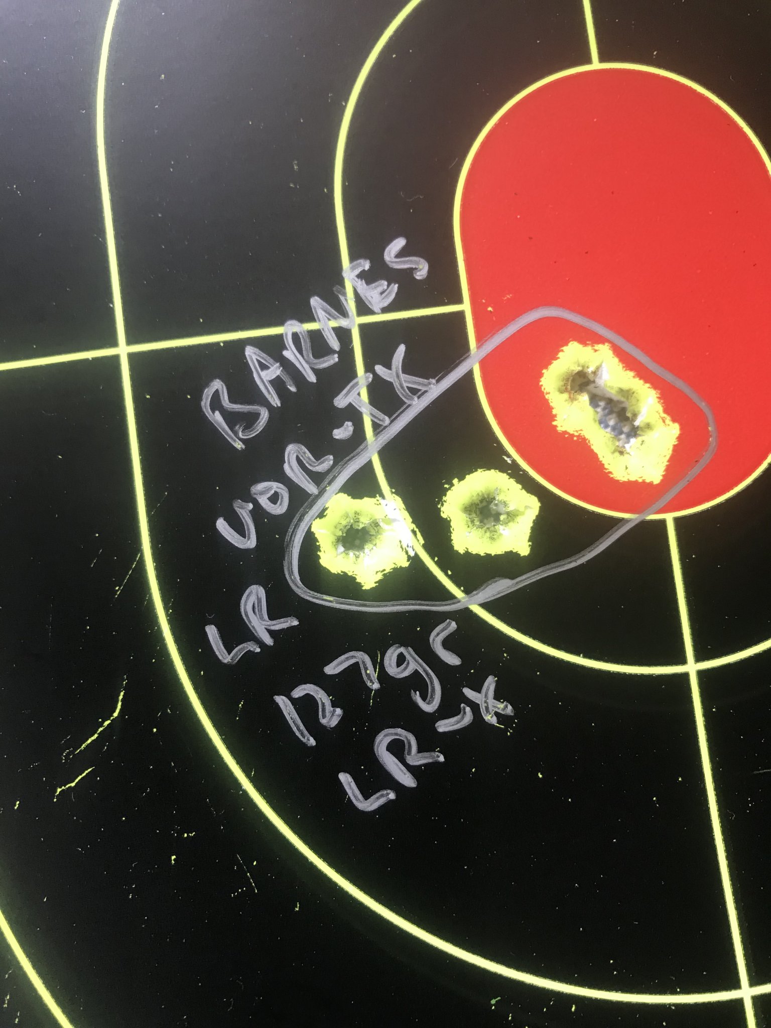

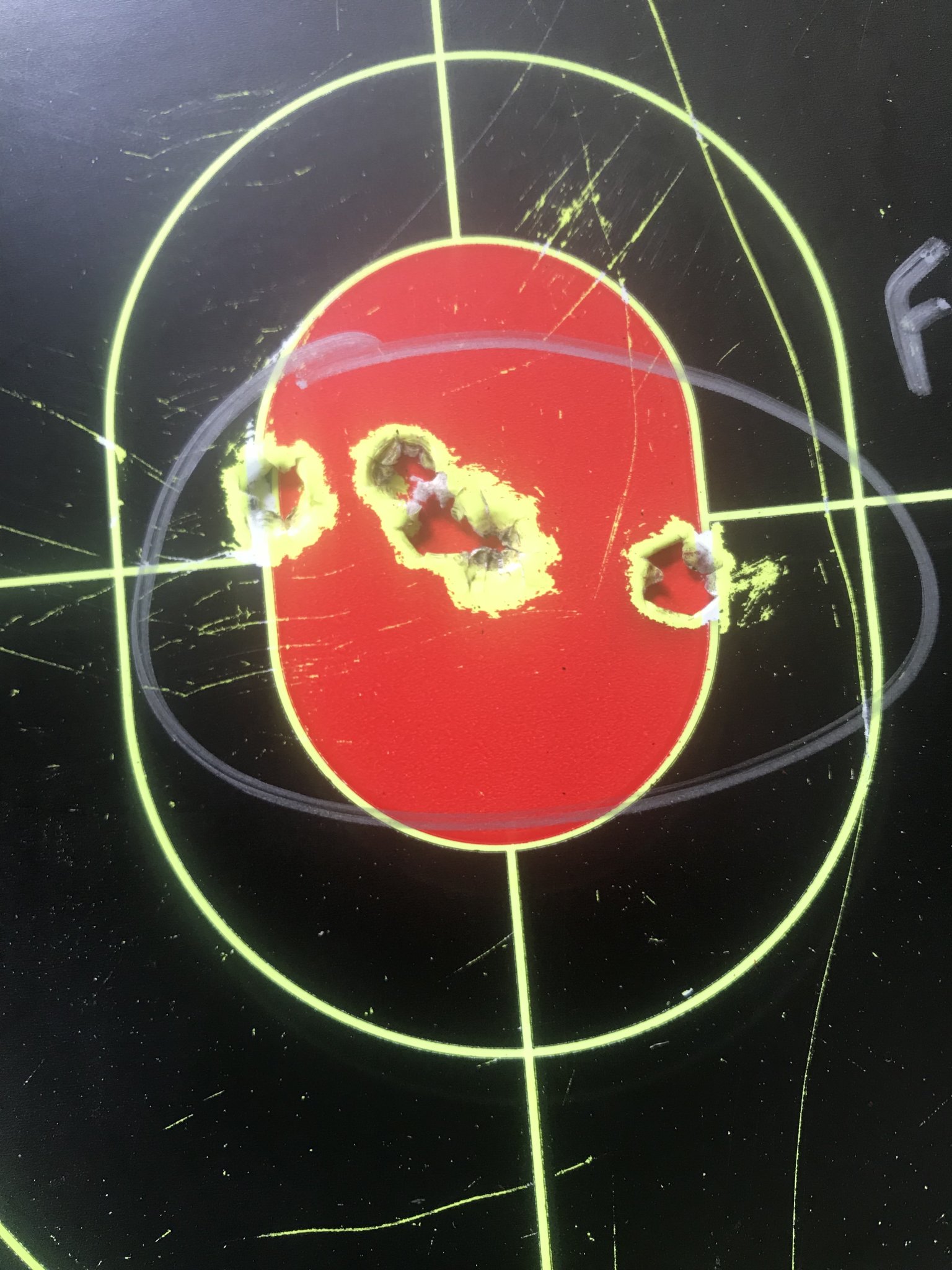

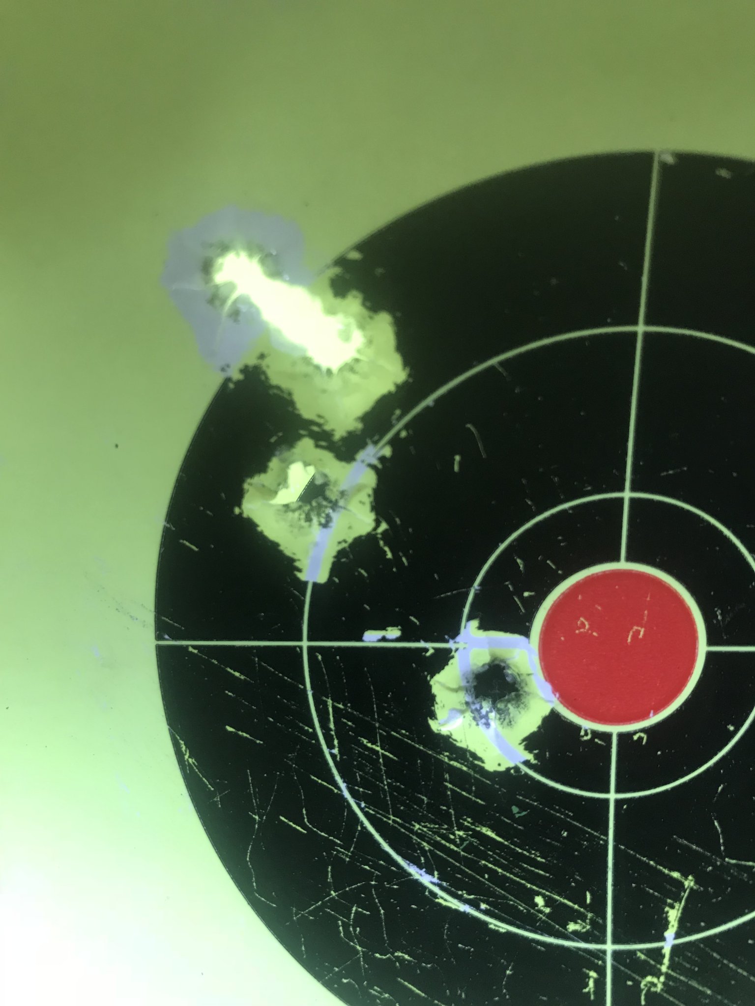

Just finished ar10 6.5 creedmoor build. Every target is off a bipod at 100yards. Each target is different ammo. But each target 3 bullets touching each other with to flyers. Aero precision receivers jp heavy contour 22” barrel. Jp bolt and buffer tube magpul prs stock. Burris predator 4.5x14 until I save some $$$ for better optics

Thud it was a little breezy at only 100yrds wind affect it that much?
ShtrRdy stock isn’t collapsable. Magpul prs. Minimal movement between receiver. Aero precision has an Allen screw that you can adjust to put pressure on take down pin to tighten it up.
Wind will not cause that much horizontal stringing at 100 yards, unless you are shooting in damn near hurricane wind.
Barring some sort of mechanical issue with your rifle, horizontal stringing is caused by poor trigger control, and where you break the shot in conjunction with your breathing cycle can cause vertical stringing.
I would take a look at your fundamentals. Often we like to blame the equipment, when a lot of the times the issue stems from the trigger puller.
A few years back, I had a post on another forum asking to diagnose my issue with a 6.8 SPC upper I had built. Like you mention, I was able to shoot a couple tight shots, then the group would open up. I asked a fellow good shooter to get behind the gun and he put 5 shots down range that measured just over 1/2 inch.
Sometimes we are too smart for our own good; we so badly want a one-hole group and we pay attention to attaining it......instead of sights, trigger, follow-through. That was my problem and my experience.
Lastly, you might put a paper target at 200 or 300 yards or beyond (non-Shoot & See), and focus on executing 5 good shots. You won't be able to see your results and they may surprise you.
I was blaming myself and still believe it could be me. Just weird it’s so consistent to me. Is there a certain way you grip the handle and pull trigger to prevent pull. I already try to pull trigger with tip of my finger.
When I was having issues with vertical groups, it was discover through having another shooter watch me, that I was continually breathing through my trigger press. Once I trained and became better at exploiting my respiratory pause, my vertical group has almost gone away. As far as horizontal, check your parallax.

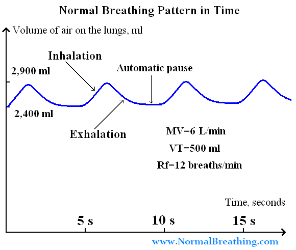

respiratory pause?
Respiratory pause (term used in my training history, possibly different term than you have used), is at the end of your natural exhale. When breathing, your abdomen extends out as you inhale (air fills your lungs) and retracts in as you exhale (air exits your body). At the end of your exhale, your body has a brief amount of time where the muscles responsible for breathing are most at rest (your body is stable). This time is different for each person and different based on how fast you are breathing (are you relaxed or just finishing wind sprints). If you have a string of shots that are standing up and down, it is possible you are breathing during the shot causing your body to go up and down as well as the gun.
Attached is a graph I was able to find quickly to give a visual of this process. Disregard the numbers but the graph demonstrates the period at the end of an exhale in which your body is in a respiratory pause.
Hopefully this helped. If not let me know.
