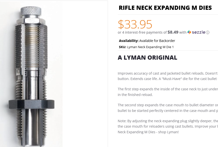

    Question on that flare and crimp; that's on rifle ammo? If so, doesn't crimping the neck to the point where you still get like 4 thou of neck tension WITH springback, not deform those bullets bearing surfaces?
    You can experiment with exactly that using a 'taper' (not 'roll') crimp die.
    I knew a guy (10-15 yrs ago) who had their 650 set up to size, trim with the Dillon RT1200/1500, and then expand/flare with a Lyman M die. Next tool head was charge, seat and a light taper crimp. Apparently worked well for mass quantities of NRA Service Rifle ammo; not sure about modern 'precision' rifle.

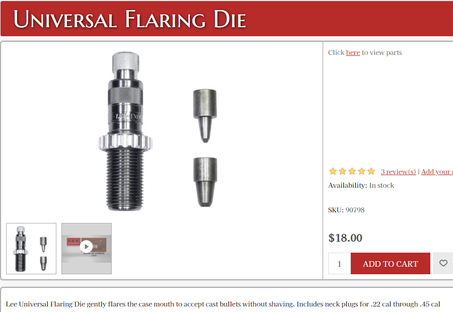

    The Dillon power trimmer uses a type of FL sizing die (trim die) to "hold" the brass from spinning while the cutting tool spins and cuts the neck, but this is a straight cut only - no chamfer. That straight cut is too sharp and would scrape and damage bullets.
    Even if I tumble prior to using a different tool-head for loading the trimmed and prepped brass, those necks are not chamfered and way too sharp as-is.
    We use a flare tool to slightly open the necks to be able to place the bullet for seating, then after the seating die there is a taper crimp just to close that flare.
    I hope that makes sense, and I realize it isn't something most folks talk about in detail on forums. There are more labor intensive ways to chamfer and do a nicer job, but that isn't practical for prairie dog loads that you make 2000 at a time.
    We have made custom flares, used the Lee as-is, or modified the Lyman M dies to be able to run the whole process on a Dillon without the need to handle each case to chamfer. Most seater dies will remove the flare without drama, even without actual crimping. If you are picky, you can use a Redding Taper Crimp die as well. YMMV
