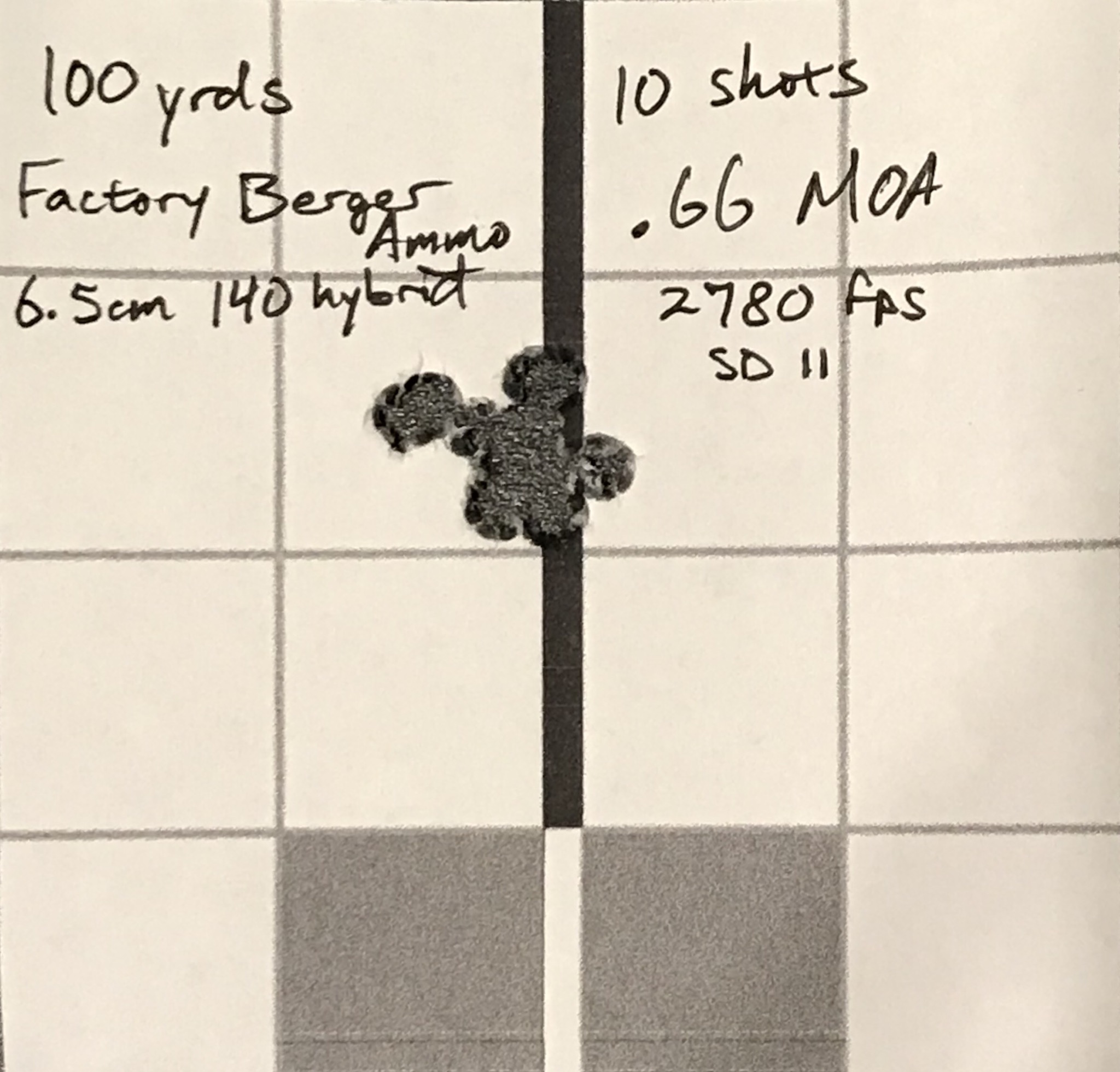

Ok guys, I know this might sound sarcastic, but I am genuinely curious as to what you all think as I’m sure there’s an angle I haven’t considered.
Let me start with some background. I recently put together a rifle in 6.5CM with the intention of competing in some local and/or regional PRS matches. After putting the rifle together, I wanted to start with shooting some factory ammo to acquire some brass and experience with the rifle before diving head long into reloading for it (I reload for every other rifle I have). I started out with a case of Hornady 140 eldm, and while it did reasonably well at the first match I shot, the accuracy and velocity numbers weren’t quite there (0.8-1.0 moa + low and somewhat erratic velocities = not a great combo for the long range stages).
Not wanting to give up on factory ammo quite yet, I picked up a couple cases of the Factory Berger 140 Hybrid ammo. I figured at the very least, I can sell it and recoup the cost of it doesn’t shoot either.
Long story short it shoots great! 0.5-0.7 moa 10 shot groups, SD’s in the 10-12 range!
This having been said (everything’s always subject to change), if I buy the loaded ammo and sell the Lapua brass, it costs less than the cost of the components to reload, and that doesn’t even account for the time savings.
So my question is: Given my application, is there anything I’m missing by not developing a load specific to this rifle? I’m not chasing groups, I’m just smacking steel, maybe some coyote hunting from time to time.
You’re thought and opinions are greatly appreciated!

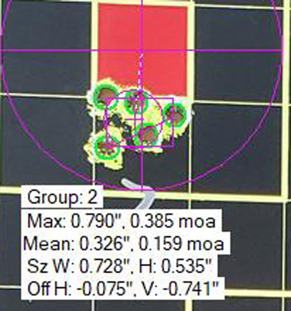

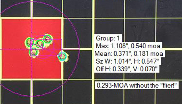

I'm at 3200 rounds through the original barrel on my RPR 6.5CM. I've only used factory ammo. I'm still consistently shooting sub-MOA 5-shot groups with it... often in the 1/2-MOA range, and sometimes approaching 1/3-MOA when I do "my part" along with a bit of luck. Some 200 yard groups from a couple of weeks ago:
I think i'll eventually delve into reloading. And, I totally get the "OCD" control over every aspect of performance. But, it's logistically not in the cards now (no space / place for a bench).
In the mean time, I get pretty darned good results from Hornady ELD-M 140, Federal Gold Medal Match Berger 130, and Berger Match Target Hybrid 130 cartridges. I'm really liking the new Berger Match Target cartridges. They seem to be quite consistent. And, if I sell the Lapua brass they come wrapped in, the net cost is quite reasonable.

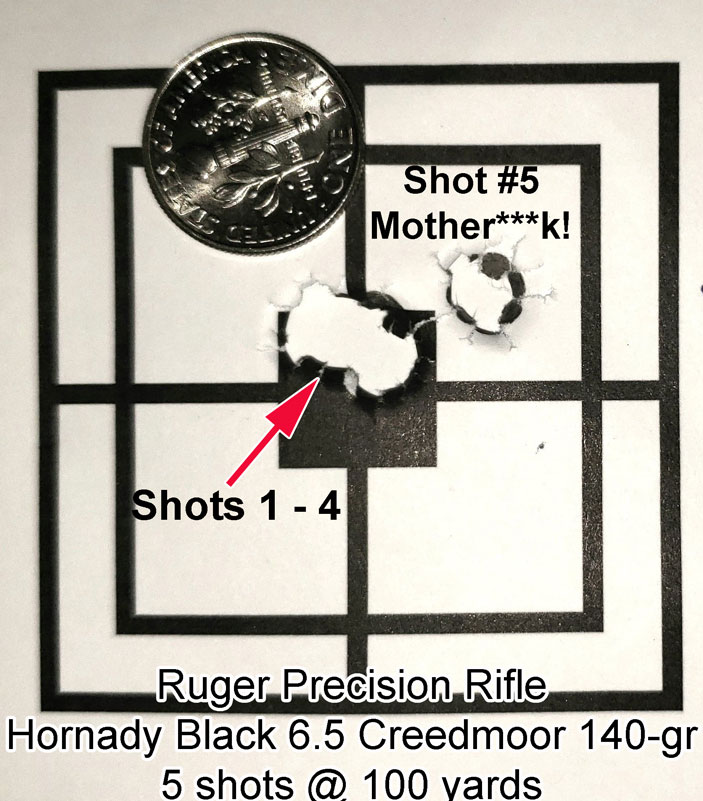

Picked up 600rds of of Hornady American Gunner @$0.75rd because it does this. SD ES under 20
I had some amazing groups with Hornady American Gunner / Hornady Black. And, then... I didn't. It's a real "hit and miss" cartridge for me. More recently, it became more of a "miss" cartridge for me... and more so at longer distances (naturally).
100% my experience. I bought a couple hundred rounds of Hornady Black from Academy when they were moving away from the Black and to American Gunner. I had previous purchased a box and it shot lights out so i thought it was a good investment. I had 3 different lots, 2 of the 3 lots shot great. When I got the American Gunner it shot like the disappointing lot of Black.
Yep... I quit buying it. I'm sticking to Hornady ELD-M or Berger Target Hybrids from this point forward.
Hornady ELD-M and old Prime shot similar for me, made me consider reloading. I was all about to dive into reloading after purchasing some
Copper Creek ammo and seeing what the barrel was capable of. In a last ditch attempt with factory ammo I tried Berger and was pleasantly
Surprised. To date, it is the only factory ammo I will shoot
