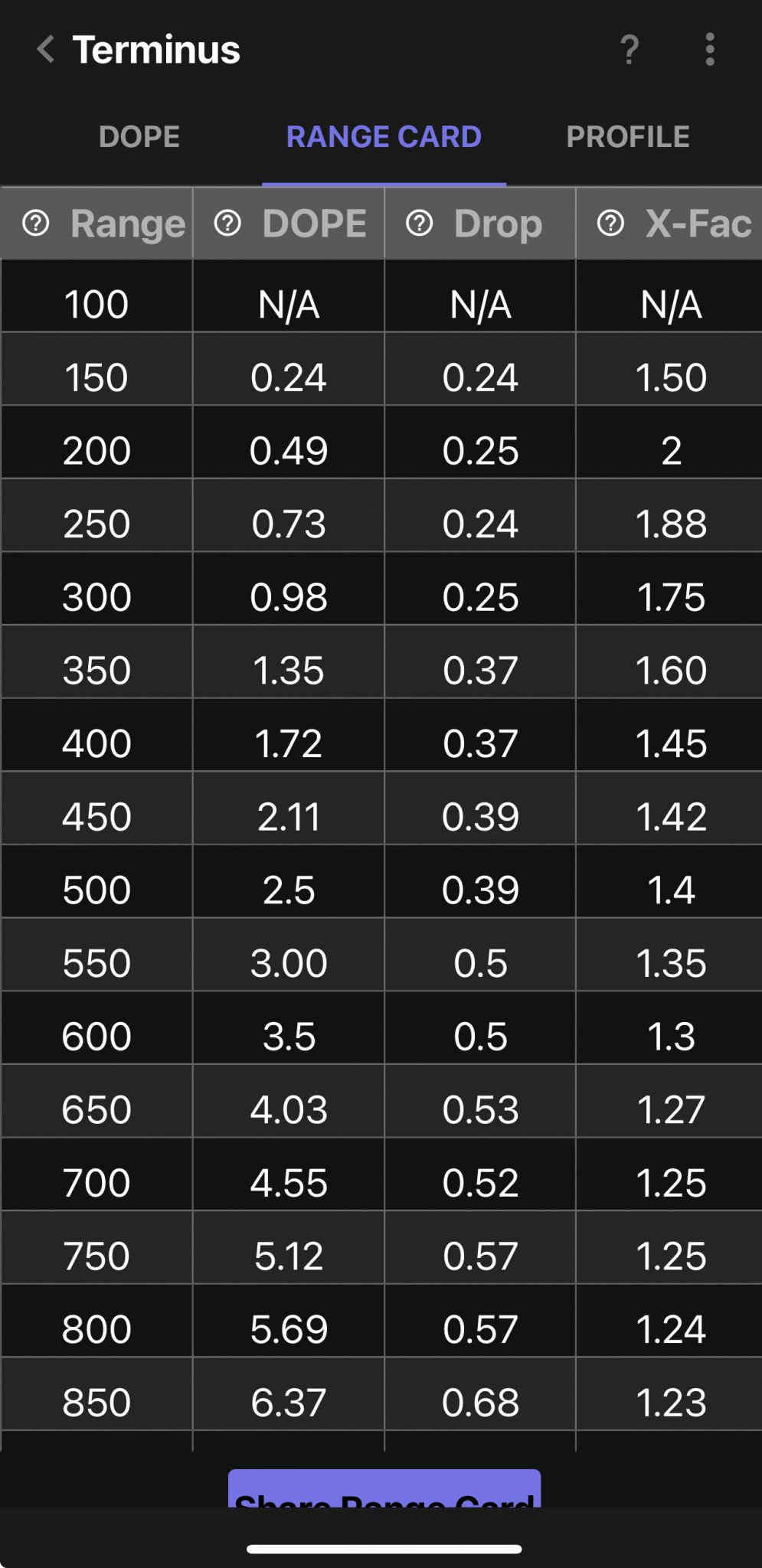

    Is it possible to get the X factor when 'perfect' 100-yard increments aren't available? If a range doesn't have 100/200/300/400/500/600 and instead has 100/255/345/460 etc.
    If you slide over to the Range Card it will show the X-factor in 50 yard increments. If that isn't fine enough you can easily figure out what it should be from what is shown.
    .Yes.
    For instance, if your 255 Yd Data is .6 mil, then your factor to 345 Yds is 2.0 and your factor from 345 to 460 is 1.78, given the example you offered.

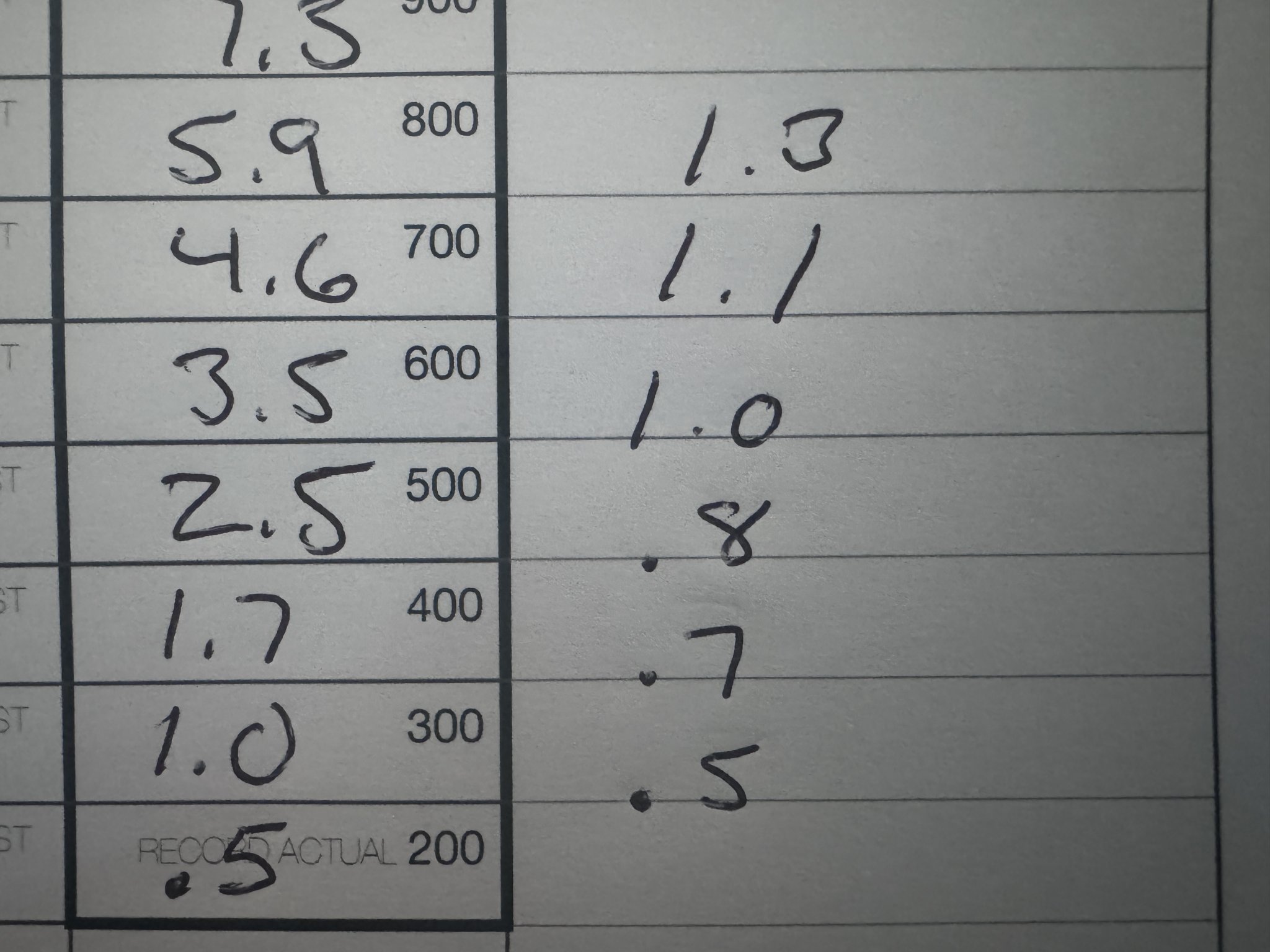

    I like GB. I can fill in the gaps because of field collected dope to know in the example range mentioned based on my previous observations at 25 yard increments so that works for me. The app would be neat as a request for enhancement consideration if it could have a gun mph entry for wind 1 wind 2 on a range card and can we stretch to 1200ish?
    .1 mil = 10 yards, with Gravity Ballistics you can see the gap between so you know .8 between 400 & 500 so you know without having to look at the kestrel
    811= .2 not very hard to understand
    866 add .8 can do it in my head cuz I know what a mil is, gravity ballistics showed me how to understand MY dope and I don’t need the magic box to tell me. Sure I use the box for some situations but I fed it using GB

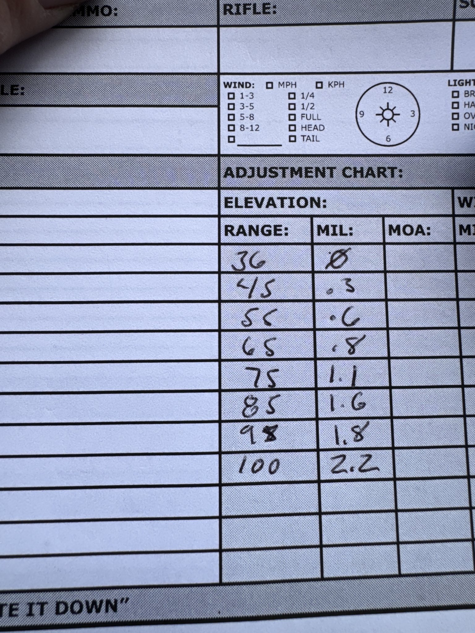

    A separate question, but with respect to long range 22 long rifle, are there multipliers available in 5 yard increments? Or can they be derived?
    Would it be correct to say that this method assists you in interpolating your dial up when you have actual measurements at several points?
    Yes. First step is to be comfortable with and be able to recite your home-range data instinctively.
    That leads to understanding your drop between data points, which makes odd-range data more intuitive and not solver-necessary.
    Yes, easily derived. 20-yard zero, then data every 20 yards to 200, which is the equivalent to 1,000 yards in centerfire.
    The reason I have not codified the multipliers for .22 LR is because a zero range is not universally accepted as it is with the 100-yard zero in centerfire. Some use 20. Some 25. Some 50 yard zeros. Changing the zero range affects the multipliers because it affects the data slightly.

    I know I'm in the minority for using it, but a 35-36 yard zero does the same thing for .22 as 100 does for centerfire. Everything is an up adjustment.
    Is there a way to work this system with a 50 yard zero?
    I’ve just been using that for so long, it’s instinctive.
    Also, it seems to be what you zero at at all the competitions.

    50-yard zero. Make it Precise and accurate
    70-yard data __?__ x 2.28 = 90-yard data.
    90-yard data ___x 1.625 = 110-yard data
    110-yard data ___x1.42 = 130-yard data
    130-yard data ___x1.29 = 150-yard data
    150-yard data ___x1.25 = 170-yard data
    170-yard data ___x1.20 = 190-yard data
    190-yard data ___x1.18 = 210-yard data
    There You go.
